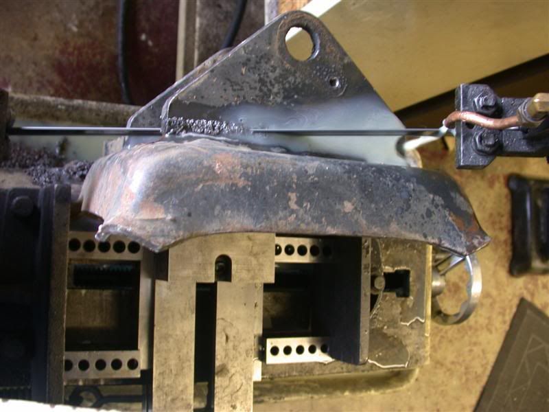

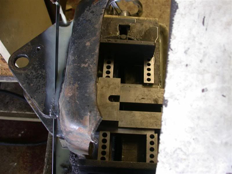

I've been so darn busy I hadn't really thought everything through. I'm just going to put some spacers in between the pivots and the feet and see how that works.
I milled off the feet so they were flat again. (flat feet for more height :confused: )
Then squared up some 3/4" thick plates to use as the spacers. They are 4" tall, but I figure I lost some from the OEM parts when I sawed and milled the feet and pivot parts. Net gain should be about 3-1/2" or so.
That's all for now. I was trying to think up a more elaborate mod like making the feet self-leveling? But this one is pretty straight forward, huh? Better keep it simple for now. Tomorrow, if I have time, I'll mill the pivot parts flat and weld them all together and see what that looks like. Maybe I should drill another pivot location in case I want to move them lower again? What do you think

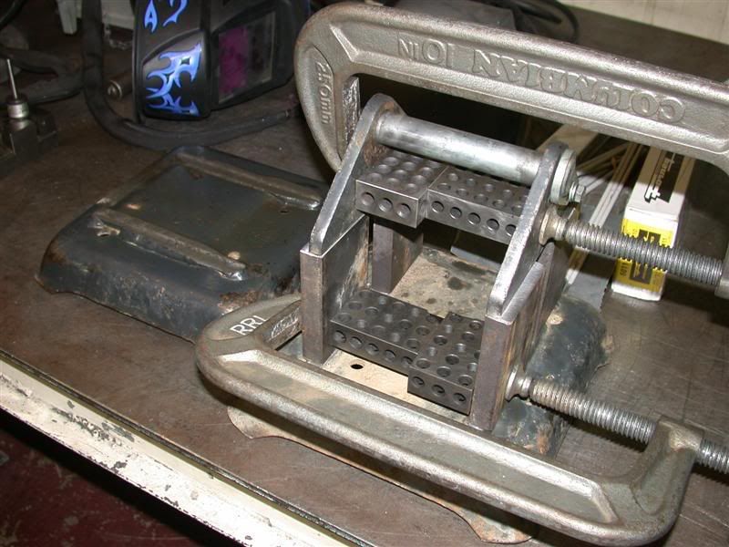

I got a little more done on the feet...
This is what the extensions will look like, giving that added 3-1/2". You can see the difference in thickness between the material I chose and the stock steel. I will add the gussets later after I fixture weld all the plates. If I screw up, I can use my hydraulic press to straighten any crookedness. They are just sitting there but I'm not ready to weld just yet.
I'll add chamfers for welding and do it all later....assuming I have time. I guess I'll HAVE to make time if I ever want to use the backhoe again.:D They are fixtured and clamped pretty good though with all the right clearances and the pin holes all line up.

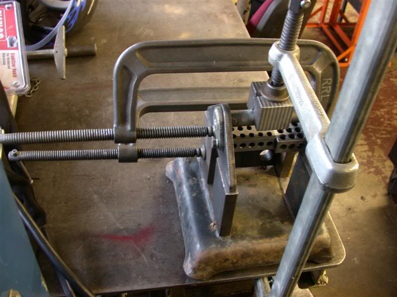

I dragged myself out of bed this morning to look at my rusted backhoe feet project. I decided to weld them up. But first, I had to fixture all the pieces properly to insure
a) Good line up of the existing brackets so the pivot pins go in and out.
b) Good center position of both the existing and new spacers.
c) Good clamping of ALL pieces forcing them together during welding.
Here is the set-up I came up with:
It was a good set up but difficult to tack all the welds due to all the spacers between the loose pieces and all the clamps holding it all together. My intention was to not only tack everything first while clamped, but also run as many beads while fixtured like this.

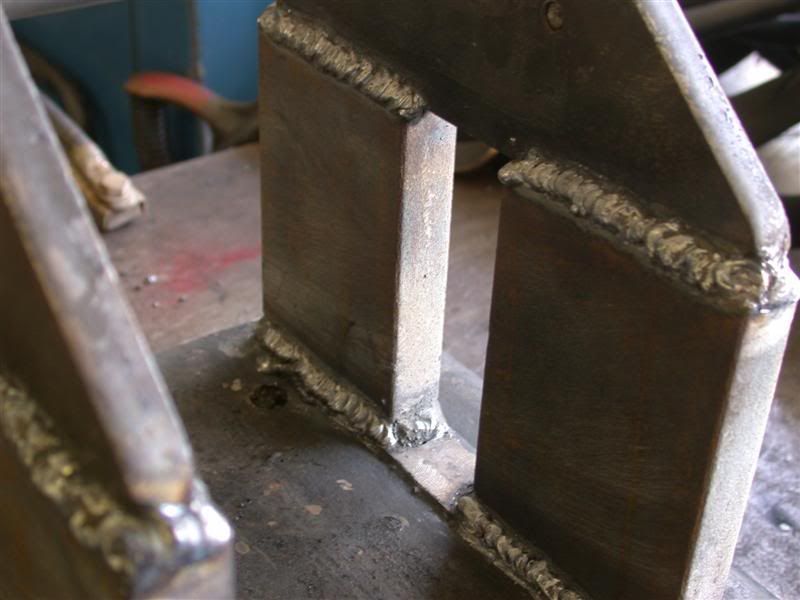

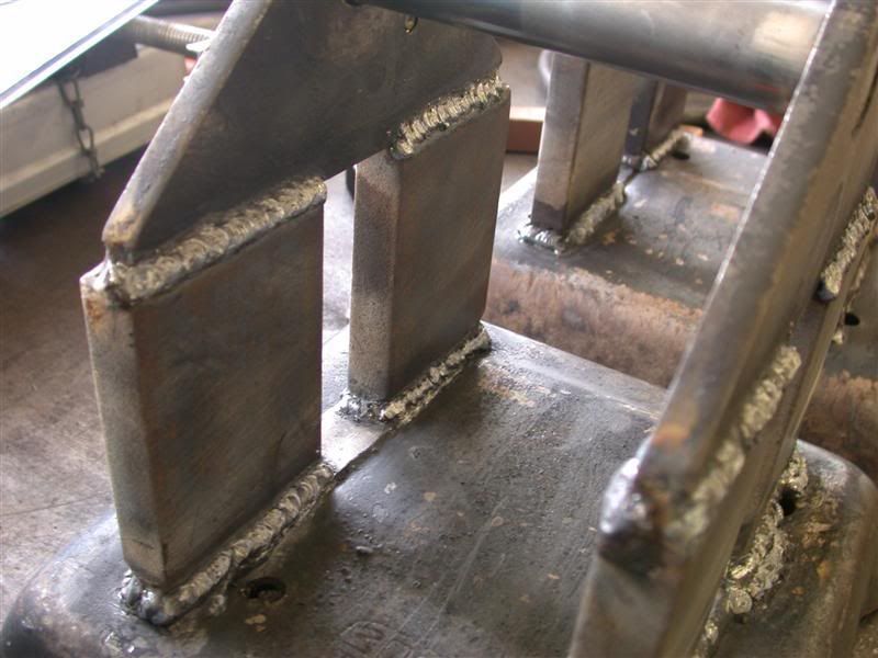

/ Backhoe Feet
Some of the welds came out really good and some I got sloppy on. On one bead, my glasses slid off my nose so my vision was blurred but I kept welding anyway ... duh. ??? The difference in spacer thickness made for a natural ledge to weld to. I don't have one of those fancy MIG welders. These are all from my 30 year old Forney stick welder. I used several passes with Ø1/8 6011 rod at 150 amps for good penetration. I burned through some paint and dirt, but they are solid.
I am still debating on putting in gussets or a spacer bar between the spacers. They are so thick they may not need it? The skinny old 3/8" thick ones did not have any, and my spacers are 3/4" thick. But I will probably add them anyway to insure the spacers don't buckle or fold up sideways. On the other hand, I don't want those feet to become a small bucket full of dirt. Dirt gets lodged between the pivot pin and the top of the feet. When I raise them up and hit home, they kind of "snap" up and toss dirt all over me now. Right now there is a chance for the dirt to fall off first? I'll post more later on what I decide to do.

Looks really good so far. You might be right 'bout gussets leading to buckets o' dirt, but I would still think about some, It wouldn't be fun to see them fold over at the welds while ripping a stump out.

my concern is they are high compresson members and as such any side force is going to want to buckle them (rack... trapazod) them quickly as you have very little to prevent them from just folding over.
in short... id ad some gussets at the bottom to help prevent fold over.

I really wrestled with the gusset idea and decided to leave them off. The 3/4" thick risers are sitting an a flat milled surface and I clamped them up tight before welding them. I'm gonna try it like it is. LOL ... If they fold over, I won't tell you guys.:D

I got my feet back on the backhoe and this is how they look.
You can see where the cylinder attaches and lengthening the legs themselves would require longer cylinders. The ones I have would bottom out before the feet hit the ground and then they couldn't retract fully anymore.
I haven't tried them out yet, but I am more confident that they won't fold over. That 3/4" bar stock is pretty hefty and the fit over the stabilizer legs helps too.
