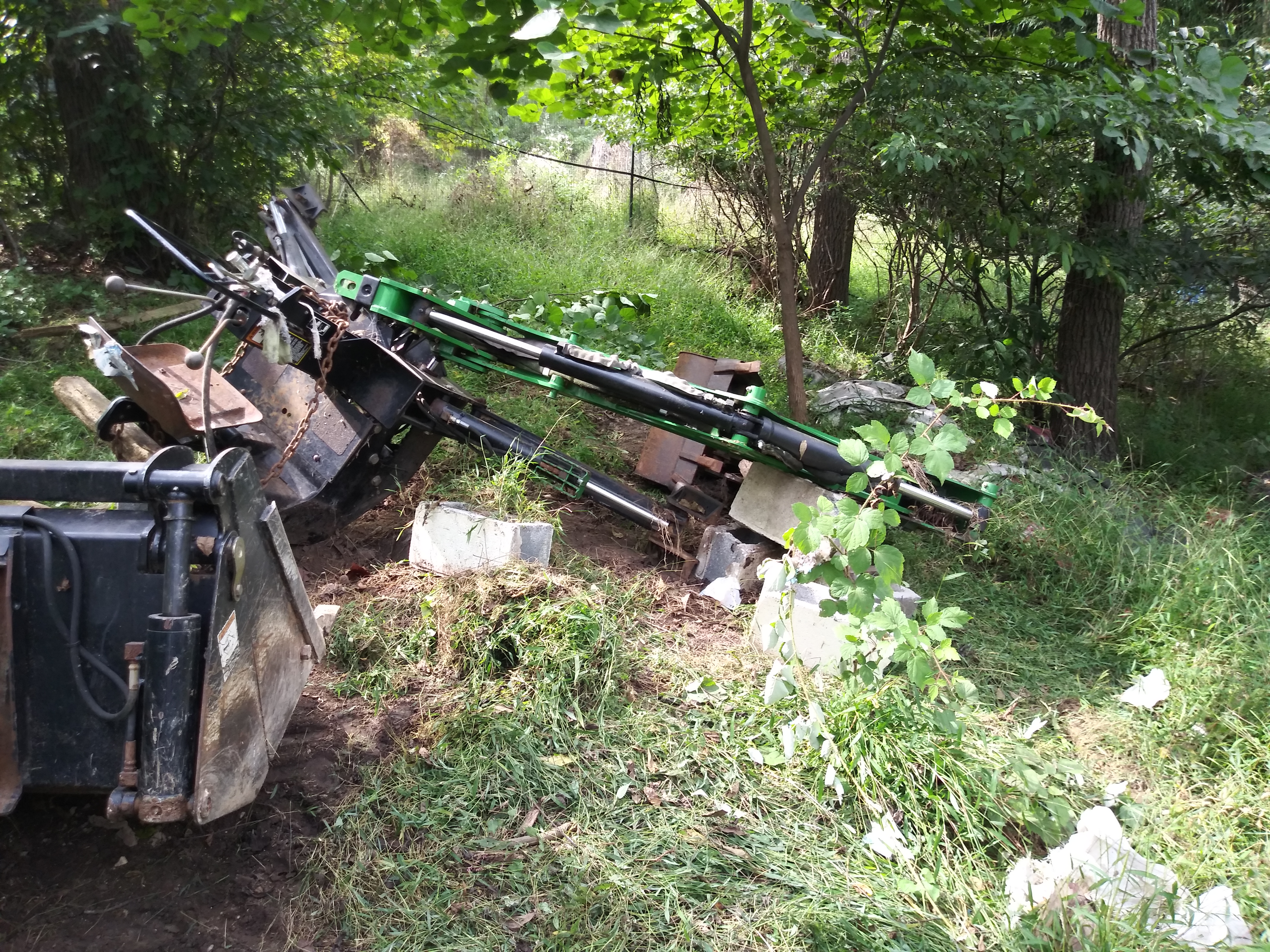

It sounds like either you are getting nothing out of the power beyond circuit, OR, if you are, something on the hoe is letting it all bypass right back to the tractor.
As someone else mentioned, can you pull the loop of hose and hear anything change in the tractor's sound? That would indicate that it's dead headed with pressure and would indicate that there's flow available.
   / Backhoe fell over and died. #22
Another way, I guess, would be to measure the temperature of the loop of hose when the machine is cold, run it for 10 minutes, and measure the temp of the hose again. If it's significantly warmer, you know there's fluid going through it.
   / Backhoe fell over and died. #23
When you don't have the hoe on does the loader work correctly?
Is your setup one of the ones that you have to connect a bypass loop when you do not have the hoe on?
When you attempted to connect to the hoses was your loader still functional?
I am assuming that the two hoses you hooked up to from the hoe did not go to the same fittings as your bypass line does.
Do you have a pressure feed at the rear of your tractor?

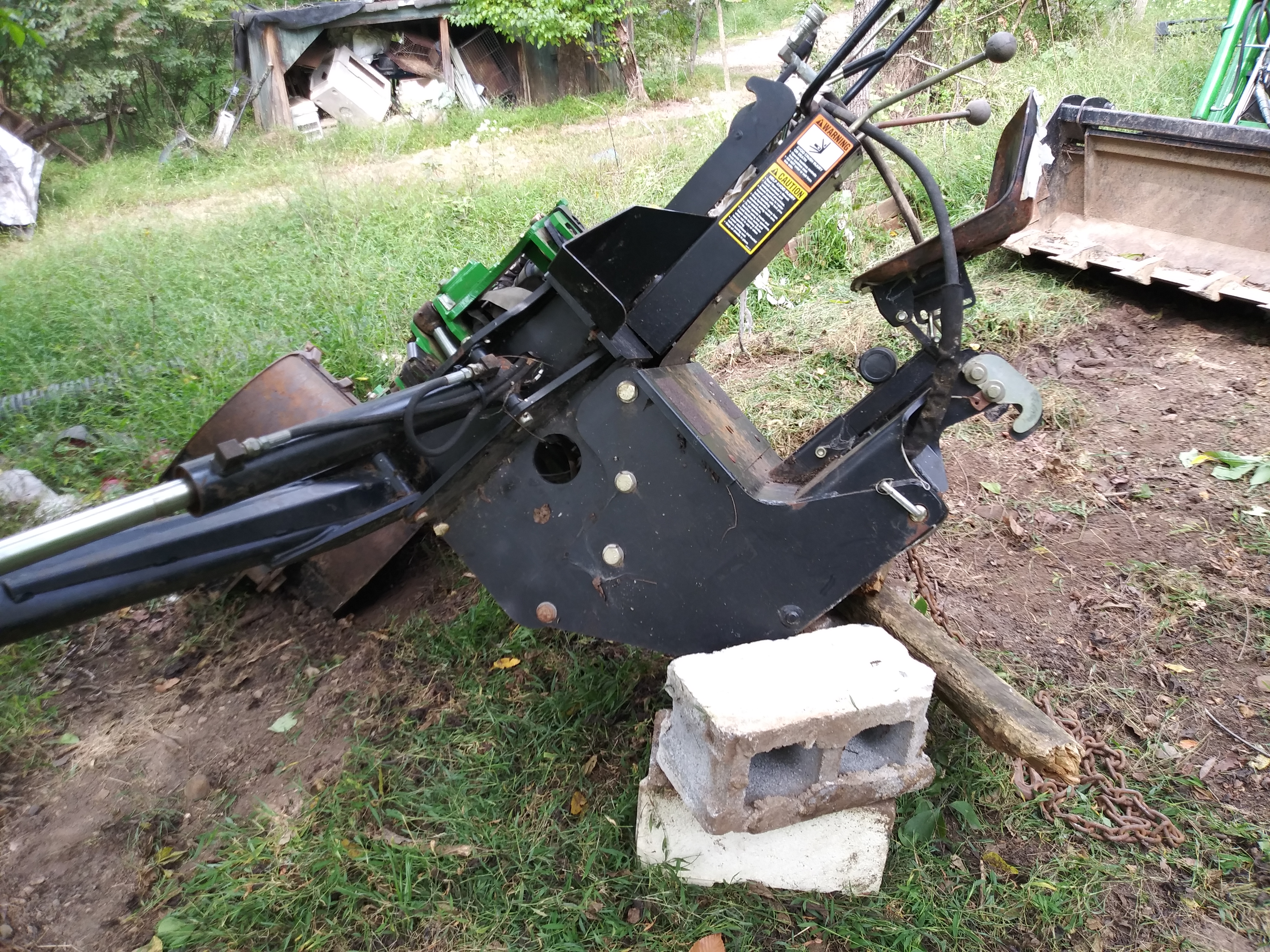

It looks like the boom is fully swung to the side. Probably settled that way when it fell over. I don’t know enough about hydraulics to know if that is creating a problem. I know if I take my loader off in the sun it gets pressure in the lines and makes it hard to hook up. Are the lines for the back hoe hooking up ok? Are they feeling like they hooked up but aren’t connected well?
   / Backhoe fell over and died. #25
My swing cylinder is not very strong and will not push much dirt sideways when trying to fill a ditch or hole. OP's may not be strong enough to swing the boom from that position, but he should be getting some indication of it trying. Outriggers and curl should also be trying to do something.

At last resort can make a tripod over back-hoe to get it up right.
   / Backhoe fell over and died. #28
I would say that if 3pt is working and remote valves are working, you are getting flow through the power beyond. I also suggest getting someone to help you with standing the hoe back up. An extra set of hands and eyes will go a long way. Just be careful.
   / Backhoe fell over and died. #29
Hook on to the bucket and pull the boom straight. Then get some blocks and a hydraulic jack and start the slow process of getting it upright.
The tripod and chain fall will be the easiest and fastest way.
Forget the temporary hydraulic hookup and just work on getting the hoe upright.

Attach a tractor tie down chain (min 12' length) to the loader bucket, keep it short to moderate in length, and wrap it around the backhoe, and lift the backhoe into position for the mounting on the blocks. Your loader can handle the weight. Put some implement on the rear as counter ballast. This could take an entire day to get it repositioned, then once in proper position, I suspect your BH hydraulics will be just fine and operational.
   / Backhoe fell over and died. #34
Tripod support works well on uneven terrain. Proper sized tree trunks work well for tripods.
A gin pole arrangement with chain fall would also work. It would be quite easy to set up with a tractor with no major heavy lifting involved.Then a third leg could be added with the chain fall or just use the gin pole.
#35

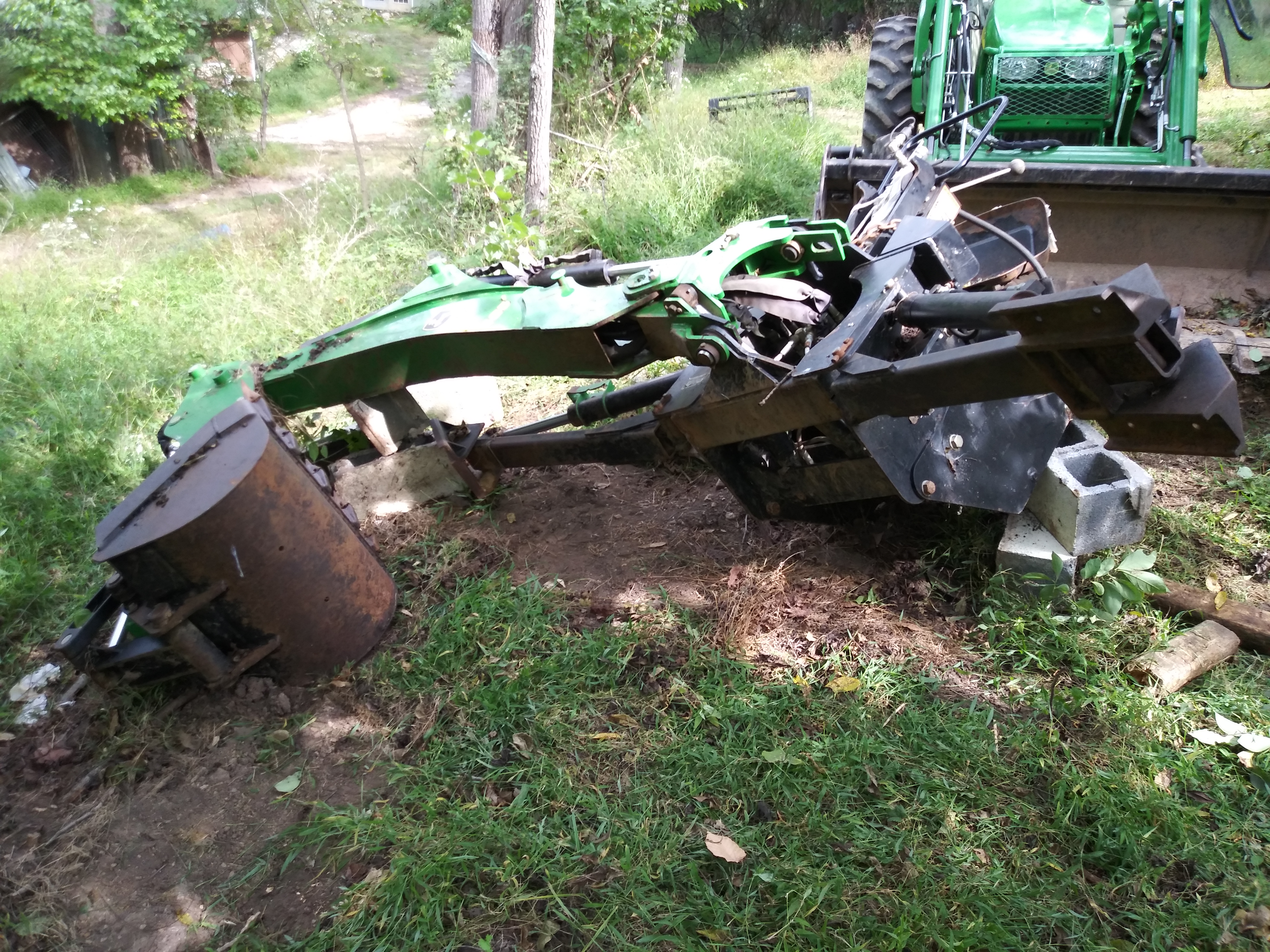

That was pretty much my first attempt, placing cinder blocks and timbers underneath while going along until the tractor started tipping; at this point I decided that hydraulics were going to be more controllable than gravity (working alone). It's looking like I'm going to have to bite the bullet and replace the 3 point linkages (heavy and not fun anymore), mount the brushhog with a lot of cinder blocks on deck, and take my time, using some well positioned ropes and metal t-posts, to keep it from tipping over to it's other side.

Pix of the hookup
#40
Pix of the hookup
The fully extended swing piston shows the only evidence of rust/corrosion as asked about above.20201010_104049.jpg20201010_104029.jpg20201010_104244.jpg
