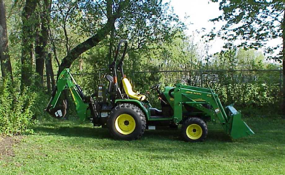

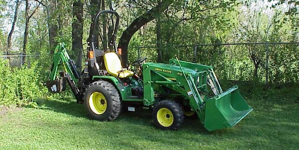

   / Backhoe for 4110 #14
Here's a picture
Cliff
   / Backhoe for 4110 #16
I was looking into buying one, but I found out that the submount frame gets in the way of the mid mount deck linkages and it would be a major job to change out the mowing deck and the backhoe. Instead I purchased a mini excavator for addition 3000 dollars. If you do not have a mid mounted mower it looks like a well made backhoe.
   / Backhoe for 4110 #17
The downsides of the 46BH:
It takes about 10 minutes to get the whole subframe and hoe off. I don't use this tractor with a MMM, but I still have to remove it for attaching other 3pt equipment. You need to remove the 3pt arms to put on the hoe. When stored, the hoe and subframe take up a good bit of space.
Yet, the subframe is a great addition and stiffens the frame. I jerk the tractor around with the hoe quite a bit, but the subframe allows me to do that without concern.

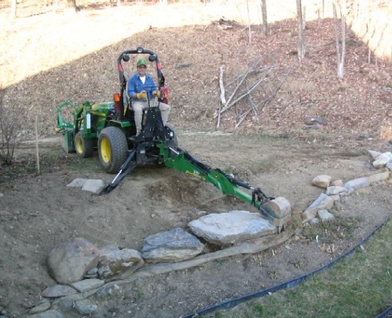

   / Backhoe for 4110 #18
aemiller,
For a pond? jrwattjr may have the right idea of a mini-excavator (depending on pond size, as Cliff says). The mid-mount mower issue is why my dealer steered me away from a MMM and toward a finish mower. Still have to remove the TPH links but better than dealing with the MMM.
For digging holes, rocks, stumps..., transplanting (carefully), I am pretty impressed with what the "46" will do off my 4115. As Cliff says, it can move a CUT around a bit (...CLIFF, that's putting it lightly /forums/images/graemlins/shocked.gif, it'll pick the whole CUT up off the ground and pull it right out of the rut I've buried myself in....slowly and safely, ofcourse /forums/images/graemlins/smirk.gif).
Since Cliff's pictures are so pretty (must be much more dilligent in washing off the tractor after working than I am), I've added a couple of pic.'s of another chore the 46 will do, without breaking a sweat (or hydraulic line).
Tom
P.S. (the FEL would not lift this stone over the rise that is on the left and steeper than it appears)
   / Backhoe for 4110 #19
Wouldn't pick the "stone" completely off the ground but had no problem lifting it enough to drag it to where I wanted it.
Tom
   / Backhoe for 4110 #20
Fine tuning the placement with the "46"
BTW: Sorry, no pic's of all the stumps I've pulled and can't seem to locate a whole slew of pic's of even larger "stones" I've "re-aligned", if not been able to lift completely.
Tom
