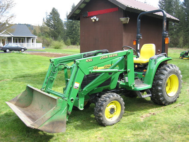

Any recommendations or warnings? thanks a lot Dave

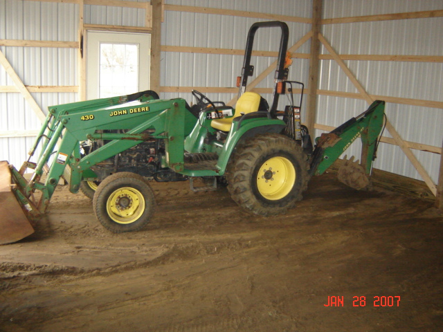

My heap 4400 came with a 47. I can't imagine another brand BH that would mount & dismount with the ease of the JD piece. I can have mine on or off in, literally, less than 3 minutes!
