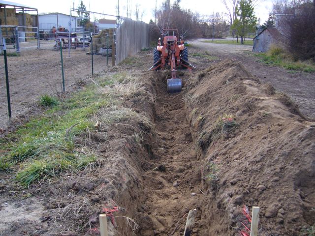

I took the hoe off before I saw your pic request. I looked around but do not have any close-ups of the hoe mounted on the tractor. I have attached a few pics of the last time I used it. One of my projects in putting in a row of grapes along the fence line with the neighbors to form a hedge in the summer.
I had ripped out some small trees, bushes etc. and then dug out a shallow trench so that I could mix in some soil amendments where the grapes are going to be planted (old horse manure, compost etc.) Part of it was also to explore where the previous owner ran irrigation lines out the pump house seen on the right. There is a large pond further to the 'right' of the pump house and the large bush.

You'll note that I do not have a ROPS. I am not so sure that one will fit due to the fact that when you spin the seat around and face backwards to use the hoe I think it would be right where your legs go. I should probably back up to the hoe and take some pics of the operators platform and get opinions on that.
I will for sure grab some pics of what the hoe looks like off the tractor and what the rear looks like when you have it stripped down to mount the hoe.
Charles

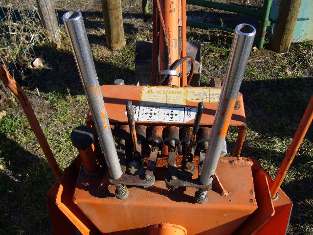

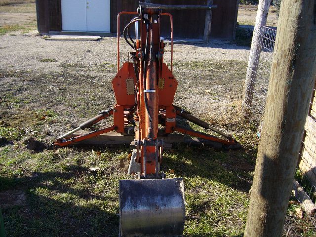

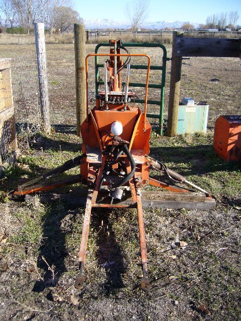

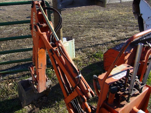

Here are a couple of pics of the hoe by itself.
In the first pic you can see the rails that come forward and bolt on to the FEL subframe. The 'v' shaped area with the filter on it is the hydraulic reservoir with platforms for your feet on either side. Down where the PTO pump is resting you can see a round cross-bar. This is probably the biggest downside to the design, every time you change over to/from the hoe there are brackets that you bolt/remove on the rear differentatial. Slows things down and the previous owner was nice enough to strip out one of three bolts on each side. A heli-coil kit is on my shopping list ;) You also have to pull off the hitch and all the three point parts. My tires appear to be flipped 'inside out' so that the shallow part of the rim offset is on the inboard side, probably to increase the stance for more stability with the hoe. This means every time I take the bar for the liftarms out I have to take off one of the rear tires.
The rest are just different shots/angles. I believe this hoe was purchased brand new back when with the tractor. Many of the hyd lines have the outer jacket coming off but otherwise look in good shape. Almost all of the cylinders leak a little fluid. Only real problem I have with it is the swing seems weak. There is a bit of a kink in the suction line going to the pump when mounted or it could mean repack. In the spring I am going to cut a bit off this hose and see if that helps take the kink out.
