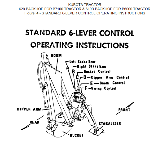

This weekend I picked up an old backhoe for a really good price (like the price I could probably scrap it out for). The major things to contend with are the lack of bucket and parts of the outriggers are missing. It is a Brantly 330 MT. I have found similar looking BH on this site, but I cannot find anything on the model 330 MT. I am pretty sure it is the same thing as what was sold for Kubota B7100 and B6000 (629 and 619). Mine looks just like the one in this picture, including the outriggers that go straight out at an angle vs articulating.

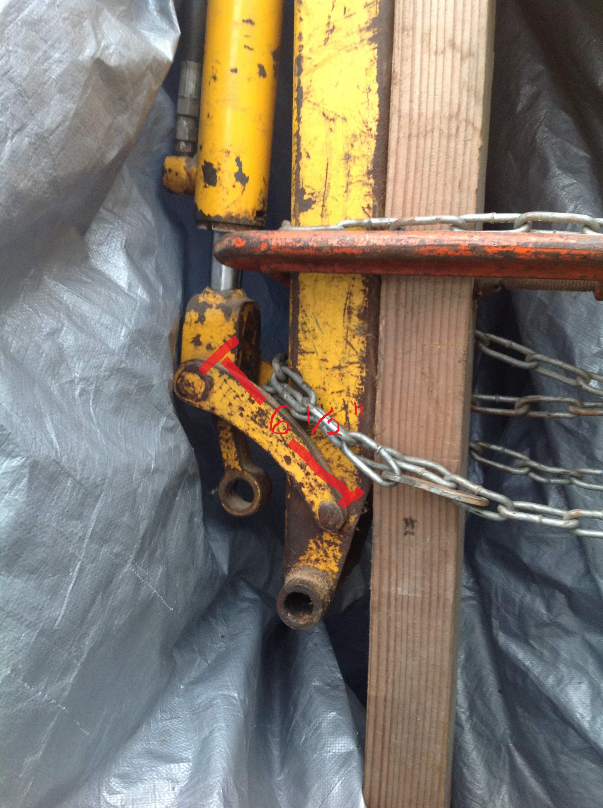

The next picture shows the end of the dipper, with a distance of 6.5" between the two pins labelled. Not sure of the name, but the holes for pins where the bucket attaches are both 1" diameter and widths are as follows...the one on the left (not fixed), is only 1" wide (but as you can see from the picture of the green BH above, there were spacers installed to bring it to the same width as the fixed hole/pin. The one on the right is 5" wide. I really need to have some measurements for the bucket so I can fab a bucket (as I highly doubt I will find a bucket). I assume the most important measurement would be the distance between the two 1" holes on the bucket (I assume they are the same distance of 6.5" in order to form a parallelogram, but I would hate to assume something so important) - the more measurements the merrier.
