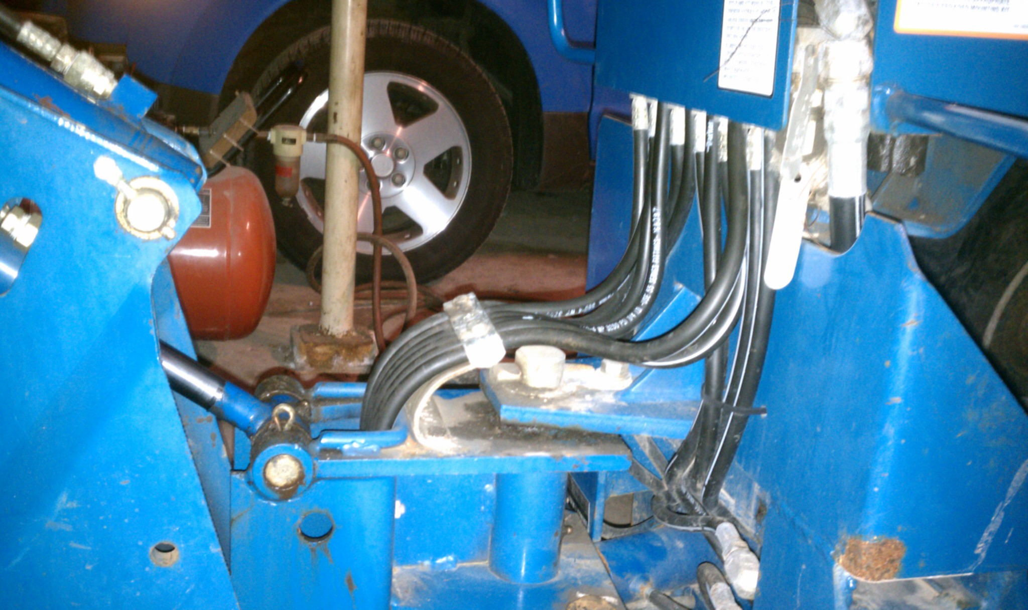

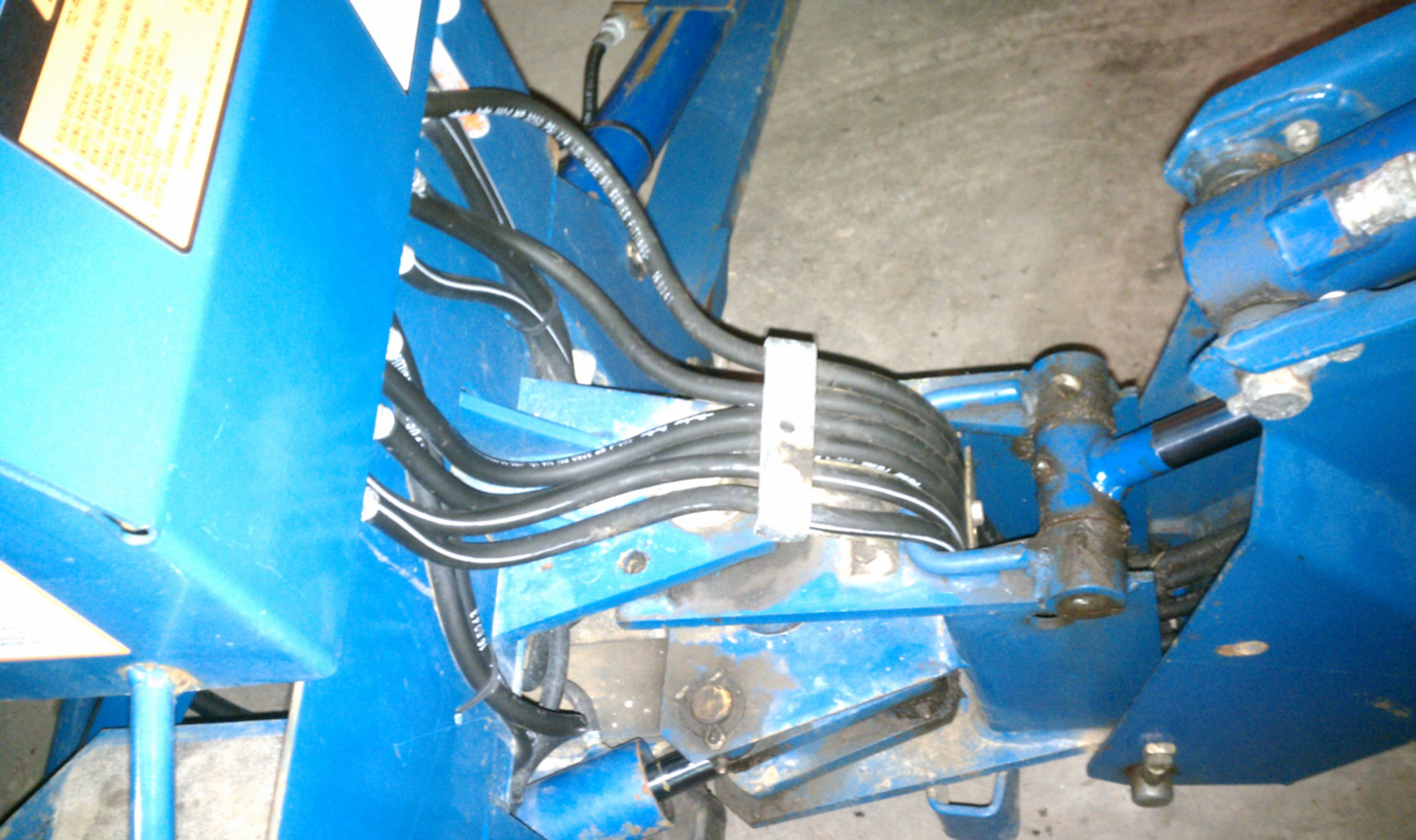

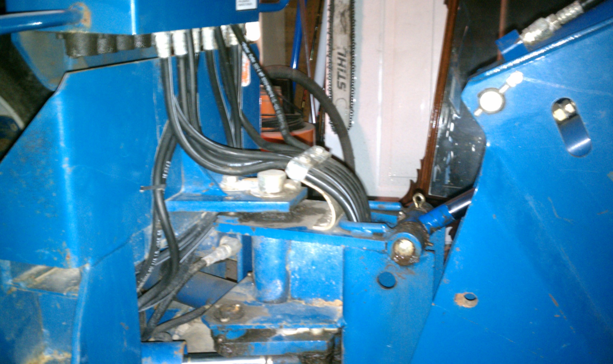

Well, as long as everyone is checking out this thread, I will post my question here.
I have a 757B backhoe that I bought in December. It had been sitting at least 3 years, in a clean, dry garage. I just put it on to start playing with it, and noticed some seepage from some of the cylinder seals. I know a little is probably normal, but how much is too much? It will sometimes leave a visible line on the shafts if I change direction mid cycle. On the dipperstick(elbow?) cylinder, the one that you can see the easiest from the controls, will have a visible buildup after about 3 dozen complete cycles. I never really noticed this on my front loader. Would you actually want a little seepage to help keep the shafts clean when digging?
Thanks in advance, and to keep with the spirit of this thread, here is a couple shots of my hose routing if it helps anyone. Mine is a 757B though.

The 757B looks a bit easier to route the lines through than the 758C.
Just my opinion on the leak but if you can tolerate a leak do it, but myself, I'd start thinking of repairing it. First though, try some of the Lucas hydraulic oil conditioner with anti-leak. It may or may not help. I bought some for mine to avoid splitting the thing but I can't say yet if it works or not since I haven't put it in yet :)
And the seepage will actually have the opposite effect and attract dirt around the leak point.
Jumping around here but your seals most likely just dried out some and may come back to life with a little help and or use. Anyone else have a thought about that?
On a side note, picked up my new lines only to find out they put the 5 JIC fitting on instead of the 6 JIC! They have them back and are correcting that. Go figure. :) May have been my fault there though....
