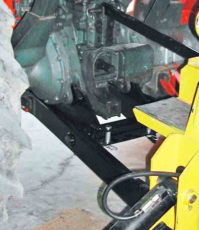

Jay, here is a photo of the rear of a Kubota with a Woods old-style hoe
mount. I call this a "ladder-type" mount. Tho this is for the Woods 7500,
it sounds like this is the kind of subframe you have for the 9000.
You brought up several concerns. First, this subframe does indeed make
use of the 3-pt lower arm pivots, but the rear bracket is also bolted to
the existing holes in the rear axle housings. No way does all the weight
hang off those pivots and there is no rotation about those pivots. Straight
downward forces on those pivot holes is not the biggest problem with
3-pt hitch mounts anyway.
Second, the toplink adds stiffness to the whole mount, and the lower
part of the subframe and hoe connection is NOT free to pivot as with
a 3-pt mount. In the latter, huge tension forces are placed on the
toplink as the massive weight of the hoe tries to pivot about the axis
of the rear axles.
That force (torque about the rear axle axis) tries to lift up the front of the
tractor, placing huge bending forces about the center area (bell housing).
Adding a beam to offset this bending moment is what the long forward
part of the subframe does. The forward attachment of the subframe does
not have to be very big or strong since the moment arm is so long.
I also have a photo of your hoe (BH9000) on an L4830 that uses the later
Woods "4-point" subframe, a much better design, IMO. The old subframe
is still way, way, way superior to the 3-pt hitch connection, IMO. I
understand that Woods may only offer the older style subframe for your
L4200.

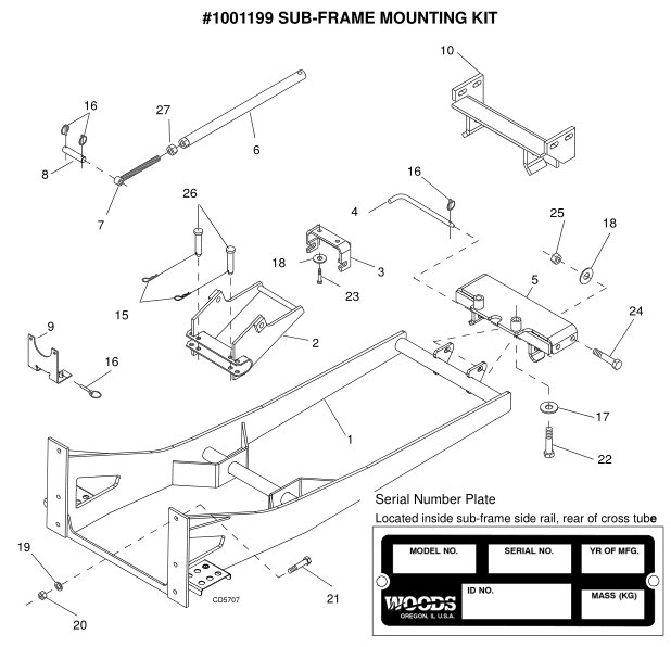

Here are the two different subframe styles in the above discussion. The ladder (older) style and 4pt (newer) style here are drawing taken from woods subframe manuals.
