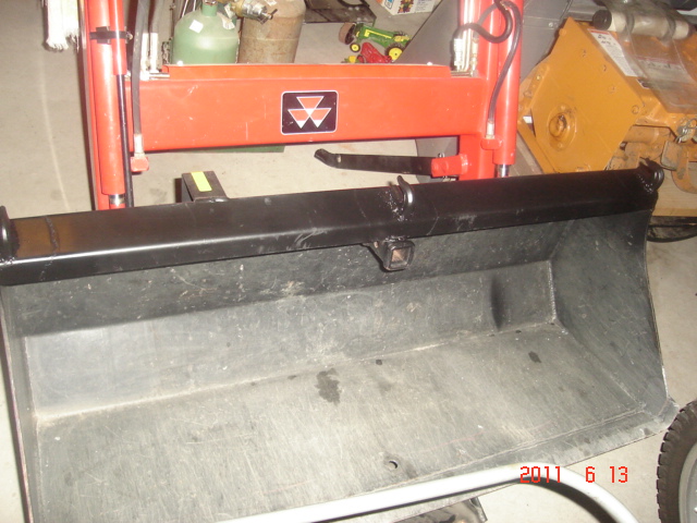

Exactly as Gary said: Nope, don't have a problem with the hitch inside the bucket. Thought I might, but it's really a non-issue. Only time it gets in the way is when I'm using the FEL to transport loads of firewood from the main pile to the cellar bulkhead doors to bring inside for the winter. Yes, once in a while it will get dirt/mud in it, but it's very easy to clean out afterward.
And yes, the height IS important. Any higher, and its utility would be impeded. As it is, I use a drop-down hitch to lower it a bit more. Actually, you can see in the pic below the hole I drilled in the lower front edge of the FEL; I use that when I really need the hitch ball low-- just screw one in right there -- but only for lighter loads!
Here are the welded-on FEL chain hooks. I put three on, but really use only the center one most of the time. Another very handy addition.
