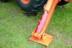

Since we're talking about hoes, outriggers and stability, this may be as good place to ask as any.
My outrigger feet are completely flat and smooth. This has so far allowed some sliding on grass and softer ground regardless of the amount of down pressure. I was looking for some sort of gripper teeth or claws to attach using the through holes in those plates, but so far I haven't found any. That got me wondering about just using a 2 inch or so bolt through each of the holes. That would give me 8 spikes or studs in each one to penetrate the ground.
Thoughts?
   / Backhoe operation - tractor tires off the ground, only the rear, only the front, NONE #9
Use C channel making a square pad with vertical edges at two sides.
Seen this on others like this one
