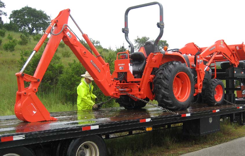

FWIW This is how my GL3240 was delivered. When this picture was taken we had already removed the chain which held down the back-hoe bucket.
