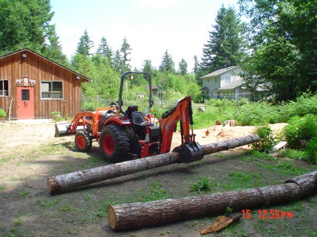

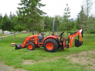

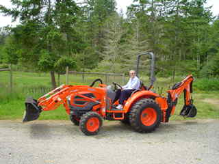

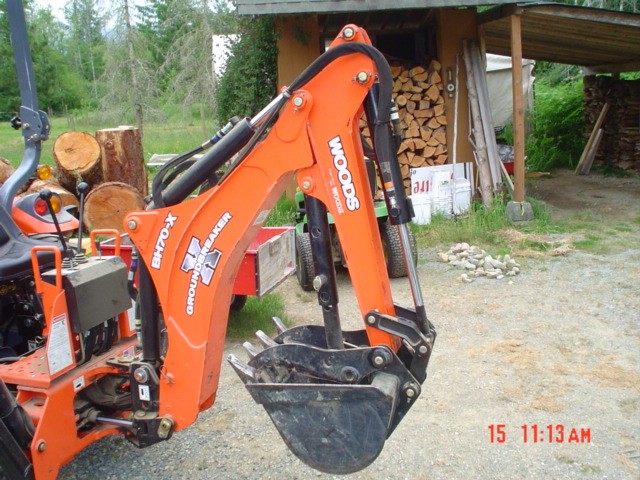

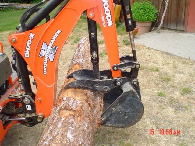

I just took some pictures of my Woods backhoe. The reason I got the Woods was because it has a great seven position thumb. Don't have many rocks but lots of trees. The thumb is great, when splitting firewood rounds I use the backhoe to put them on my wood splitter. Much easier on my back.

I'm a big fan of thumbs and have had on both of my backhoes (both manual, never needed or wanted for hydraulic). Super useful implement, I use for cutting logs and stacking and moving rocks.

1) I have had both Kioti and Woods backhoes. Similar minor leakdown overnight/over week on both. No noticable difference.
2) I used my BH thumb this weekend to move some logs around in preparation for sawing to cord wood lengths. Very useful as I could reach further than with my grapple. However, given the cost of the thumb, I'd go for a grapple for the FEL first and only then add a thumb. No comparison in the number of jobs that the grapple makes possible compared to the thumb.
