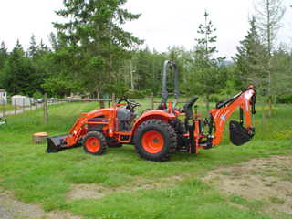

The kit puts what would otherwise connect to the rear remote marked 'B' into the reservoir directly via and adapter that moves the overflow's 'Shepard's crook' to the other side near the remotes, and allows the 'b' return line to connect into the reservoir fill location on the right, as viewed from the back of the tractor.
Does that answer your question?
If not let me know and I will detail it further....
I do not quite understand your explanation and I have a CK, not a DK.
Are you saying that your return is connected to your hyd oil fill port?
I have used this location on Kubotas before....I thought Kioti might have
something more elegant....
(ISLAND: COYOTE is using only one of the 2 work ports on his AUX valve
for power, and avoiding the restriction of using the other work port for
low pressure return to the reservoir.)

The adapter kit allows the return line to quick connect directly into the fitting that comes with the kit, so the reservoir fill port is blocked by the adapter. The quick connect male end which screws into the reservoir needs to be removed from the reservoir to fill the fluid- if needed.
Hope that is a clearer explanation?!

If you get a chance, pls post a photo of the new return line connections.

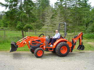

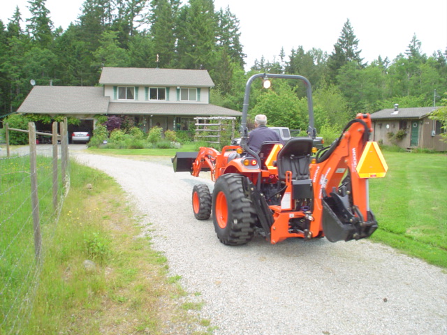

Here are the pics! Hope they help explain how things are attached with the kit. Seems the return line QC is male and the original output line attached to rear port 'A' is female. The kit bolts where the reservoir fill is usually and replaces it with the QC for the return line. To fill the reservoir one has to disconnect the return line, unscrew the fitting and then pour fluid into the 'neck' that is bolted to the side of the reservoir.
