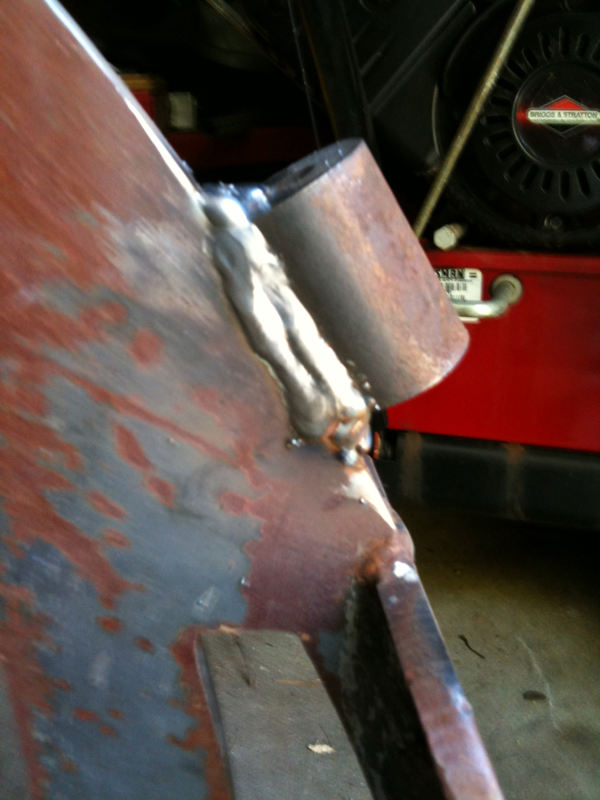

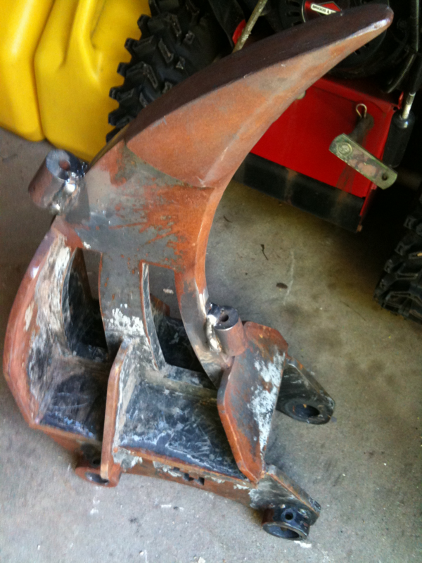

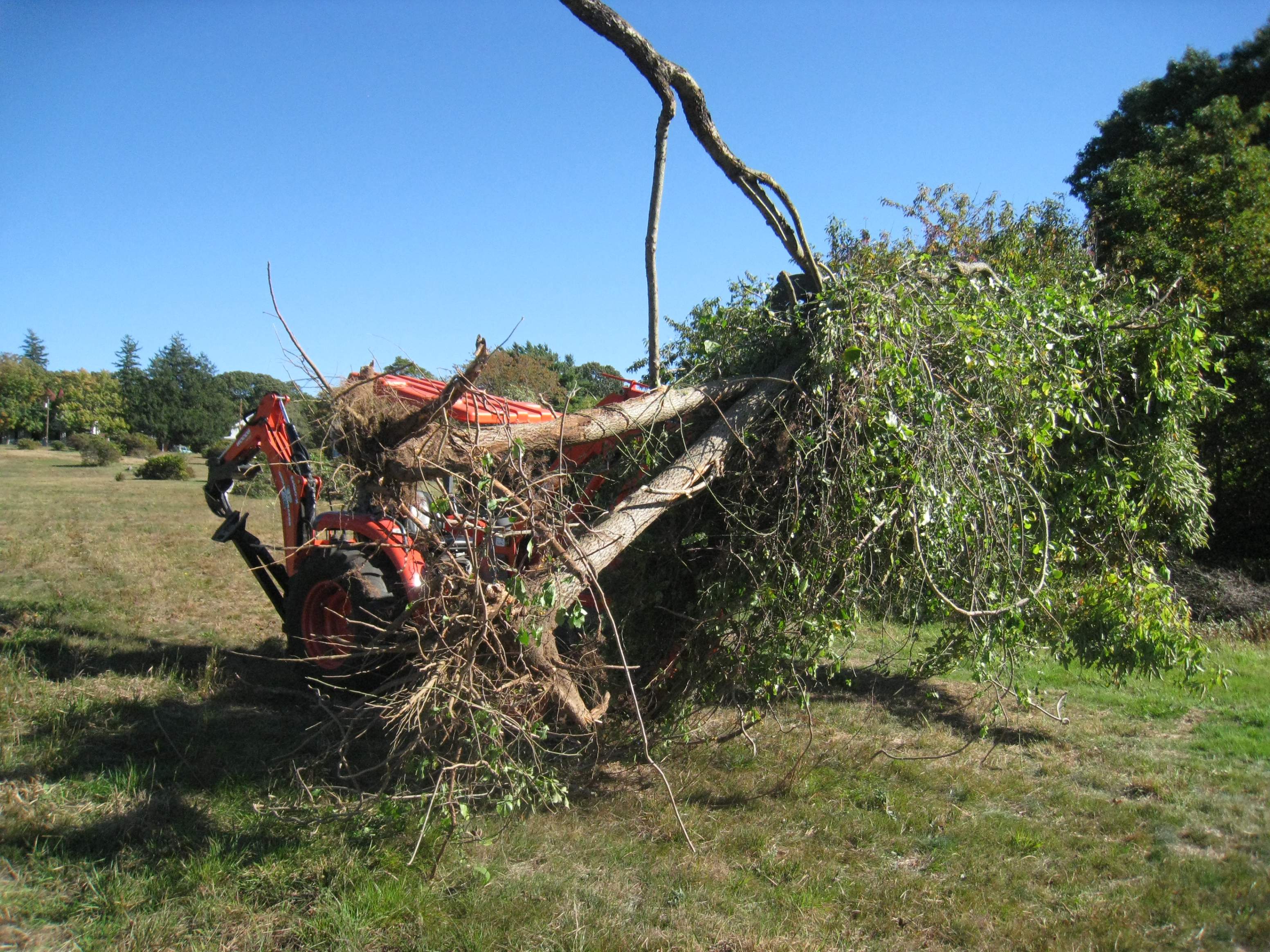

The benefit of a ripper versus bucket is obviously that you concentrate force in a small area. I don't see how a ripper would be any more likely than a bucket to stress a BH. Indeed, as you are more likely to tear through a root than get the bucket stuck, it seems a ripper would be easier on the BH. Obviously technique is important but so long as you learn to select the right size root to "muscle", then the ripper should hang up only momentarily before tearing the root. Sometimes the root is too big and needs to be nibbled. When roots are too big the ripper tends to curl the root up. If the ripper has teeth on the cutting edge, those teeth will gouge the root and weaken it. I didn't have teeth cut into my ripper but I did weld on a sharp piece of drilling rod to both front and back of the ripper and these serve the same purpose. The tear out approximately an inch of the root if the root moves against the drilling rod while curling in front or extending along the back of the ripper.
I'd think that teeth would probably work a bit better but the drilling rod does improve the performance of the ripper. Photo shows the new ripper and then the modifications (before repainting). If it did it again, I'd move the front drill rod up about 3-4 inches into the belly of the curve so it will catch the root earlier in the curl.

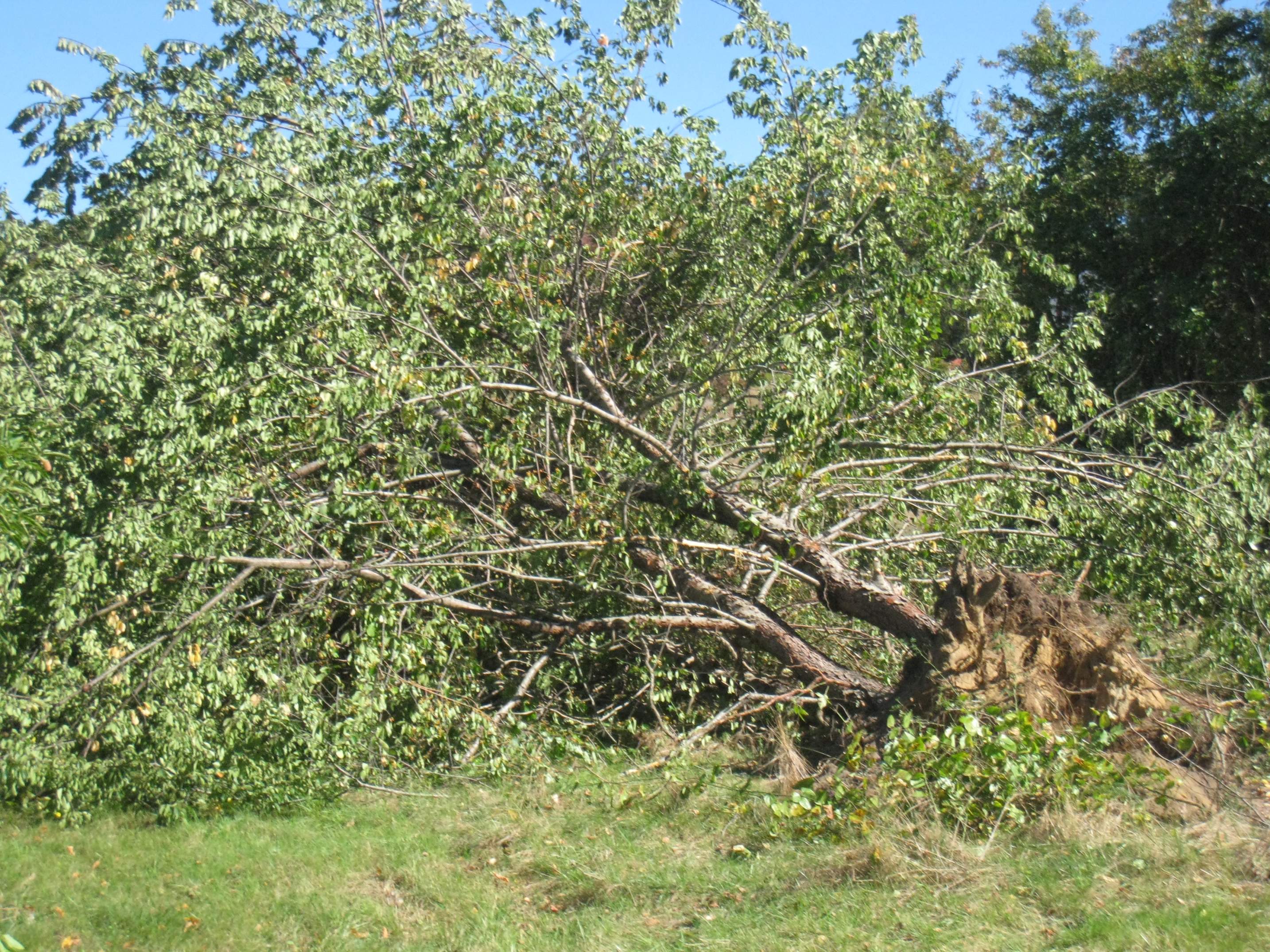

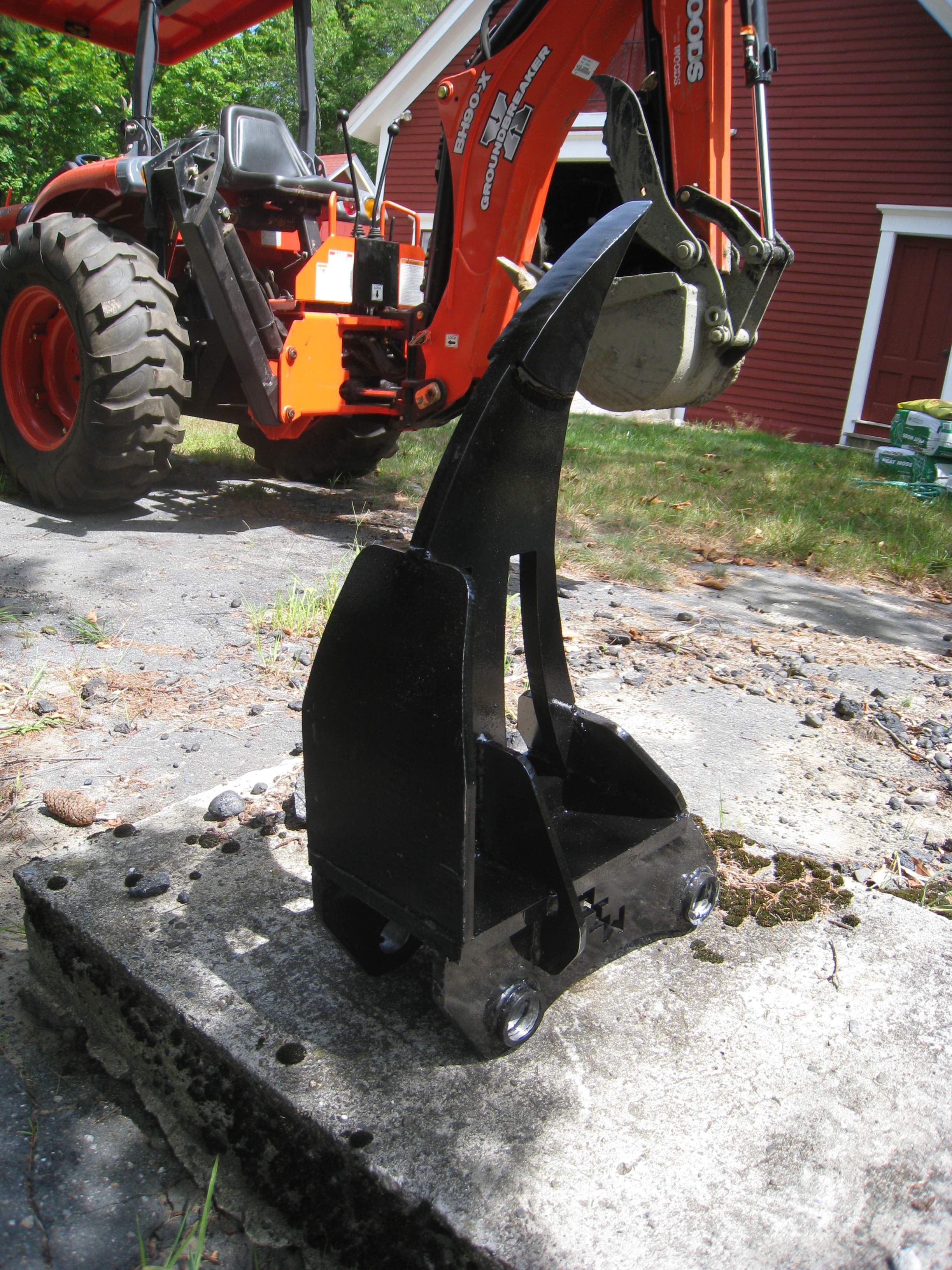

Yes, the real benefit of a ripper is that it allows you to cause less damage to turf and create a smaller hole in the ground. That means it is also a faster process of course. I found that when taking out trees less than about 30 ft, maybe 40 ft, tall that ripping roots and pushing the tree over would leave only a small divot in the ground. Something that I could pretty much fill in by turning the tractor around and using a 4n1 bucket to smooth it all over.

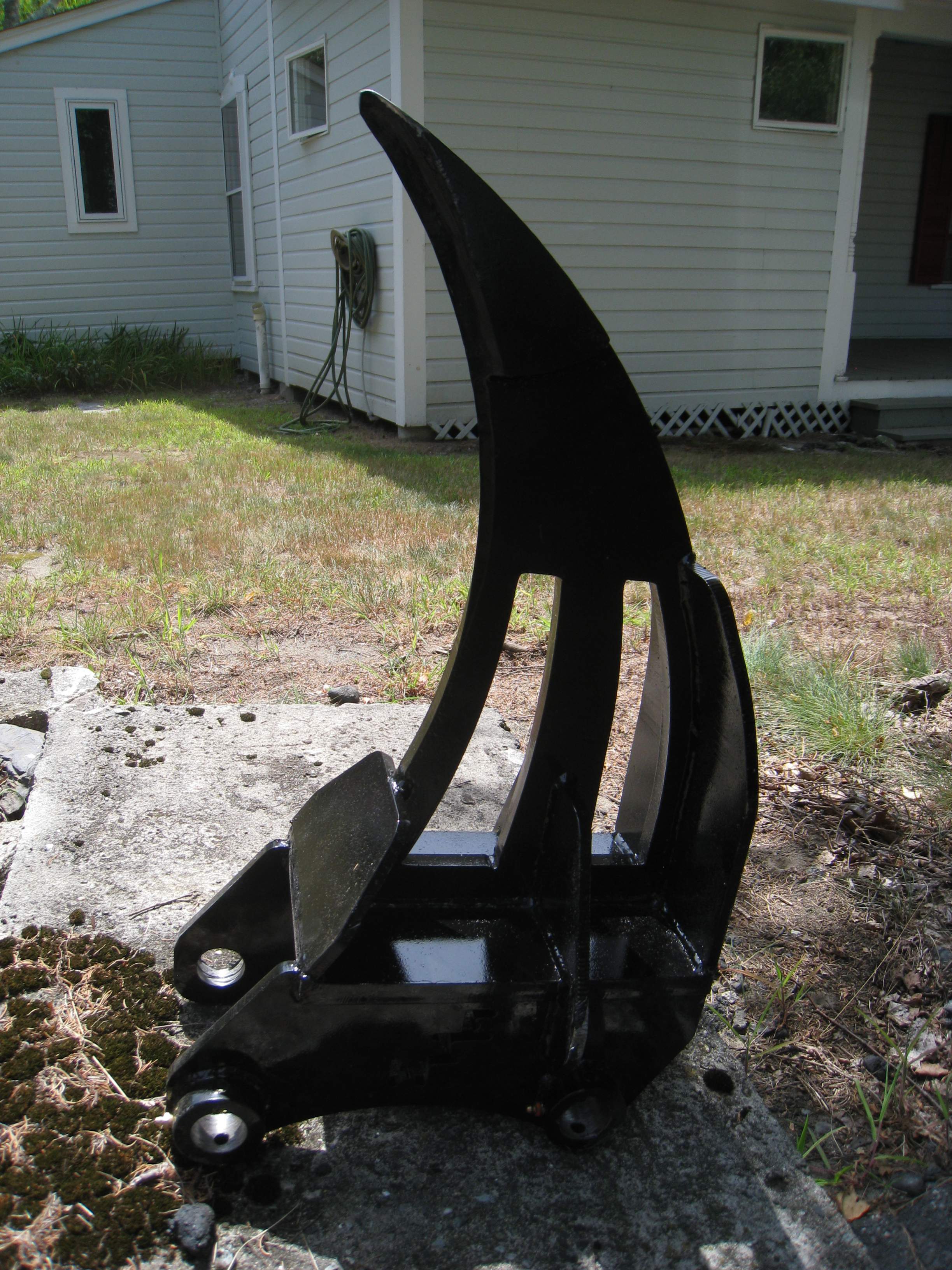

Did you consider mounting that replaceable tip with the thick side above rather than below? That's the way they're mounted on box blade scarfiers, probably for wear and stress reasons.
Very nice build.
Very nice build.
The scarifier actually came with the tip like your saying but I switched it around because I didnt like the angle it was at when you would be trying to pull through the root. Not sure yet if it was a good idea or not. They only cost a few bucks and take a couple mins to change so if it doesnt hold up I will try it the other way next time.

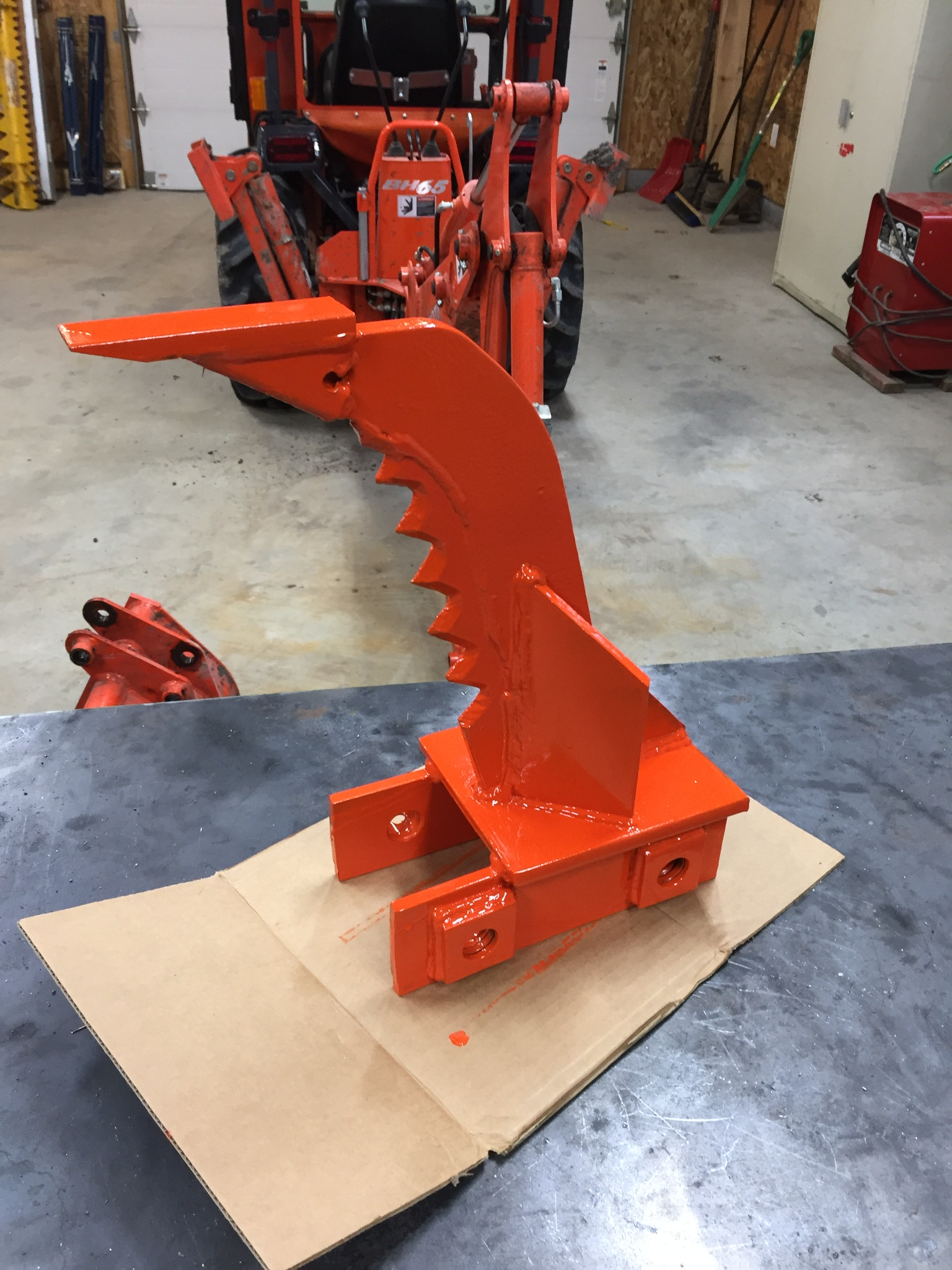

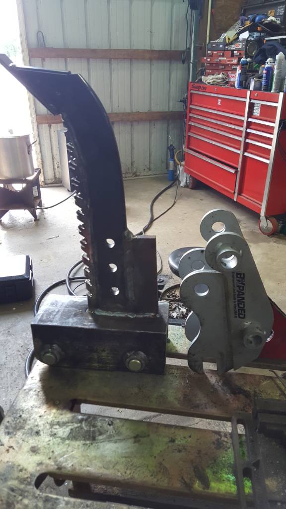

/ Backhoe Ripper #31
Interesting. Do you have photos from other angles? Have you tried it yet? Also, where did you get the quick attach and how do you like it?
i will post some more in a new thread when i get a chance.

Very nicely done. I am looking to build one for my M62 TLB and I was hoping that you have more photos, measurements or diagrams that might assist me. Any help would be appreciated.
Thanks
