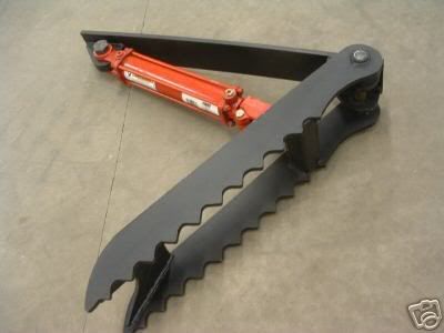

On another note, I've thought of adding "teeth" protruding out and sideways a little from the boom for "gripping" when pinching rocks like this. That might be a good solution to Jay's original question? Pinching would be easier if there was a backstop down there instead of just the narrow boom?

Those photos were BEFORE I made the subframe for the backhoe and having to pluck rocks like that is what made me build it. I knew I was asking for trouble without the subframe. It was also before I installed the dual bucket grapples. So everything I added to the tractor was to make my chores easier and safer.
Regarding bucket hooks for the backhoe, before I made my thumb, I have 2 sets of hooks to chain rocks and logs, etc. I could use the curl or uncurl depending how the object was situated. Some times just to drag out to a better place for grabbing or pinching it.
Now it's easier with the thumb (and bucket grapples) to move or drag stuff to a better position.

Here are some thumbs I looked at before building mine.
This one is Dave's articulating mechanical thumb.
This one is mine.
Here are some others that were shared here on TBN.
Below is the concept I tried to copy for my thumb.
Sorry for steeping on your thread so much Jay, but I'm thinking you might be interested in the thumbs for what you do too? Hope I'm right there? If not, please forgive me. After going through what you describe you are going through, that's when I decided to make one.:)
