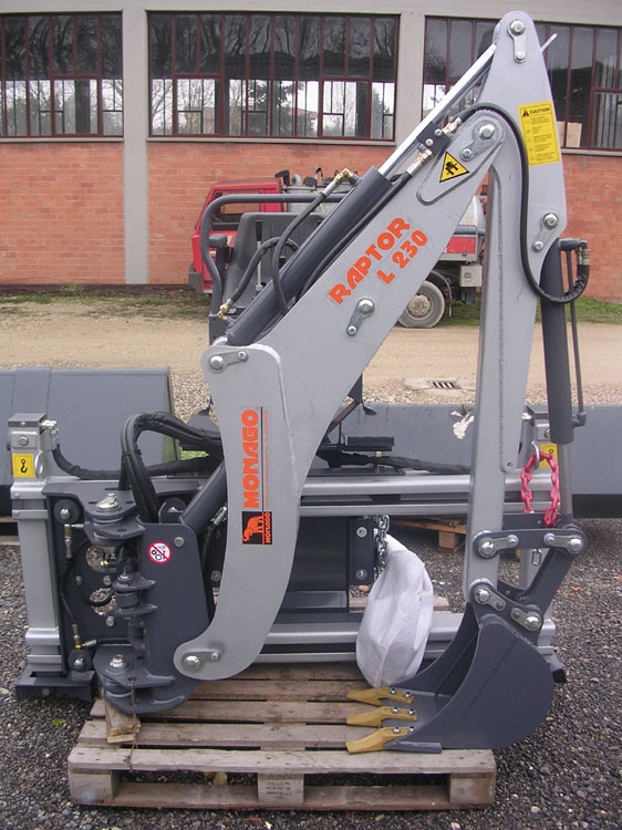

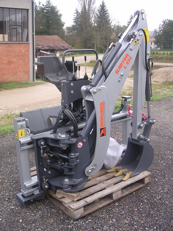

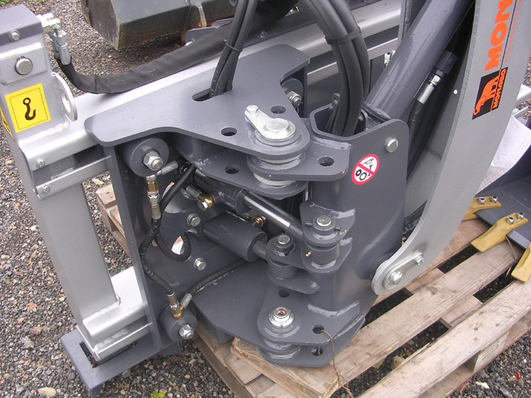

Yes i will fabricate a sub frame in the future but i will use it with 3 point until then though.
TTTTTT: Thank you for your reply, ive been looking at a Korean brand LITW also but then i have to import it my self with customs and all the other stuff that comes with self import.
Here in Europe it seems like all brand backhoes comes with PTO pump standard so no money saving there :(
You guys a probably right about the weight, will look for maximum 800 lbs Backhoe.
Just strange that the Lw6 weights about 1100-1300lbs whom are made for this tractors.
Heres pics of the italien beauty, Type 1#

Looks like a very good BH and the quality looks excellent. I'm sure you won't go wrong. Look forward to seeing the new tractor in action.
