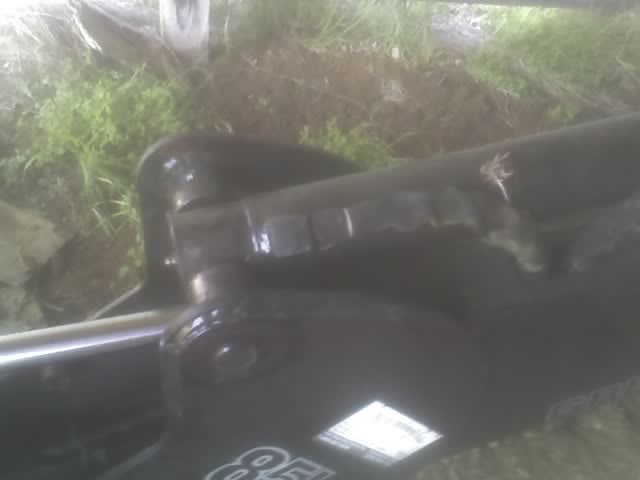

Started using the backhoe a little more, and now I get these pops on just about every stroke of the dipper cylinder. I have looked for any binding on the frame and can't see a thing. I am guessing it is a bent cylinder as has been suggested earlier in this thread.
(1) Is there any procedure for making sure this is in fact a bent cylinder?
(2) If it is, can anyone walk me through how to pull the cylinder off the hoe. I have taken it off the tractor. Great Bend 851
(3) Also,, Any ideas on how the cylinder could have been bent...I typically just idle the tractor when using the hoe,,,and I really can't remember of putting the hoe in a hard bind of any kind. Probably have used it less than 8hrs in two years...
Thanks...

I think you are sucking air past the seals when you raise the dipper, and when you bring it down, it comes down fast until the air is compressed. I also think you may have a bent rod. Check the rod by putting a straight edge on it at different places. It should be obvious.

Talked to a tractor mechanic today...Described the Popping noise to him. He thinks the nut that holds the cylinder rod at the base is loose. Sounds plausible..since I can't see anything bent or scored or other wise binding up.\
The pictures atttached are of the dipper cylinder. If it is the rod bolt on the end of the cylinder, how do I get to it? I assume the first step is to remove the cylinder off the hoe. I have the backhoe off the tractor in the barn, so I can crib it up or chain it up as needed. I think I can get it off. Is there anything special I should do about keeping fluid in the system? Should the rod be extended full out or does it matter?
ANY AND ALL IDEAS / SUGGESTIONS ARE APPRECIATED....THANKS!!!

Attachments failed to come along with the reply...Hopefully here they are...
