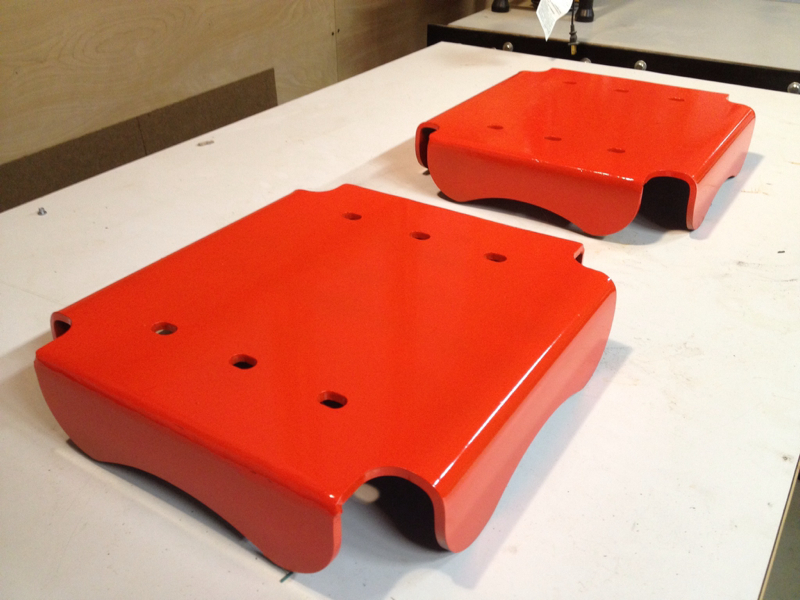

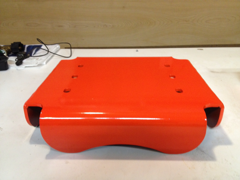

Ok. You talked me out of the powder coat, so I stopped and picked up some Chevy Orange and good primer on the way home from work today and here is the results. Really happy how they turned out. Can't wait to try them out.

Those look every bit as good as the originals. Nice job.

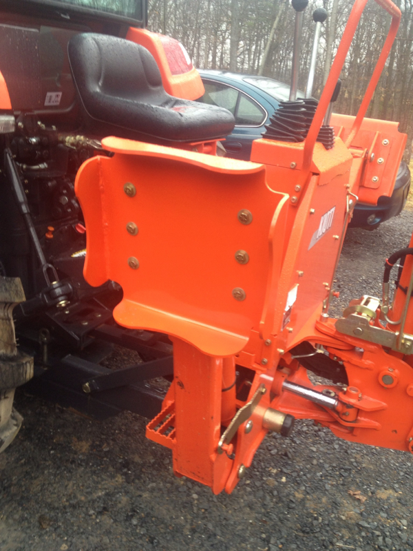

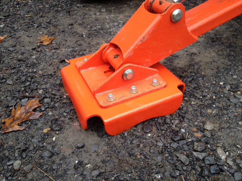

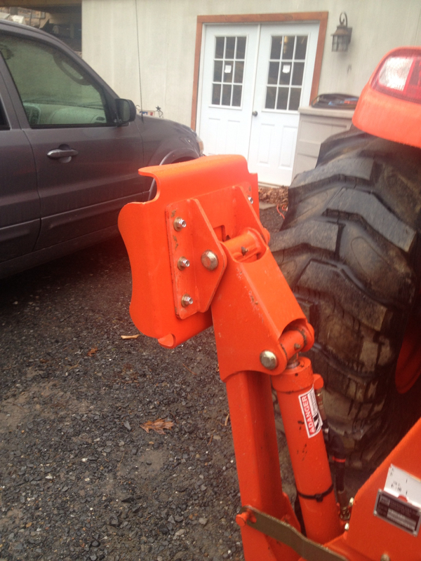

Got them installed today. They worked out pretty well.

They look nice. If I recall correctly, the pads prevented me from flipping the footpads over to reveal a flat surface when working on a hard surface. You might want to think about fabricating some filler inserts to use if you ever need to place the stabilizer pads on asphalt or other surface you don't want to damage. The commercial backhoes seem to use strips of old tires on edge and tightly bound together. A snugly fit block of wood might work too.
