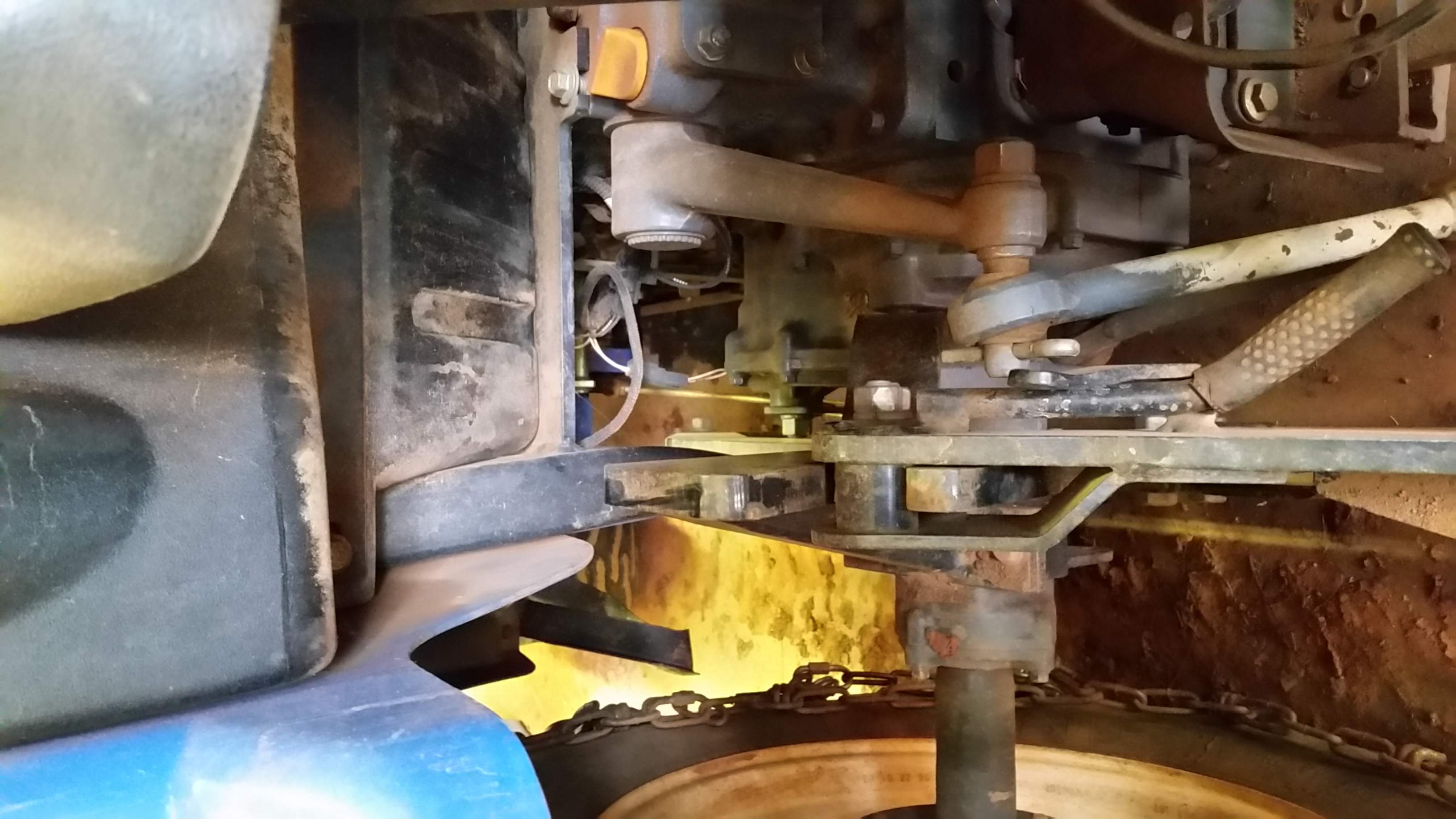

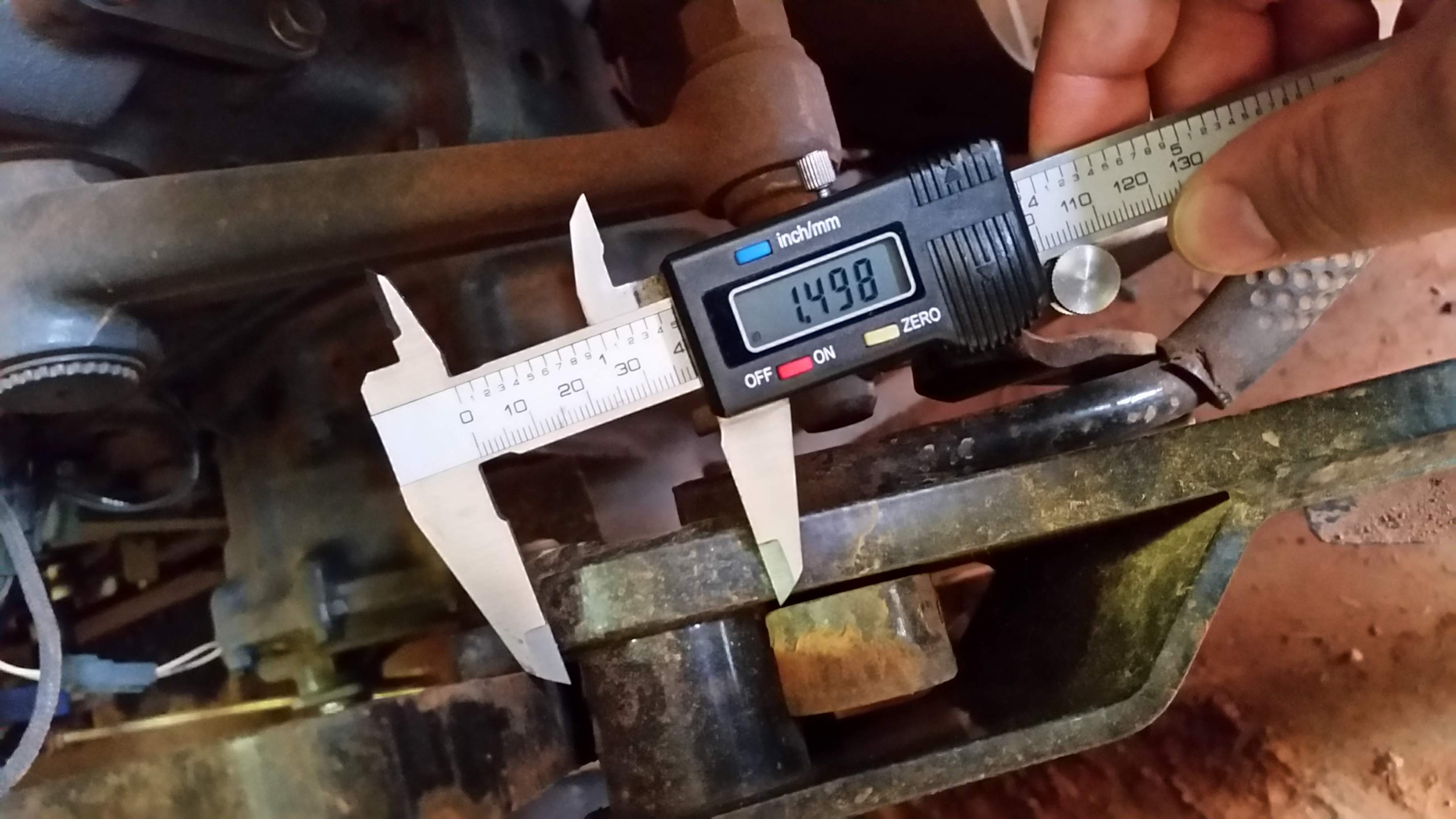

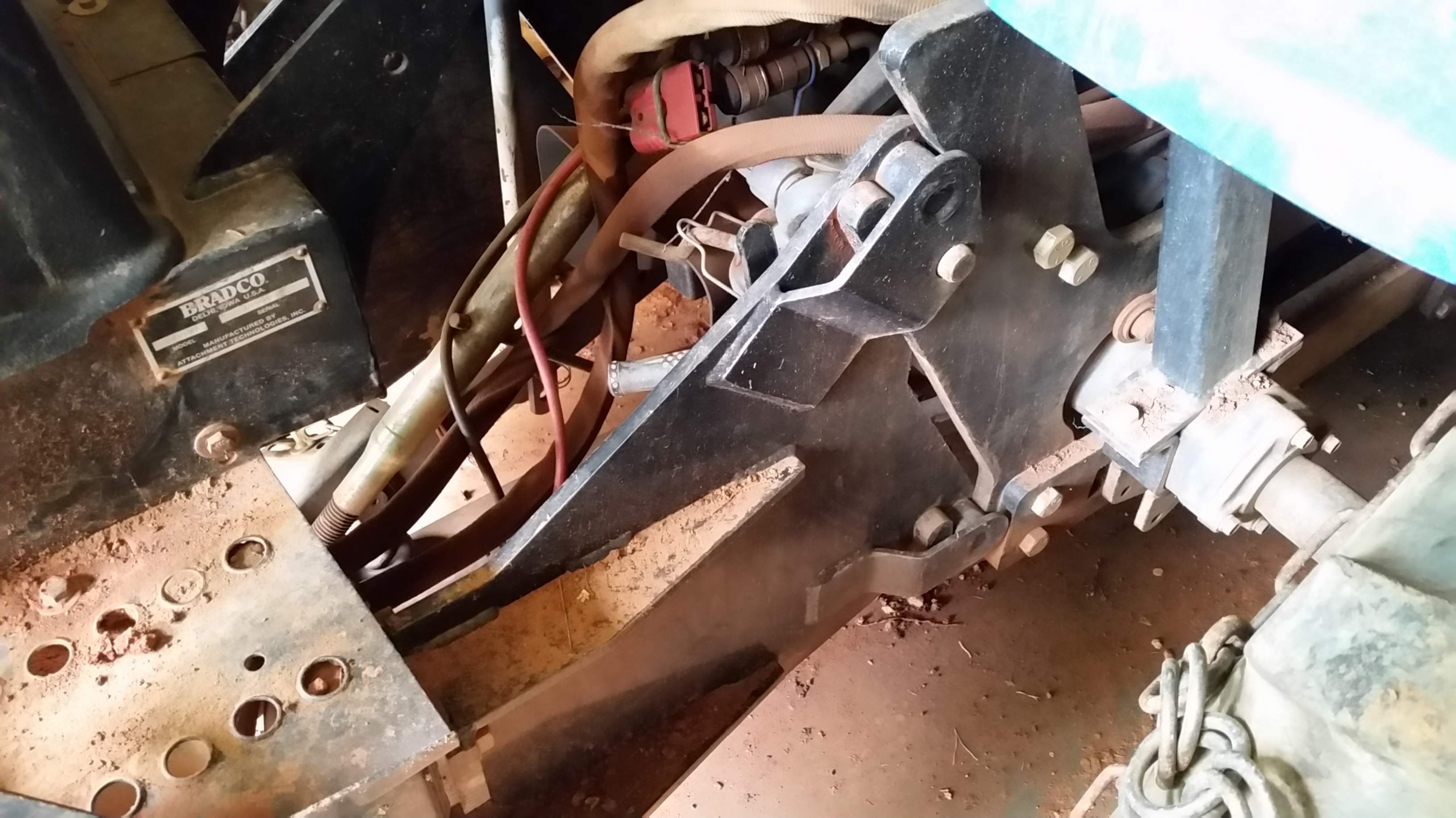

Not quite as easy as that. The issue with 4pt mounts is that all 4 contact points need to be lined up at the same time in 3 dimensions. Not terribly easy even after hooking up hydraulics and controlling the pitch and height of the BH with stabilizers and then backing into the BH. You can only control the BH height and pitch while off the tractor and can only back up the tractor while on the tractor. Not always simple. And, with the Woods, you hook the bottom pins into slots but the top pins are actually bolts that pass through the subframe so need to be lined up nearly perfectly in order to pass the bolt through and then attach the castle nut. You cannot just persuade it though the hole with a hammer as you'll strip the threads.
The advantage of the other style is that you can back the tractor over the subframe, use the BH hydraulics to raise the front part of the subframe to the right height (not nearly as fussy as with 4pt) and then back the tractor on to the front mounts and then adjust the rear mount height before backing the tractor to secure the rear mount. Two steps but each step is easy. I never had to stick my head under the tractor either. Yes, you need to judge where the front part of the subframe is as you raise it but you can do that from the side. Once you have the front mounts lined up and in contact, the rear mount just slides in and you use tapered pins to lock it in place. The tapered pins can be whacked with a mallet/hammer to make the final 1/4" adjustment.
I remember mounting the Kioti BH in 5-10 minutes most of the time. The Woods routinely takes me a minimum of 15 and sometimes double that.
I don't know about the Woods type you described (I do have the Woods manual for their 4pt. mount for the TC45 and studied it too) but I watched my friend hook up his Bradco and thought it was super slick which is why I went through all the trouble to figure out how it worked and copy the parts I liked.
