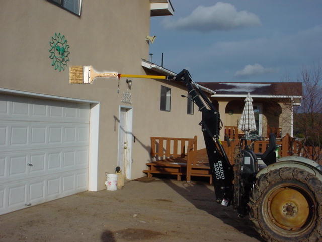

Ok Now Ive got it figured out.
Here is the ULTIMATE attachment for the new Boom Pole!!!
/forums/images/graemlins/grin.gif /forums/images/graemlins/grin.gif /forums/images/graemlins/grin.gif /forums/images/graemlins/grin.gif /forums/images/graemlins/grin.gif /forums/images/graemlins/grin.gif /forums/images/graemlins/grin.gif /forums/images/graemlins/grin.gif

What is the attachment on the dipper?
/forums/images/graemlins/confused.gifAnders

Nice job, and very timely for me. RonJHall and I were just talking yesterday about doing something similar to my FEL. After beefingup the top of my bucket, I'm thinking of welding some 2 1/2 X 2 1/2 for a reciever for a ball mount/boompole combination. How much weight do you think the pole will handle?

The Boom Pole I used is about 4 feet long and is the thin wall (1/8" thick) the one pictured is for light duty ~ 200 lbs max.
Because of leverage and length on a backhoe it would not handle much more weight without exceeding the capacity of the backhoe.
A FEL is a different story - if you use the thick 1/4" 2"x2" tube for the boom pole id say about 6 ' long max you could lift about 600 lbs without bending the pole.
However keep in mind that because of leverage the force on the receiver tube is going to be multiplied by the length & weight of the boom pole ie 6' x600 lbs = 3600 lbs of bending force at the receiver. So in this case shorter is better. The horizontal pulling capacity would easily exceed 5000 lbs.

Guglio; Thanks for the info. All I "plan" on using the boompole for will be lifting trusses no more than a couple hundred pounds max. But the ballmount will be used for logs and whatever else. Again, good job, and good idea. /forums/images/graemlins/cool.gif /forums/images/graemlins/grin.gif
