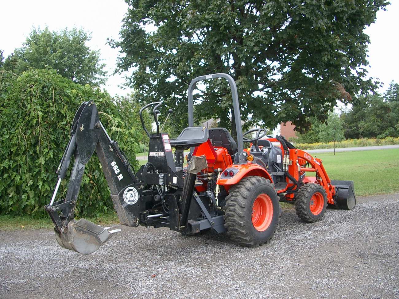

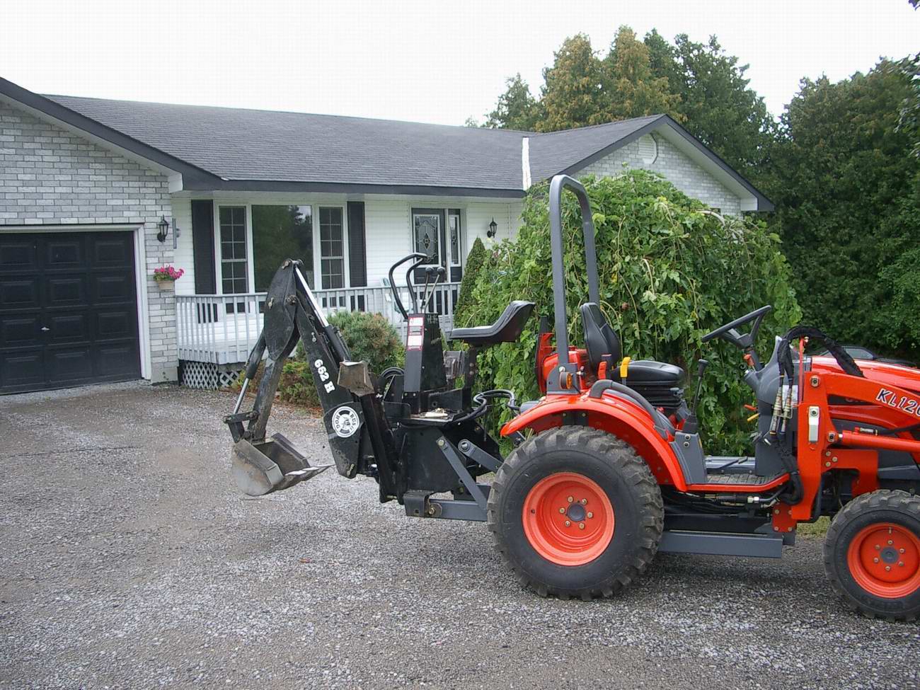

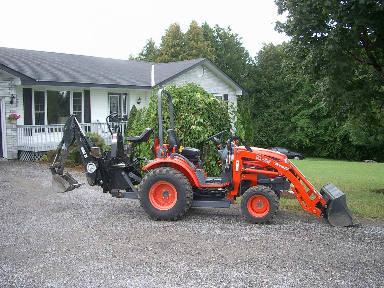

finally got my backhoe mounted onto the ck20 I brought home about a month ago. bought the rear remote kit and the subframe from my local kioti dealer and installed the remote did a little mod work to mate the hoe to the frame this weekend. hope it works as good or better then it did on my old kub. b6200.

Looks pretty good! It's nice to see it on a full subframe instead of a 3pt mount, that will surely help with the strength of the unit. Looks like that seat with have you sitting pretty high up too which may be a good thing.

I cannot see from the photos if you have the loader fix kit installed. Looks like the KL120 rather than KL120B so you might want to double check on that.

If you look in the 3rd picture, you can see the bolts of the kit. You old guys need new glasses...:eek: :D :D

Thanks guy's, I think the subframe will be a real bonus although the hoe was on the three pt. hitch on my b6200, it had bracing from the loader to the rearend to reduce flexing, I never had any problems with breaking the tractor. but i was allways concerned, again I think the frame will be better. the seat height is comforable and the whole thing only measures about 2 " higher overall on the ck20 than on the 6200.Just a bit of welding and drilling to fit the frame to the hoe. All told I spent about 1/2 a day each sat & sun to do the job including the remotes. and yes the loader has the update. Oh and it was either the guy in the greasey coveralls or the wife, and I might lose the tractor to her if I had done that.
