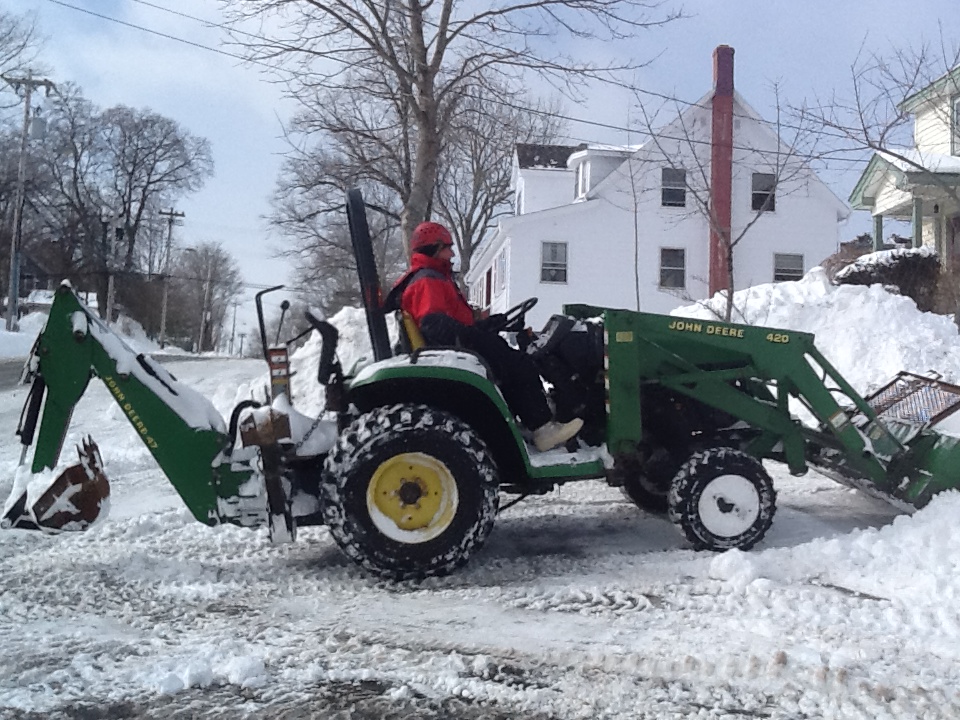

Ok lets see the #7 backhoe
How is this.:)

Wait a minute... Egon. You're correct that your backhoe attaches in the same way as the #48 hoe. That's because you've got a model 47 --- not, a model 7!

Yea, I guess there is a difference between the 7 and 47. :(
Lets just say an aging process.:thumbsup:
