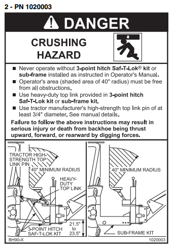

If a subframe is too much look at Kubota's 3-point hitch saf-t-lok
solution and get a beefed up top link and bars from the 3 point arms to the top-link.
/ Backhoe #7
That saf-t-lok may help protect the operator, but ti does nothing to protect the tractor from the stresses a backhoe can put on it. Some tractors are designed to handle that, but the vast majority of today's CUTs are not.
