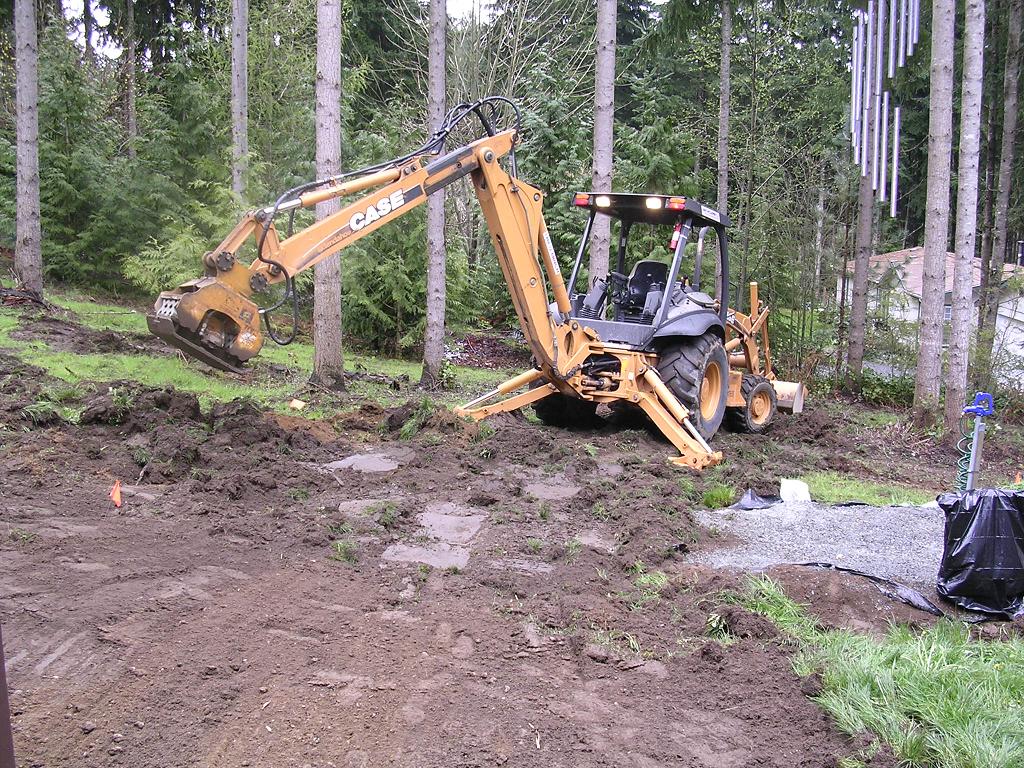

Case has always used this style design for extendahoes. Cat puts theirs inside and Deere's is on the outside. For a time Deere had the rod inside the stick.
Case has always built their hoes to be over the center. It's great for driving and such. The non-curved boom is nice for climbing piles as well...as someone mentioned. It also makes the ride much smoother. I'm not sure if there is a huge difference on transporting the hoe no a trailer. I've never seen a significant difference on how the case hoe rests on the trailer versus the deere or cat. Both transport well. I've used both, don't really care for the curved booms. Everything just seem so heavy. Case's hoes are designed light but with a very strong steel.
