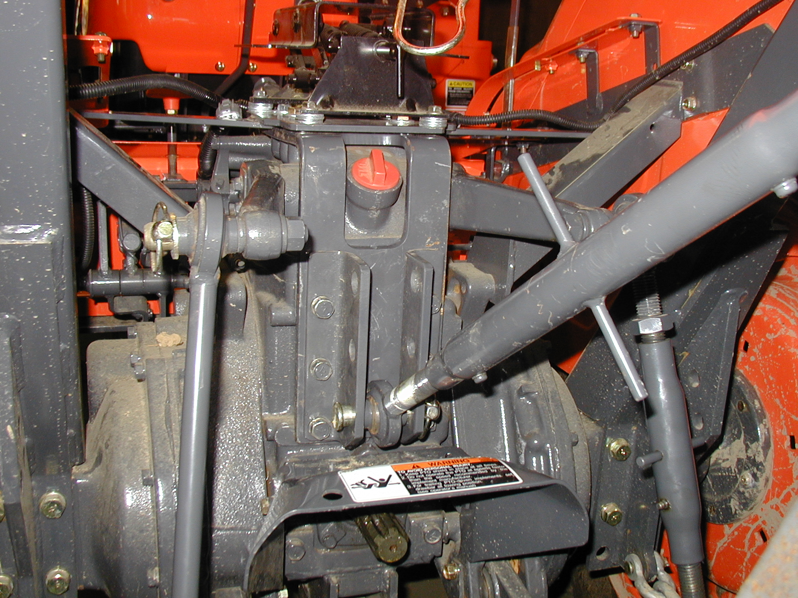

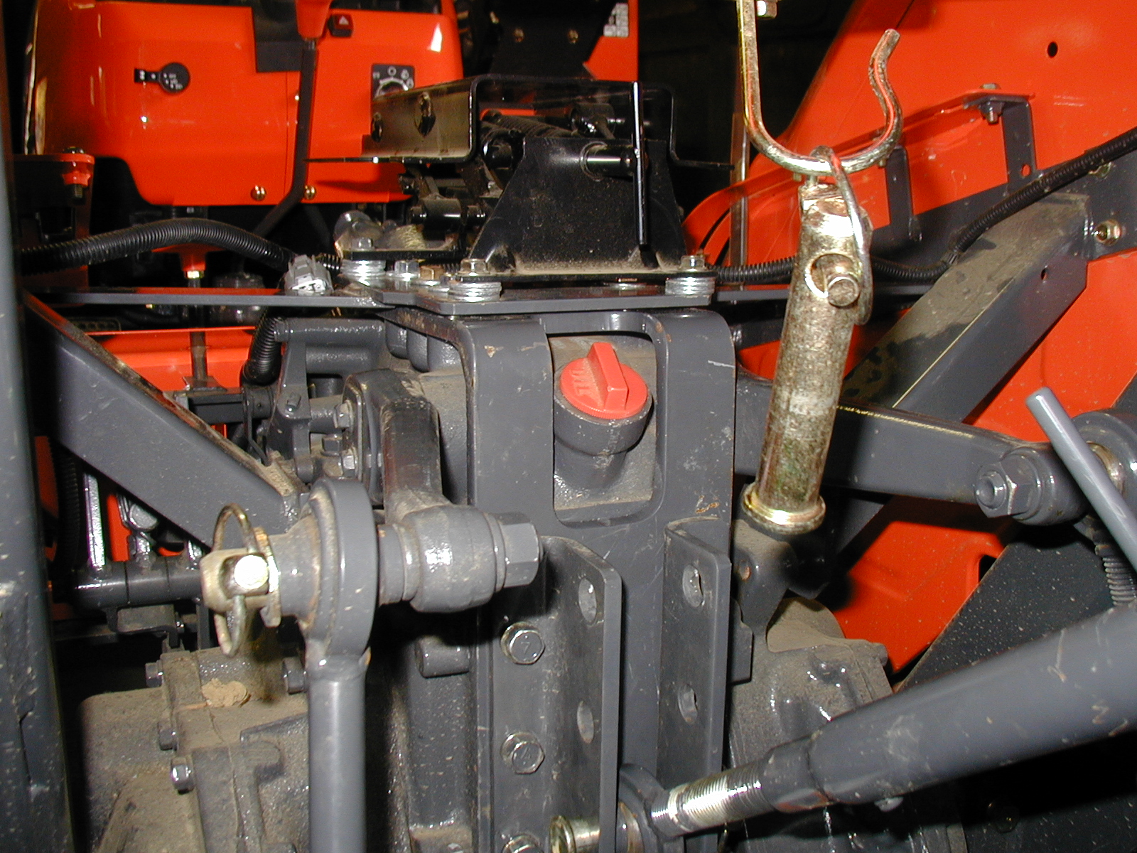

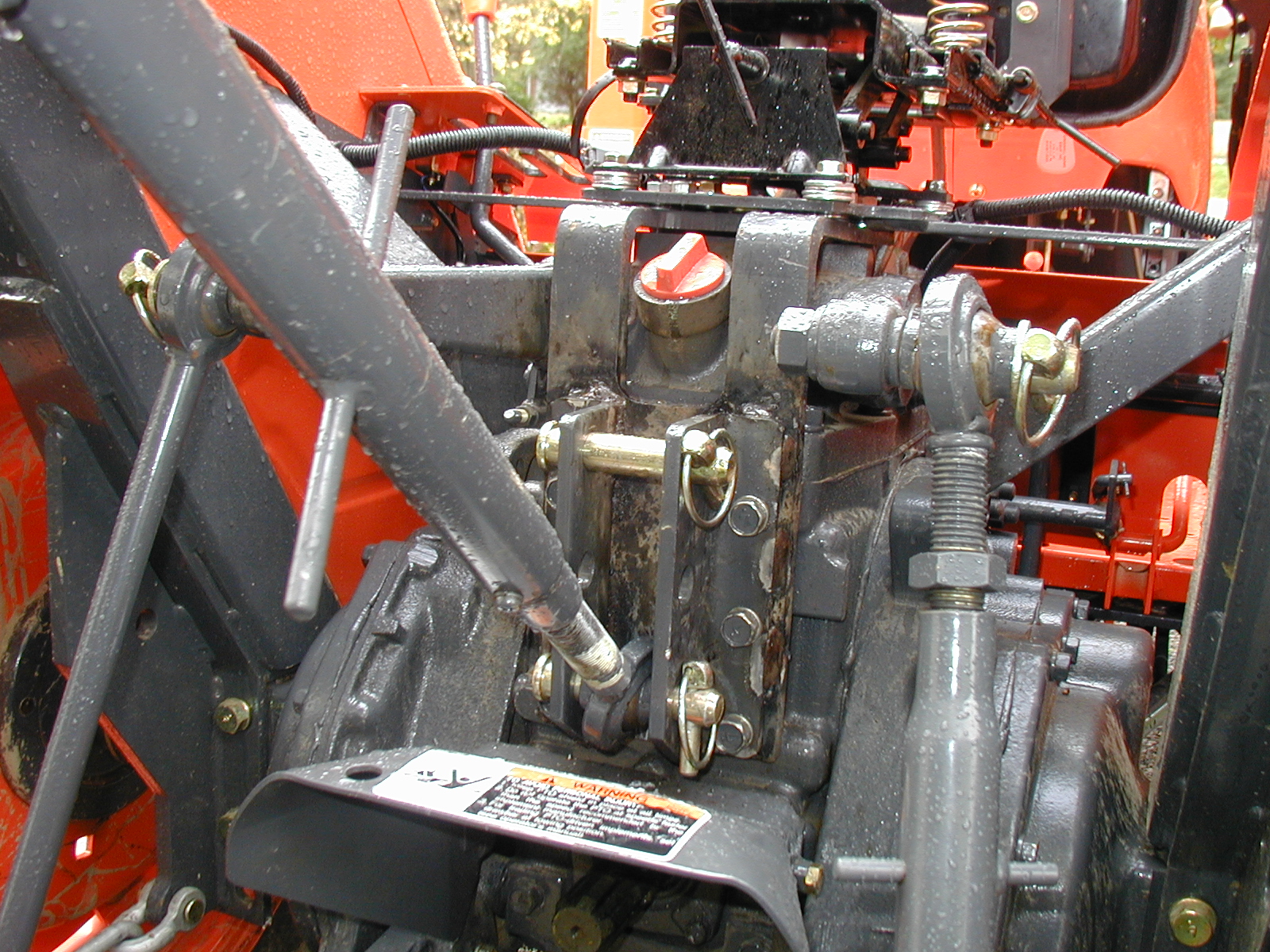

Having any 3 pt attachment for your tractor is a learning curve. You must understand the capability of it.
One of the biggest problem I have seen is having a 3 pt backhoe on a tractor without the proper mounting.
IE: 3pt vs 4pt subframe.
Several years ago their where pictures of Kubota tractors with split / broken top link mounts on the
rear housing from backhoe attachments.(operator error?)
Many dealers didn't know that Kubota has a top link support for it. (see pic) both 3pt and 4pt subframe.
Educate and understand what you want to do with the hoe.
The top link bracket is welded to the support bracket so that it does not pull the bolts out / break housing.

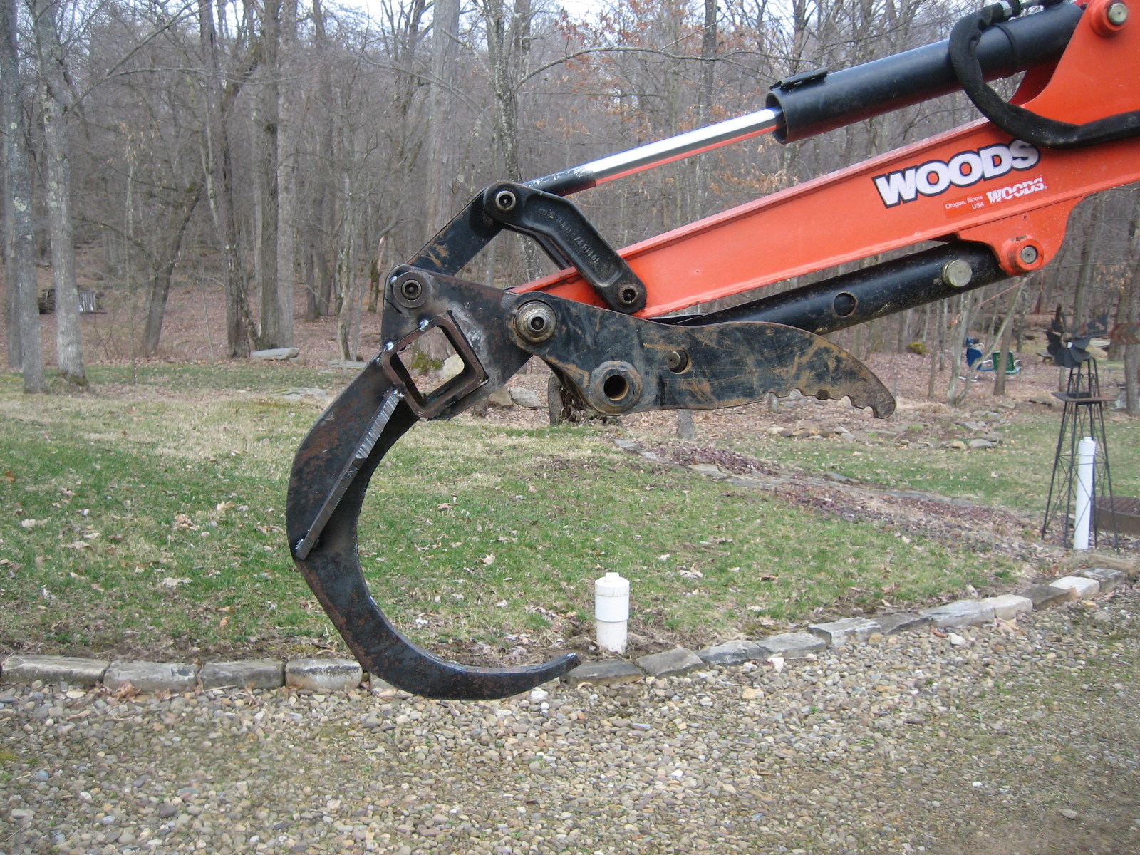

I have a Kubota L3400 with a Woods BH80 4 pt subframe AND TOP LINK SUPPORT.

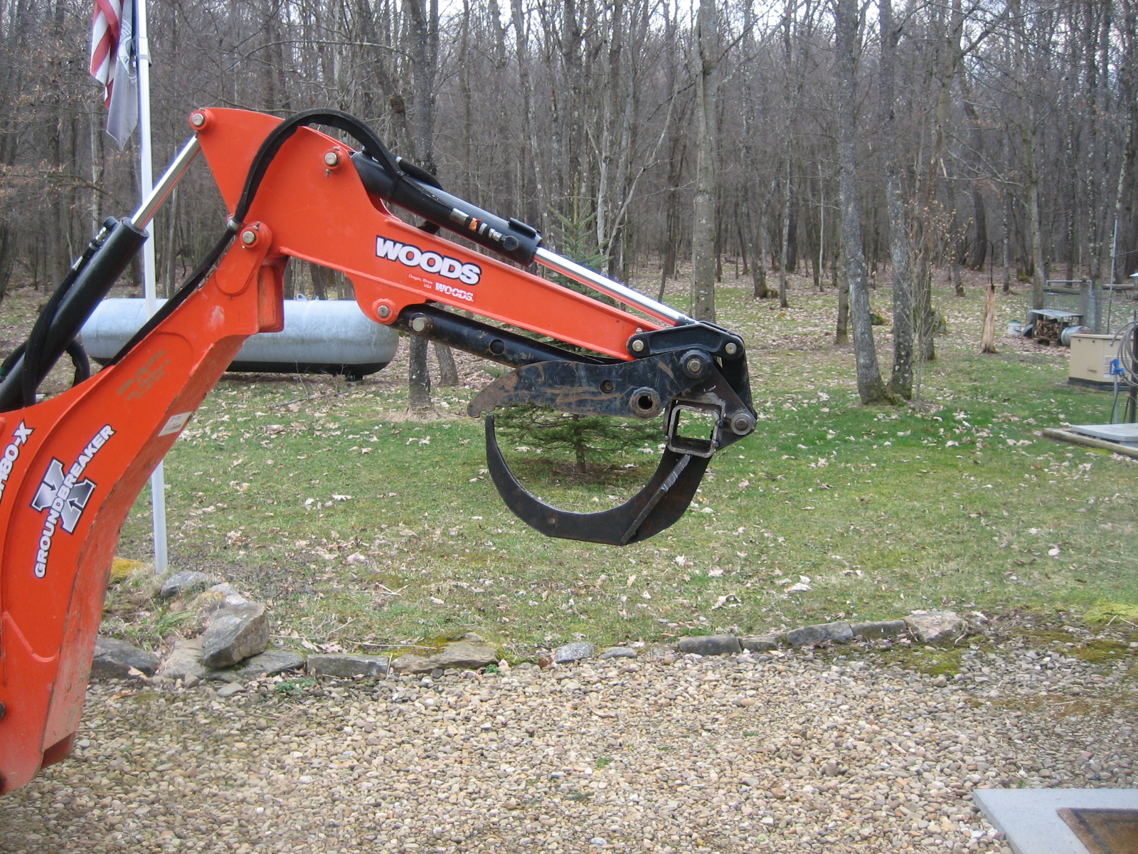

Also I built a ripper tooth which makes digging roots easier with less soil disturbance
than using a bucket.

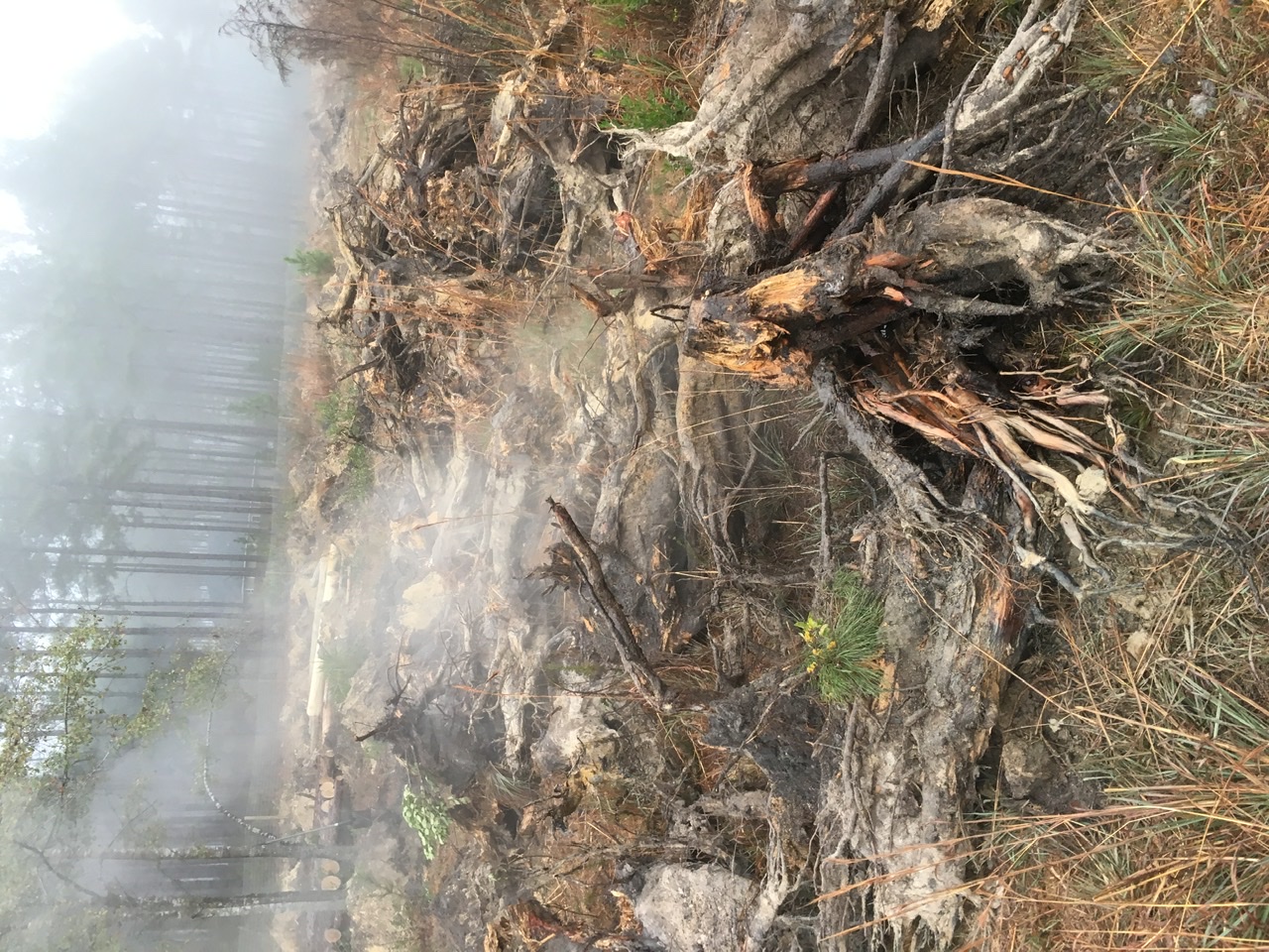

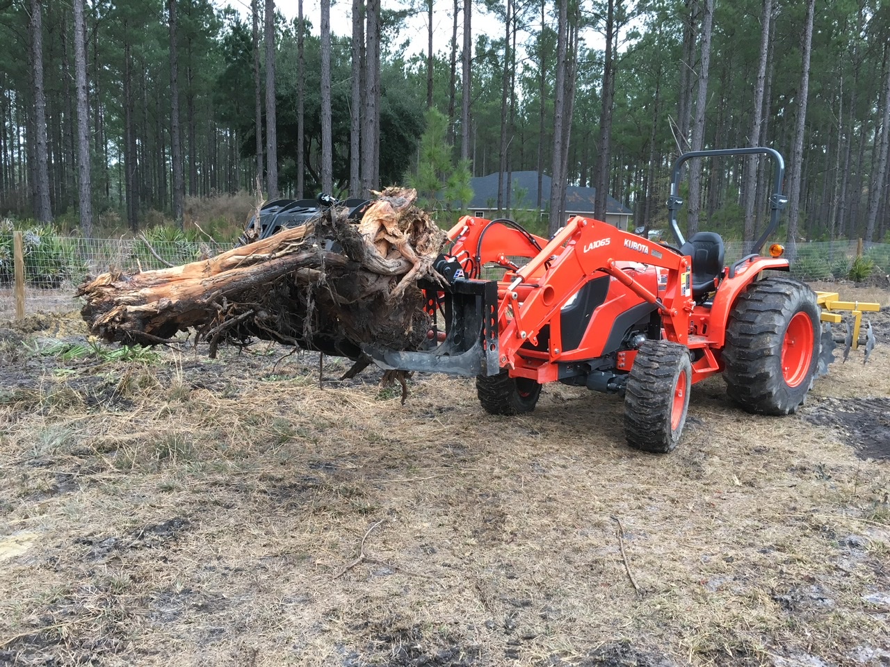

I've got a MX5800 with the hoe and hydraulic thumb and love it. Its first job was clearing 5 acres of harvested pine stumps most between 8-12? I averaged 10 per hour with it in pretty sandy soil. I helped a guy get a really large pine stump out after a storm, maybe a 24 tree and that one I think I had to reposition twice before it popped out, maybe half an hour?
