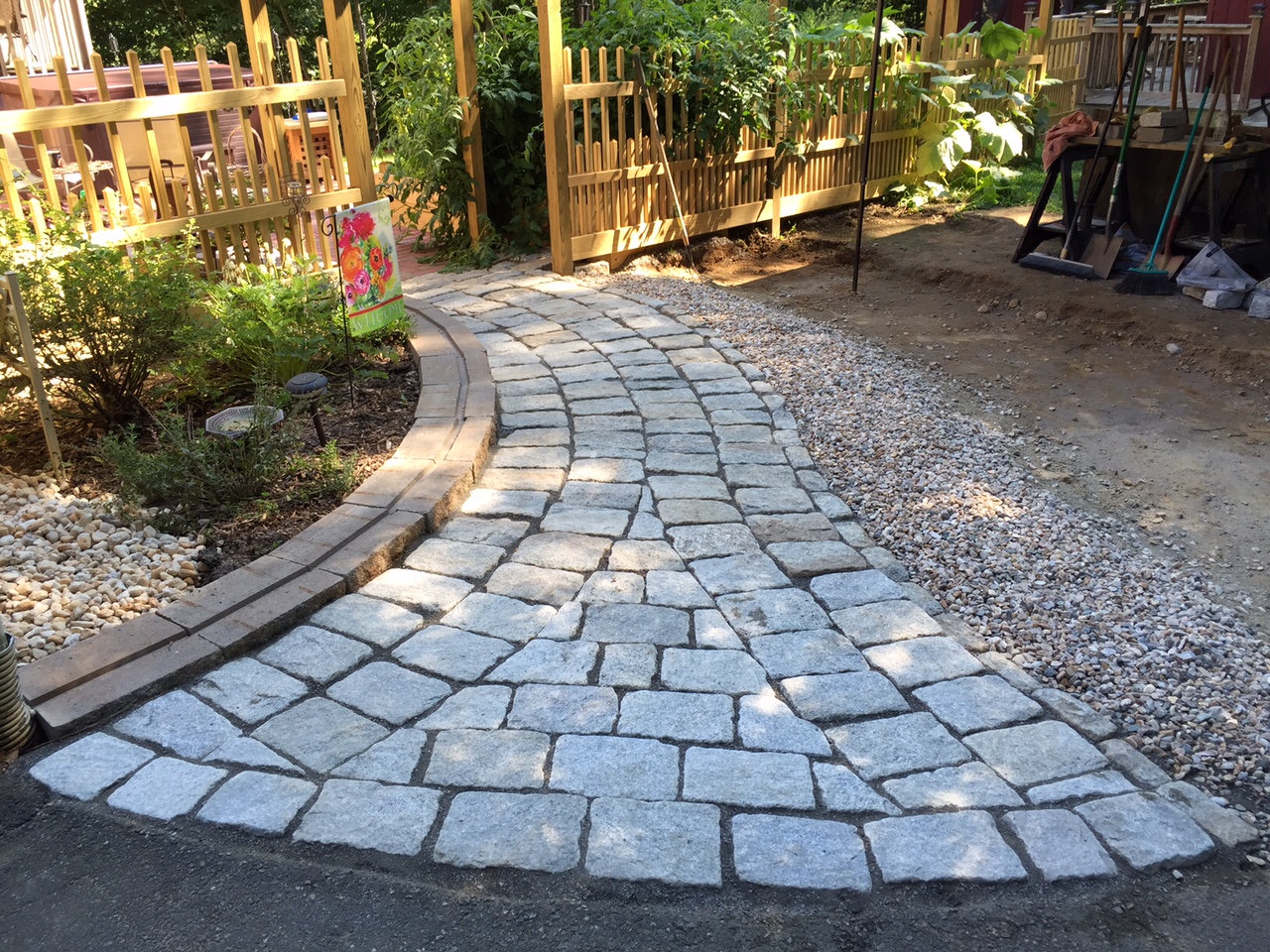

Wrooster, Nice work - everything looks great, first class all the way. I did a fair share of stonecutting this past summer so I know what it takes to do what you did. One project involved re-purposing a few hundred Belgian block edgers into a walkway from the drive to the patio.
There are twenty 80 lb retaining wall blocks buried under the 3/4" stone on the right side to keep the cobblestones in place. The cobblestones are 4" thick - too thick and hard for my 10" diamond saw, I wound up scoring them an inch deep, then used splitting chisels to cleave them through. I then hammered the sharp edges to make them look worn. I used a flexible sealer grout made for wider gaps between the stones.
