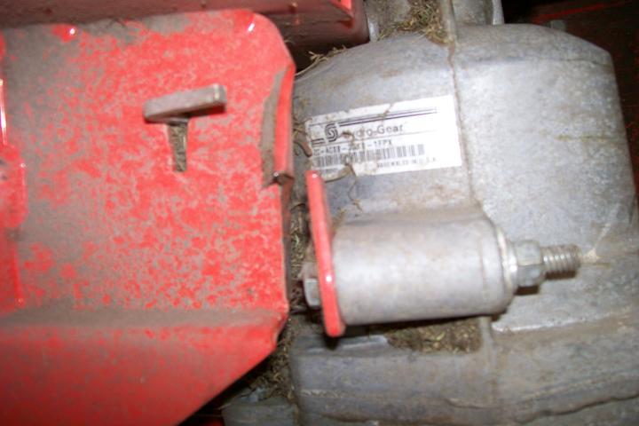

Hello Folk, Yes mine is a 4800 mz and its only about a year old.
I think I spoke too soon, was just mowing and noticed it wasn't cutting evenly.
I had a look underneath and there is a plate (about .125" thick joining both hydrostatic drives together and it is cracked/broken at the bolt holes.
I thought no problem I could even fashion one of those up with plate. (cold)
I then noticed where the left hand hydrostatic drive fastens to the chassis that the lug on the chassis is also broken so I reckon I'll have to pull the drive out completely to weld it up. I might even have to upturn the whole thing , if so the motor will have to come off.

Hello Folk, I'll try and attach a pic. This will not be easy to get to.
Regards Vince Smith.

Looks lik metal fatigue. At the risk of making it so strong that it breaks the aluminum attachment point, I would make that strip about double thick with maybe even putting a stiff back on the back side. It looks like it may be flexing side to side. A stiffener on the side will take care of that. If you have to remove it or upside down it, I would modify the opposite side at the same time and maybe look for other weak attachment point that need beefing up a bit especially since you say it is very rough in your block.
   / Bad Boy Mowers #16
Hello Gary, Yes I reckon metal fatigue, although its not very obvious (in the photo) the bottom end of the flap that has been folded could have been welded to make it super solid. I happen to be travelling the 500 + k to the dealers town this weekend and will takl to them but I've been thinking if I'm to do this myself I might try an angle iron mount bolted to both planes rather than upend everything etc.
