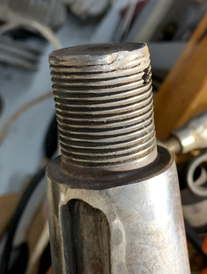

Loose castle nut? You are kidding, right? I had a castle nut come off on me because debris took out the cotter pin, then the nut came off and the stump jumper fell to the ground. Here are the threads on the $400 shaft.
I ended up spending a few hours removing the shaft and putting it on my lathe and cleaning up (re-cutting) the threads. Not fun, but the Mrs would not understand that kind of expense.
To make matters worse, this was the center cutter on my 3-cutter batwing. The two outside blade sets did a beat-down on that center stump jumper. I can't find a picture of it, but the 1/8" steel pan was mangled.
Did you repair that wollered out keyway why you were at it?
Most stump jumpers anymore are splined.
Had an old bushhog 105 that was a key and taper. Looked as bad as yours and stump jumper was wollered out and wouldnt get tight on the taper any more.
Took some welding and a special broach hub I made for the taper on the jumper and some work on the lathe and mill re-keying the output shaft but the end result worked.
Had it been splined I have no way to re-work that on a mill and lathe...so I guess that is one benefit of a simple taper and key
I did minimal work on the keyway. The metal on the shaft was pushed up, so I used a hand grinder to take it back down to where it should be. That left the walls with a little slope to their sides. I didn't see anything worth messing with on the hub so just bought new key stock and made a new key and slapped it all together. Pieces seemed to pull up tight together. I figure if there is stress on the key because of the wollering, then the key may get slightly reshaped if it hits something pretty hard. I too am glad it was not splined. This unit may be at least 25 years old.
