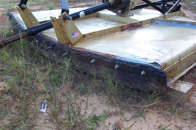

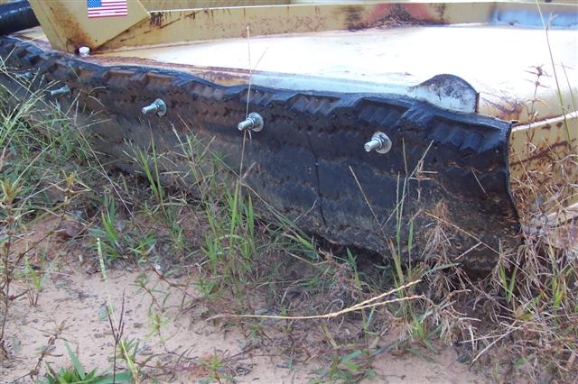

... So I put the bagger on and headed out.
Chris,
What are you mowing with? It sounds like small riding mower, but I'm not sure. If that's it, then this wont help.
With my rotary cutter, I was dying from all the dust that came up from the front of the mower. It was basically a giant fan when going over dry areas, and the dust would just blow up all over me. Same thing as you described, it would get so thick that I had to stop so that it would settle and I could see again.
Then I got the idea to attach a tire to the front of the deck. I cut the tire and bolted it to where most people attach lengths of chain. The holes were already there for 5/16 cairrage bolts, so it was really simple.
The results are just amazing. The dust now shoots out the sides and I barely notice it. The natural curve of the tire catches it and sends it off to to either side. I mow with the tire just barely touching, or off the ground an inch. Either way, it doesn't really matter, I no longer have any dust issues.
It's probably the smartest thing I've done!!!!!!!!!
Eddie
   / Bad dusty mowing #17
Sounds like a good idea Eddie....got pictures?
   / Bad dusty mowing #18
Yeah, that is a good idea Eddie.
I never thought of using the tire to channel the dust and debris like that. I know Soundguy uses cut up tires as guards, but he never mentioned that would channel the dust like that. Is yours one length then?
I'd like to see pictures too. I just made chain guards for my rotary cutter. They do the job of keeping big stuff from shooting out but don't address the dust and debris channeling like your tire idea.
   / Bad dusty mowing #19
Here's a few pics. I'll be using it this weekend, but don't have time to hook it up until then, so the pics are of it just sitting there.
The beauty of it is the shape of the tire. It naturally catches the dust and sends it off to the sides.
Eddie
