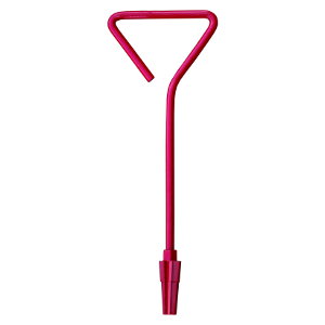

Working irrigation, we use something like this to remove broken pipe or stuck pipe.
It is aluminum, but you might be able to make something like it from steel.
A tapered bit of metal with grooves cut in it.

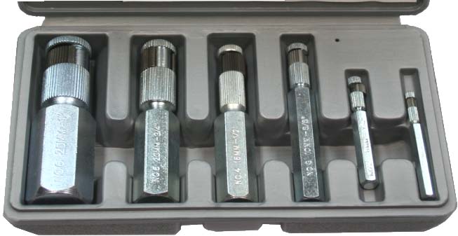

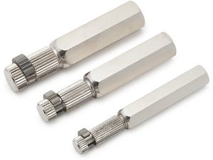

You didn't say what size it is, but an Internal pipe wrench should work.

you want the internal pipe wrench , E Z outs will expand the pipe and may make it very difficult to remove,
the best type of internal pipe wrench I have found is the one with three tabs that expand internally and grip the pipe that way, Proto makes them, the one with the ring that revolves works too, but not as strong,

1/2'' id. Thank you ace has the stud wrench, which is 1/2 and 3/4, I will look at the internal pipe wrenchs too. Thanks!!

I bought the internal pipe wrenches. I had to use a step bit to drill out the tube a bit but once that was out the internal pipe wrench worked like a charm. Now its just replacing parts....the weather is getting cold and I hope to cut the grass one last time. Thank you all for your help.
