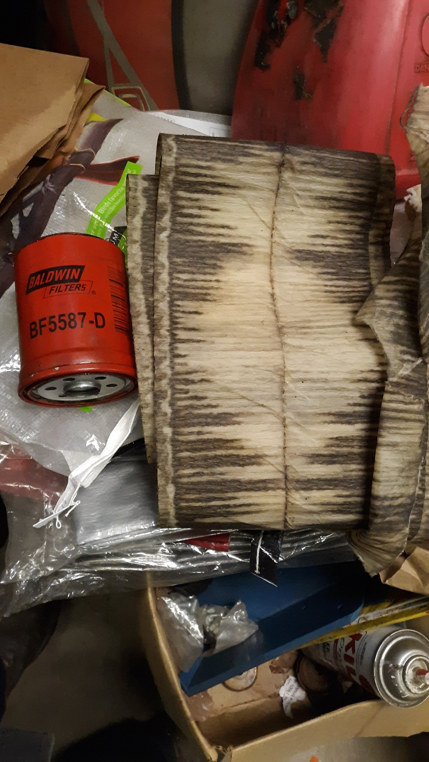

I saved an old Baldwin fuel filter for a complete cutaway to show how good the filter works. This filter fits my Kioti NX4510HST. This filter has 400 hours on it. This filter has a 1 micron better rating than the Kioti Filter according to both manufacturers. The filter element is folded over and wrapped like a toilet paper roll. You can see by the dark colors how the filter works. The lighter part of the filter is where the fuel exits inside the cartiridge.
