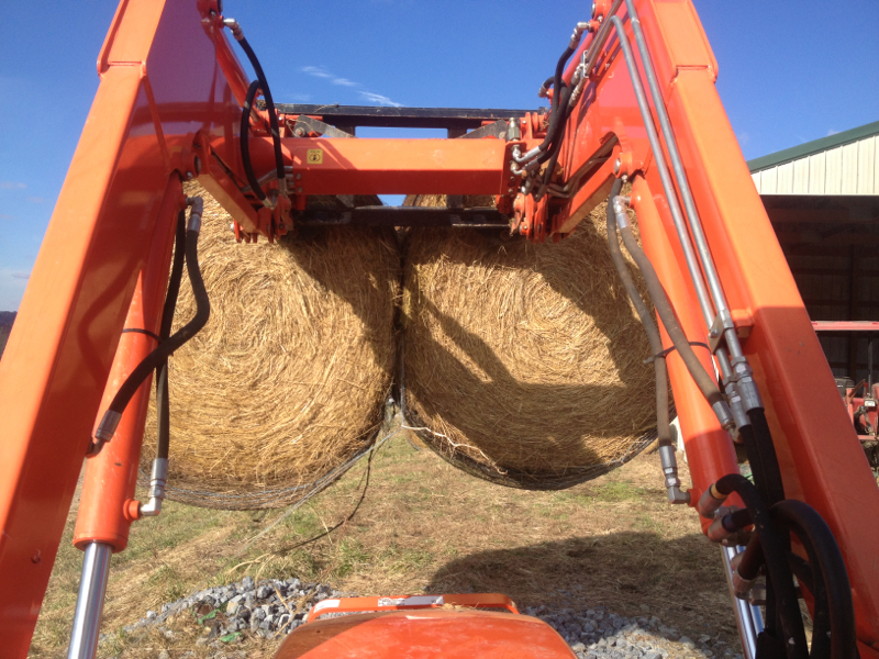

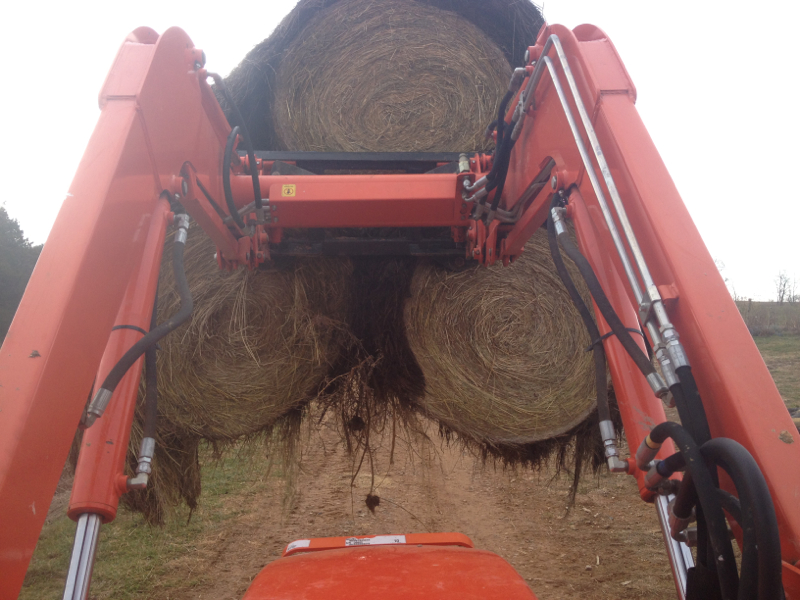

I bought a Blue Diamond spear with two long bottom tines. The only disadvantage I see is small diameter bales, as mentioned earlier, can tear out when the tines are too close to the outside. The way around that is to spear them low, like right at the ground, that way you are more or less cradling the bale instead of spearing it.
They do work good for pallet forks too. I'm sure they aren't as strong as the real deal but I don't need pallet forks often and can't justify the price.
Here I'm unloading some nice net wrapped hay.
Here I'm hauling some year old hay, just showing off because some one said I couldn't.

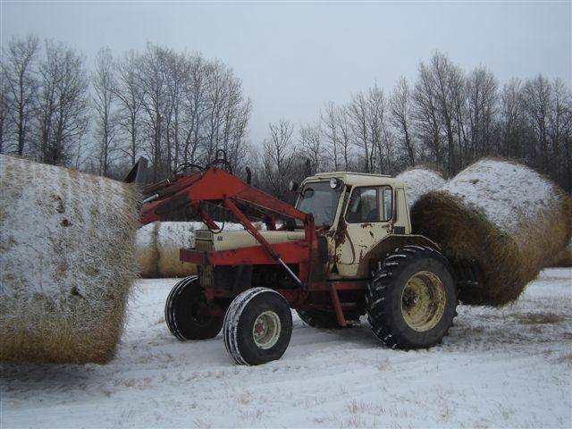

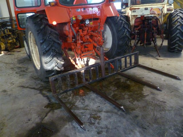

I build this 4 prong fork for my 3 point hitch. That way i can pick up 2 round bales at once on the rear, i have a similar 2 prong fork on the front end loader.
It enables me to move 3 or 4 bales at a crack when feeding.
Having the tines at the bottom enables a guy to pick up a damaged bale or a tightly baled one from underneath.
The tines or prongs are made from 2" x 5/16" wall sq tubing and 44" long with a fairly point that penetrates easy in most bales but tightly baled short grass bales,.but even a single sharp solid spike has trouble with those i found.
