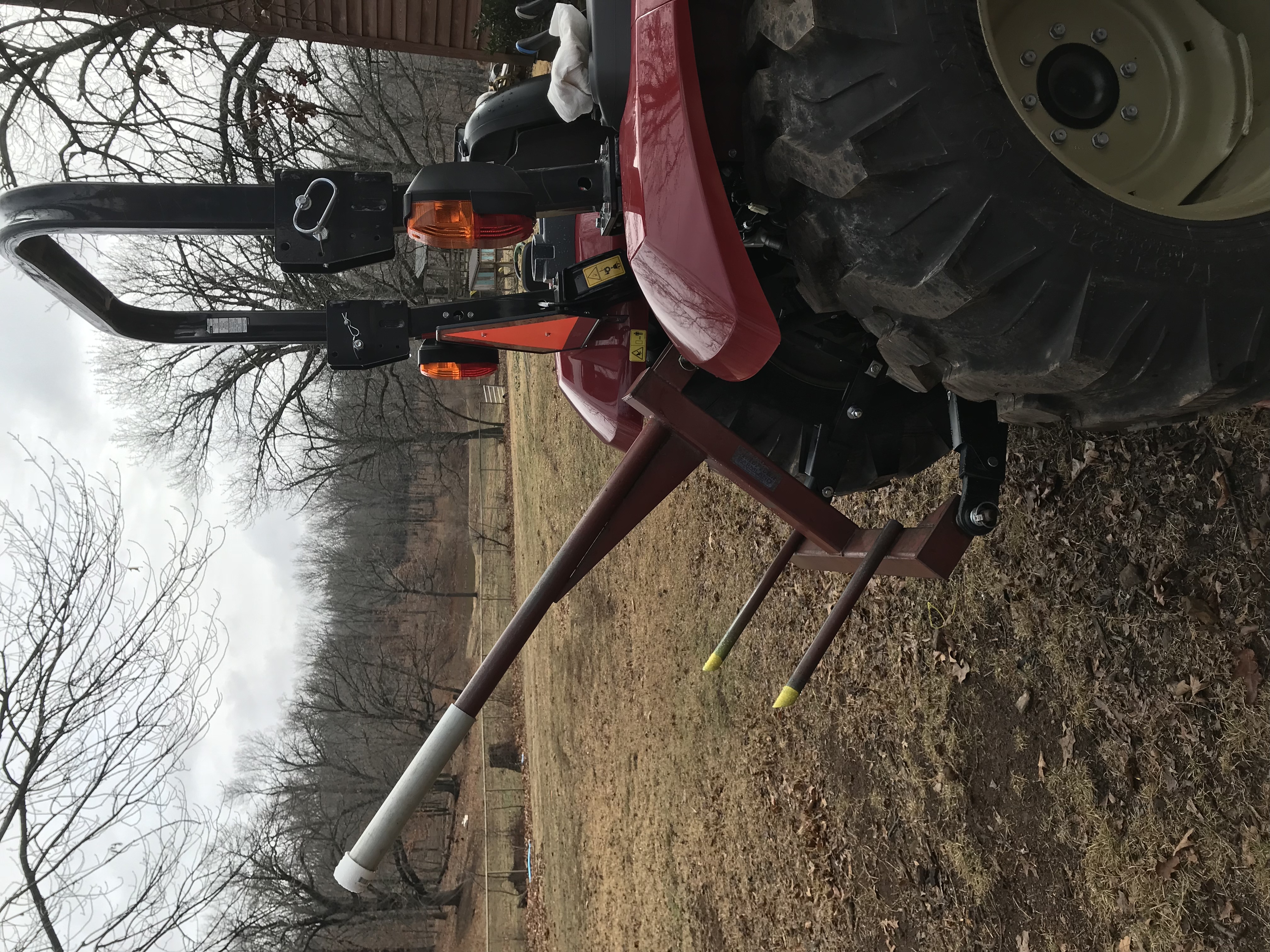

Maybe I'm too late but, buy a package of 3/4 copper pipe insulating foam and a roll of bright orange duct tape with a cord hanging from the top spear to the lower spears. Make the cord long enough to catch a bale and pull off and replace when finished.

Well as usual I'm late to the party but I was going to suggest asking your local FD for any decommissioned fire hose. Cut to length then just duct tape, staple, bolt, glue, or whatever one end shut and make a scabbard for it.

Thanks again. The pipe is working perfectly.

How about a piece of pvc pipe with a cap on the end to cover the point
X3 to get all the tips. The other two would be nasty if fallen onto.

Update: When I removed my handy pipe cover - it was filled with water. Be sure to add weep holes. I will try and keep you informed.
My bottom stabilizers are pretty innocuous. They MIGHT hurt a shin - but it would take some work.
