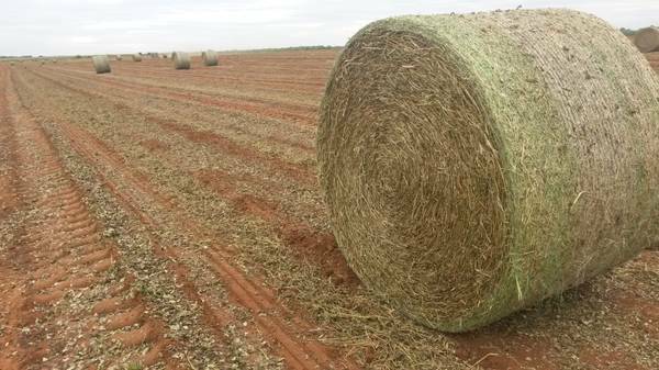

Peanuts are grown in very sandy(sugar) soil. The vines are tough combined with the sand is very abrasive on a baler.

As I'm sure you know, peanuts must be dug and flipped over to dry. The process for digging peanuts basically leaves the ground in a plowed state. After a few days in the sun, the peanuts are picked/combined and the hay is ready to bale. Just imagine running your baler through a 3 day old plowed field.
Sometimes you cannot see the baler behind the tractor, the PTO shaft just disappears into a cloud of dust. There no way to keep it totally out of the dirt, so you do end up running a lot of dirt through the baler. The hardest hit area is the pickup, but most of the newer belt balers handle it very well (you don't want to use an old chain baler). Peanut vines are tough and years ago we always square baled it, so you can imagine the amount of dirt on the knotters. It still did let damage to the baler than it did to you hauling it.
Peanuts "straw" makes excellent cow hay and I have often heard that it's close to alfalfa in its nutrient value, but I never really looked it up to confirm. I can tell you from personal experience that if you put a bale of your best coastal hay and a bale of peanut hay in same pasture, a cow will eat the peanut hay and lick the ground clean before even thinking about the coastal.

Jim, I agree with you on the vines being tough and the dirt being abrasive, but in our part of the world very few peanuts are planted in sugar sandy soil. Maybe there’s a difference between our views on soil types, but in GA we have a lot clay.
From your picture, that was a nice size peanut field.

I don't recall ever seeing peanuts grown in any other type soil other than sand here where I live. Back in the 60's - late 80's when I worked for a JD dealer a lot of acres of peanuts were grown but not very much now. I agree on the excellent quality of peanut hay. I remember sq peanut bale handlers wearing leather chaps to protect pants/legs from extreme abrasive stalks.
