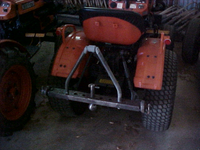

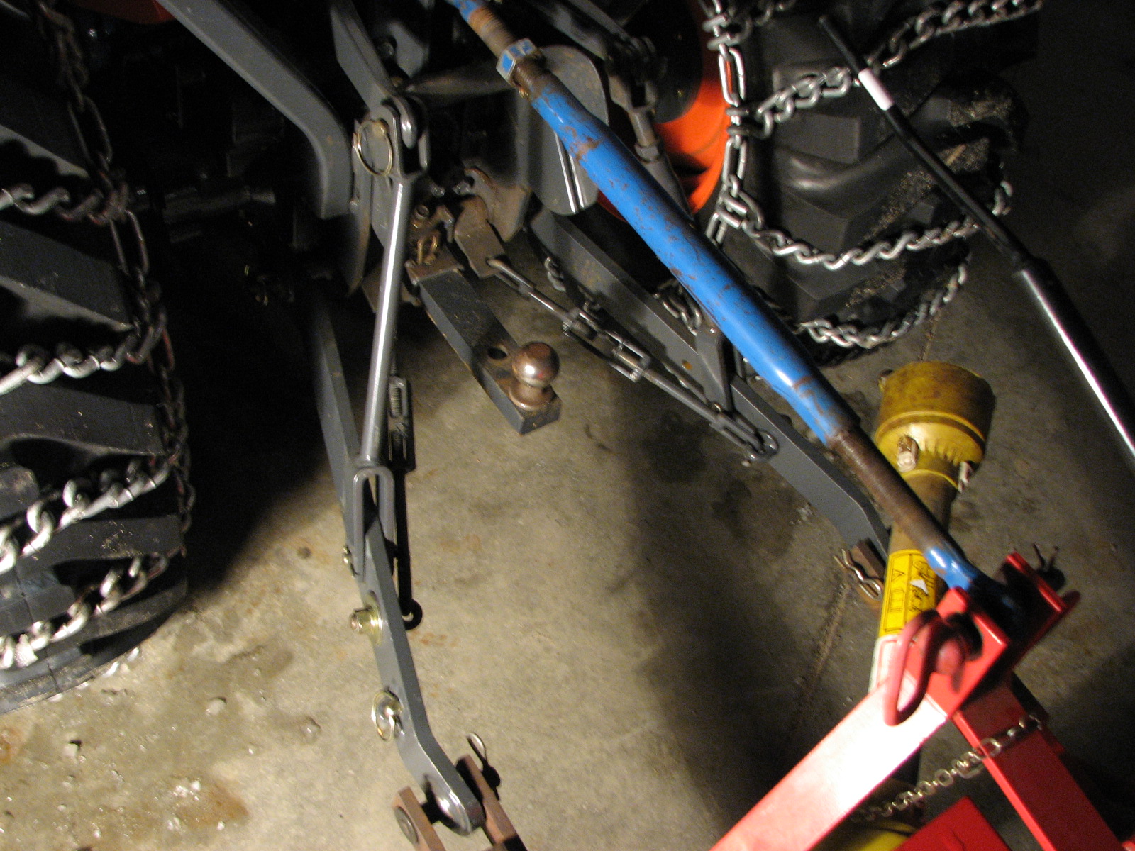

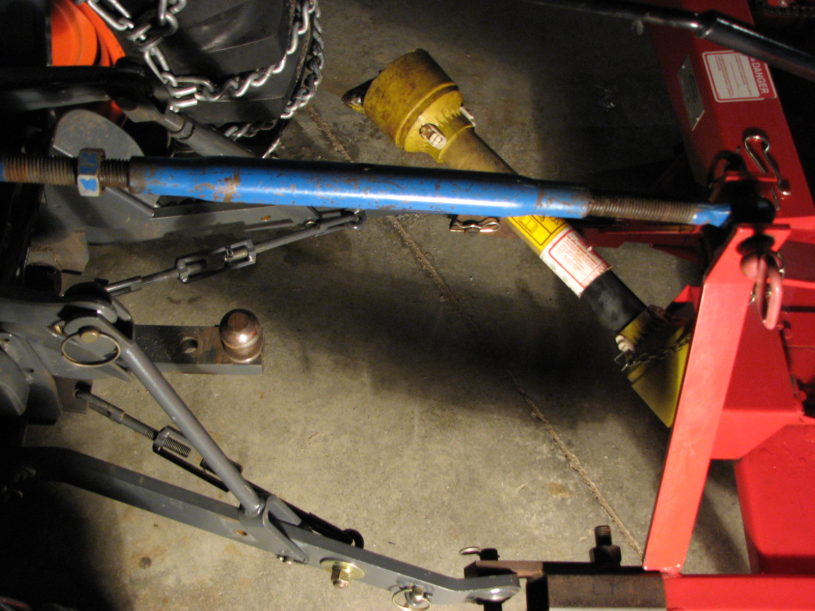

I think shine is talking about the stock drawbar that comes with any tractor I have ever seen. Nothing to do with the 3PTH. It is safe and simple. K.I.S.S. is best.
   / Ball Hitch for K B7800 #16
Shine is correct
This drawbar is stock on the B7800.
Drawbar is fully extended in these two pictures.
Please excuse the snowblower is still somewhat attached.
I disconnected one end of the the power take off drive shaft
for picture purposes.

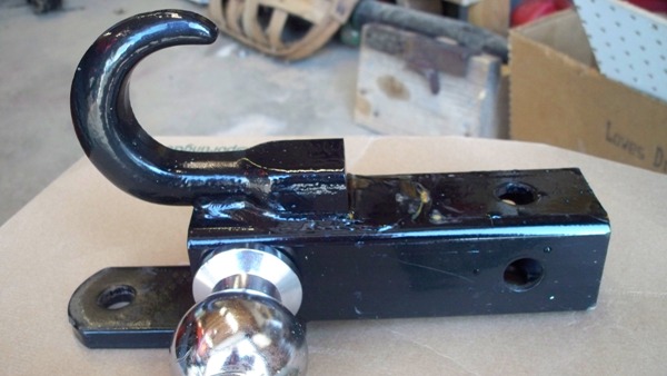

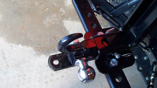

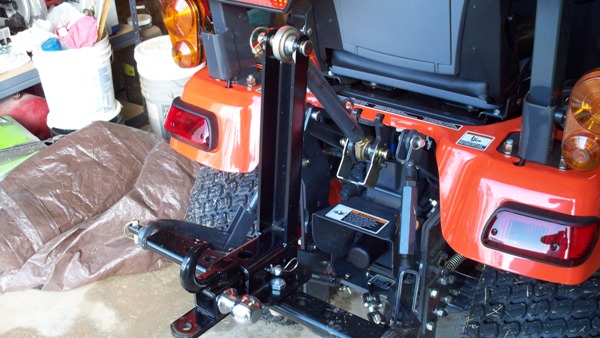

I purchased a Tractor Draw Bar Stabilizer for Category 1 Tractor from Northern Tool. It was on special for $59.99 and a ATV Hitch from Harbor Freight for $15.99. I already had the draw bar and 2" ball. I like the fact that it pulls everything from the center. I looked at a Handi Hitch but did not like the off center ball and clevis. I had to take a side grinder and cut off part of the hook base to get it to slide all the way into the receiver. I have used it to move my 21' bass boat with no problem. I tighten the links to keep it from swaying. All I have to do is back up lift the hitch and take off. I pull all my trailers, ball and pin and use the hook and a strap to pull brush. All I have to do is rotate the hitch for everything. It just stays on the tractor.
