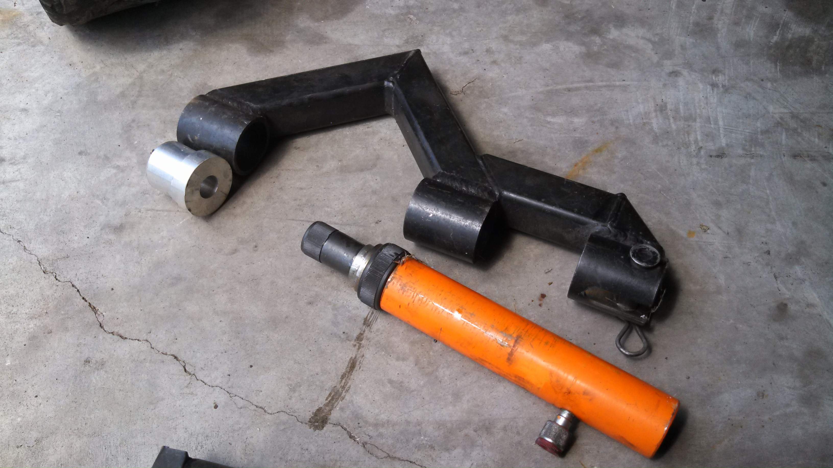

I had to make a "C" style to swap out a u-joint where the shaft could not be removed from the machine.
I used a 10 ton porta power ram instead of threaded rod.
The machined insert allows you to press out and in without having to turn it the other direction.
Not one of the things I use a lot but it works when nothing else will.
