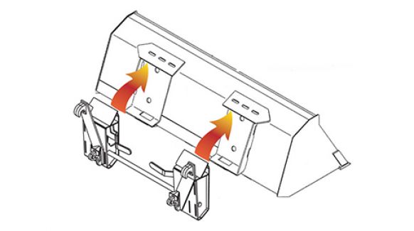

I think for the attachment mechanism, I would make something similar to half of a skid steer quick attach, like one of the two in this drawing.
But you may find that a single centered attachment may allow the rear barrel to swing side to side, as on a rough road, stressing the connection.

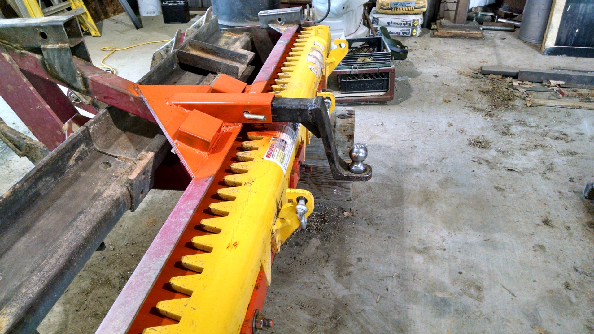

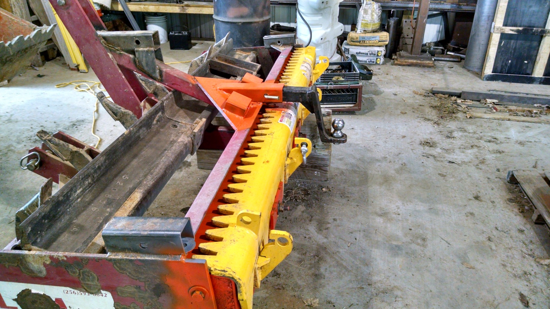

This would be the last thing I would worry about in making a rear 3ph ballast.
My first worry would be: Will my 3ph lift it?
My second worry is if the answer to #1 is Yes, then: Did I make it heavy enough?
I made a 55 gallon barrel/concrete ballast weight. I used it until I got my LMC 6' box blade. Never used the 55 gallon barrel ballast again.
So instead of making a single-use, worthless for anything else (other than carrying something), I would modify an existing and useful implement and add weight to that.
For example the aforementioned box blade: I added 6' of 140 lb RR rail to it (since removed) and a 410 concrete, steel and lead weight block to the rear. I then mounted the 110 lb Ratchet Rake onto that for a total of 520 lbs on the back end of my box blade. Not quite as compact as a 55 barrel but far more useful.
Pics:
IMG_20150409_140748593_HDR (Large).jpgIMG_20150409_140802465 (Large).jpgIMG_20150409_140826974_HDR (Large).jpgIMG_20150409_140833497_HDR (Large).jpg
