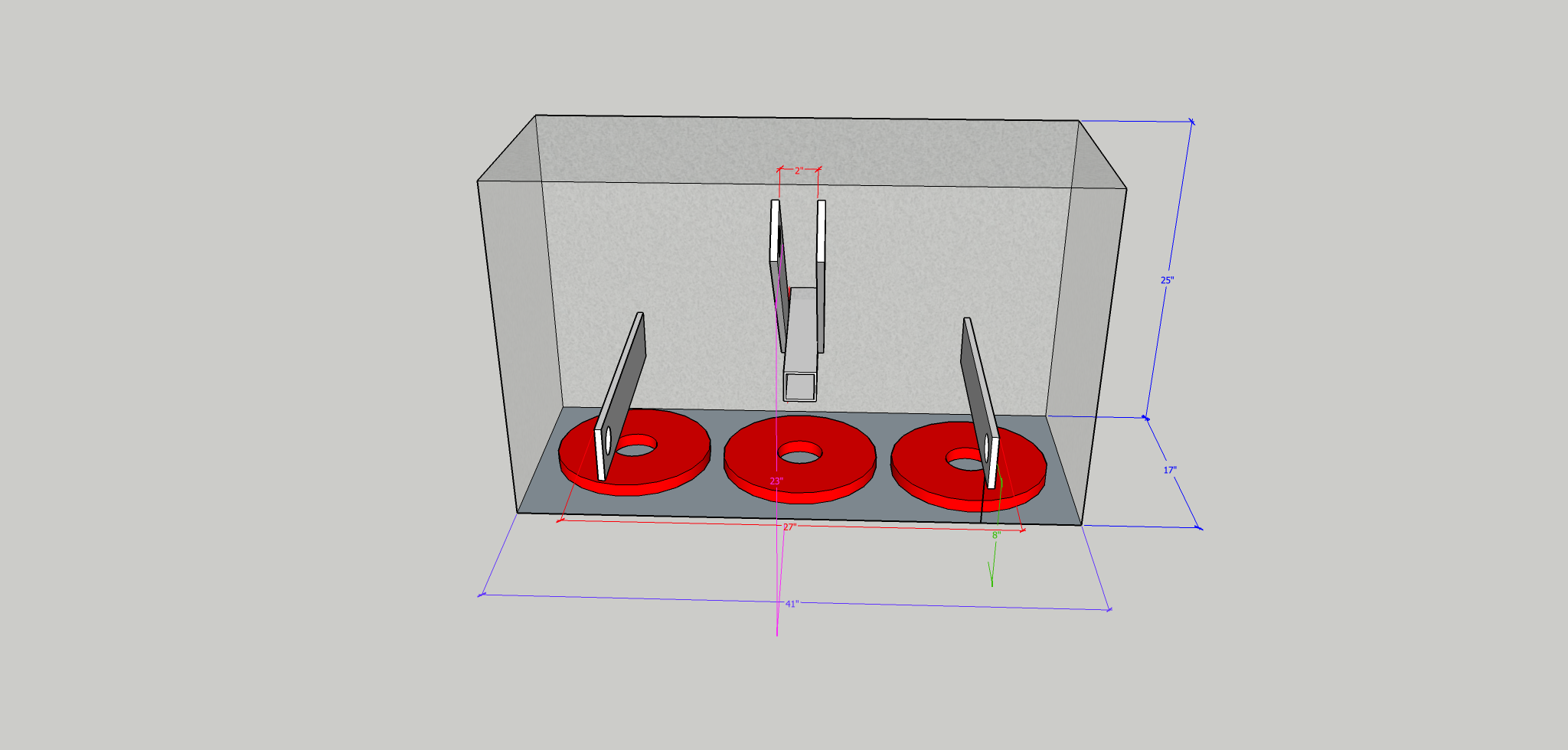

Or, line up a stack of the rotors and stuff a tube down the middle of them...
Aaron Z
Thanks, Aaron.

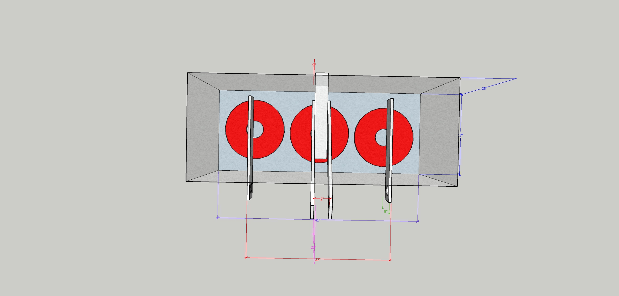

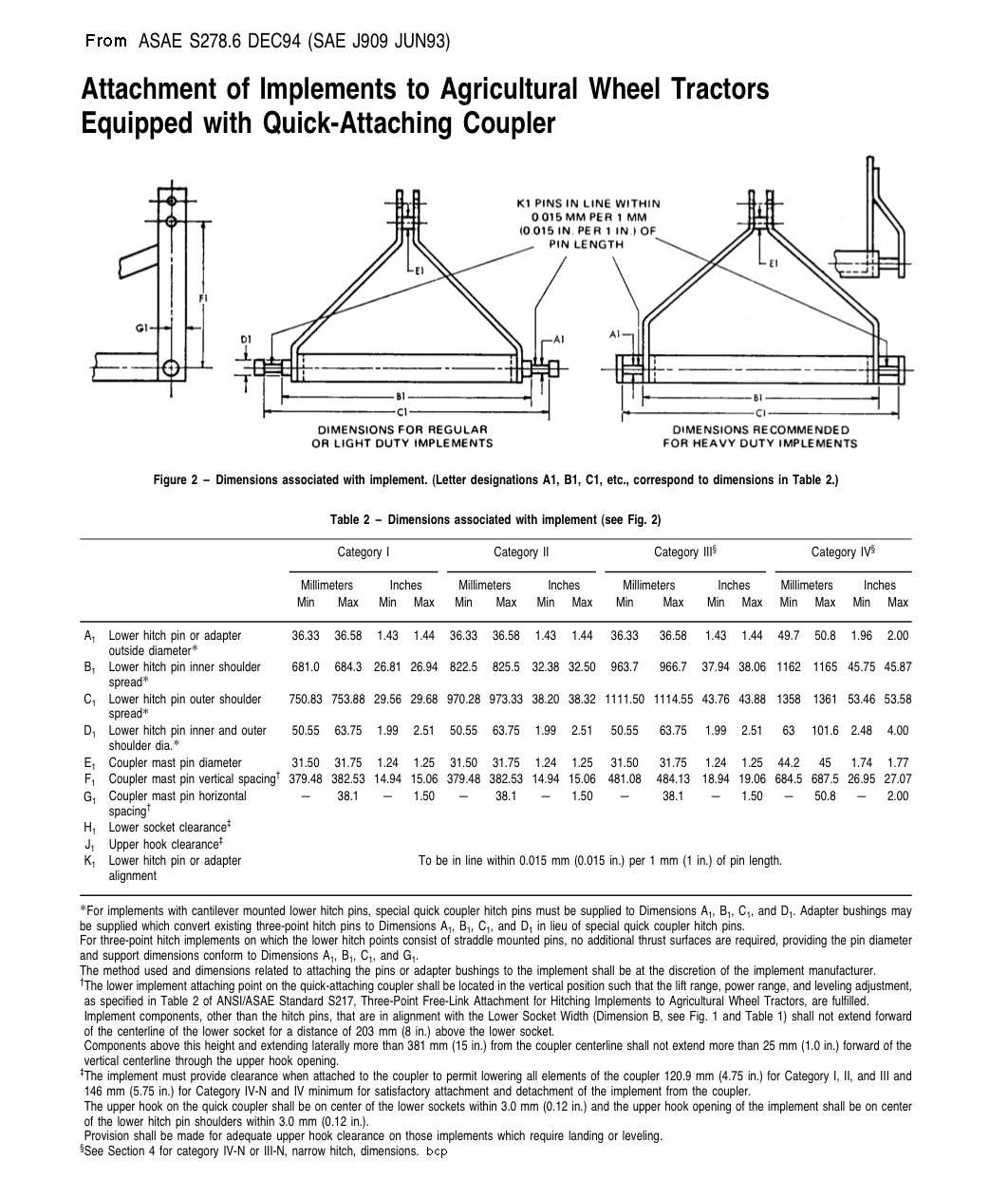

The block, in its current design, is 41"W x 17"D x 25"H. This allows for three stacks of rotors, as per the attached drawings. I can't fit in three full-height stacks because the bars inside the block would be in the way, but I can fit in quite a few.
I can't fit a tube through the centre rotors, because the upper link components will be in the way.
If I space the lower bars at CAT-1 (26") they will coincide with the holes in the rotors.
I could go to CAT-2 spread (32") which would allow the tubes to pass through the centres of the rotors. If the block is 41" wide, that would leave only 4.5" ((41-32) / 2) of concrete on the outside of the bars. Is that enough?
The rotors will take up a lot of the volume of the block, which means there is less concrete. I was thinking that the concrete in the rotor holes might be necessary for adequate strength of the block. Am I being too worried about the volume/strength of the concrete?

Gosh I'd think 4.5" would be more than enough. The volume taken up by the rotors might require some rebar gymnastics to tie everything together though.

Another option for me is to leave out some or all of the rotors.
According to my calculations, the anticipated weights are approximately 830kg/1,820lb with the rotors or 680kg/1,500lb using concrete only.
Perhaps, for the extra 300lbs, it is not worth the hassle of trying to fit in as many rotors as possible.
