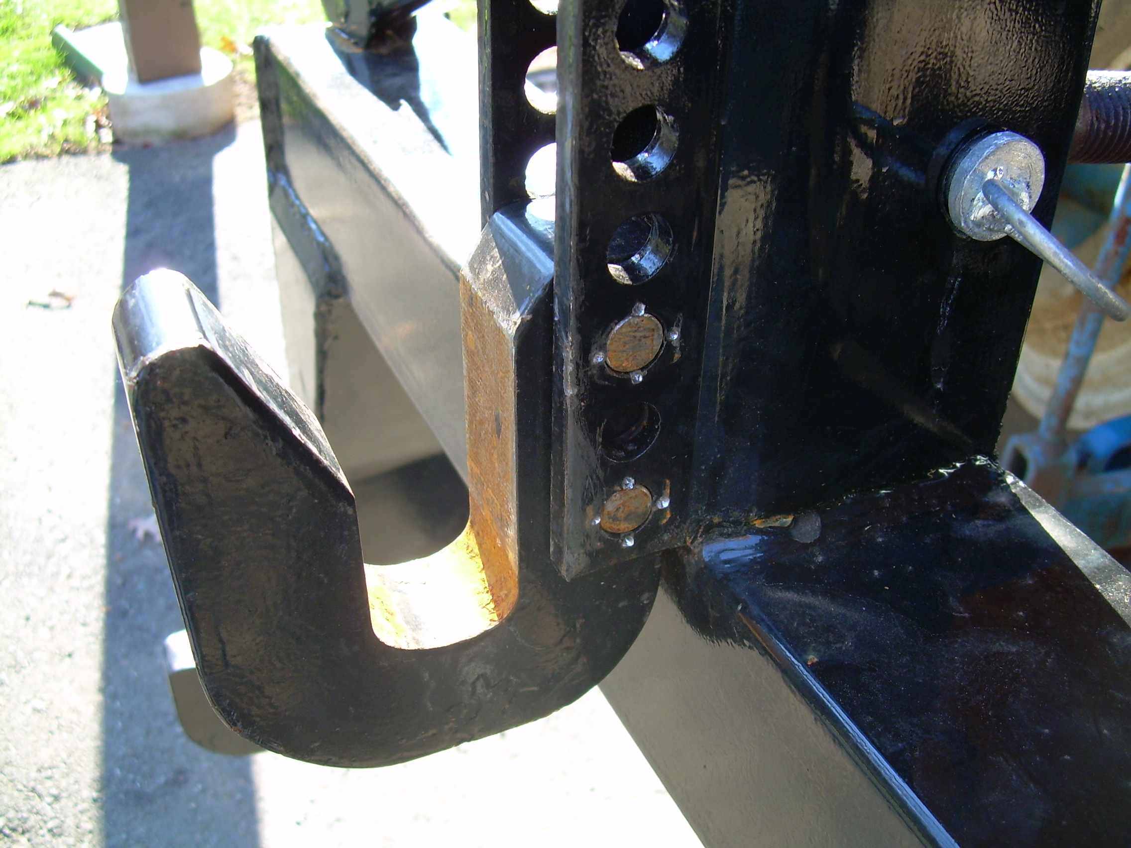

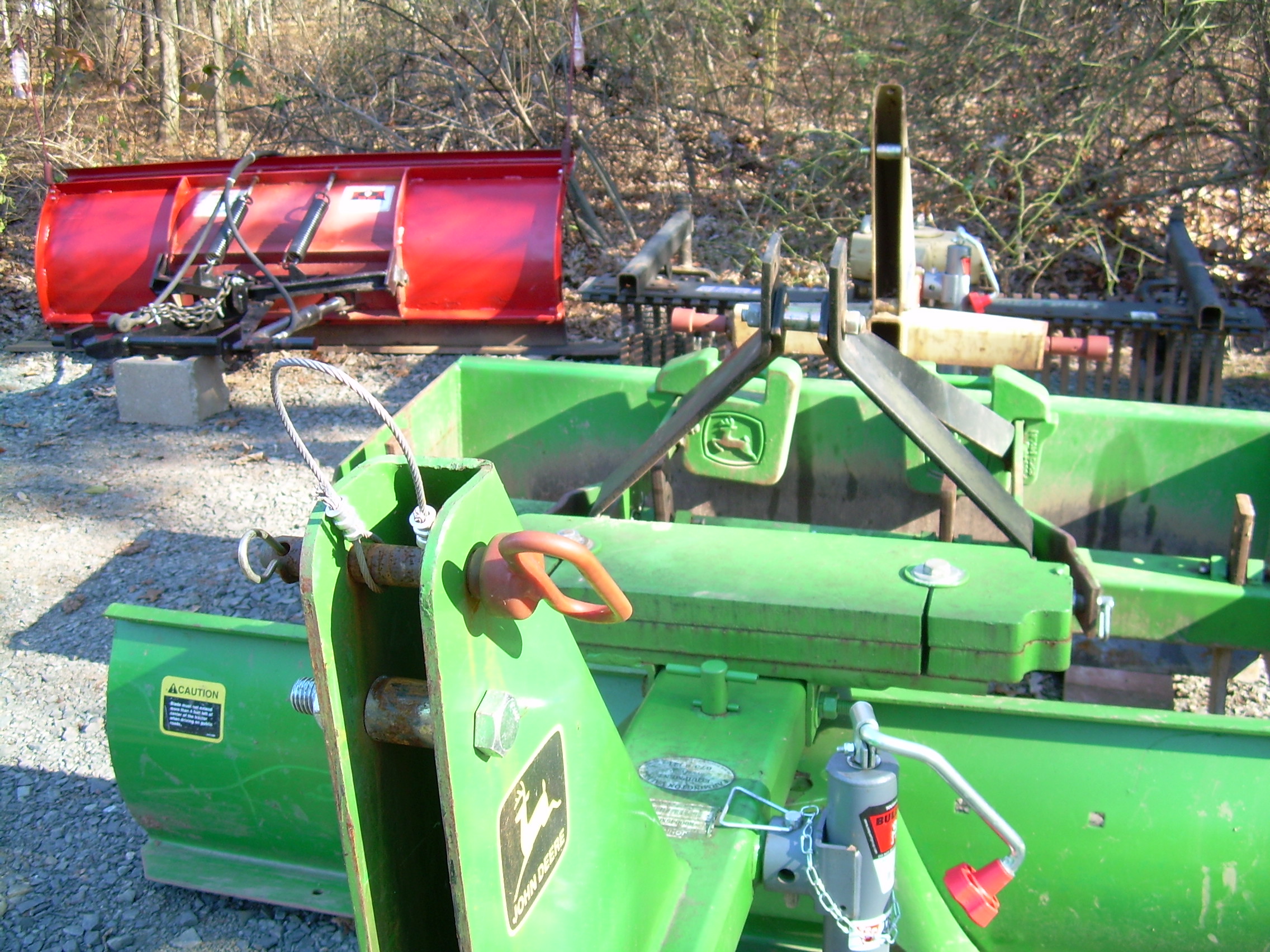

This is the problem I referred to about the adjustment bolts I had to remove because the got in the way on the blade and rake. they would not allow the upper j-hook to engage the upper pin as the bolts obviously wouldn't fit in that channel where the upper pin is.
I was surprised as aren't many implements designed the same way with the mounting of the upper pins in a channel type frame?
JB.

I made an adapter for my KK Carry all- so that I can use my I Match. From what I have learned - by error and not by research here- is that the top hook on the I Match is 15" from the center on the lower pins ( this is ASAE standard)
It appears that some manufactures including KK do not always comform with this standard. I have heard this standard was self imposed by JD -I cant confirm this- interesting never the less.
