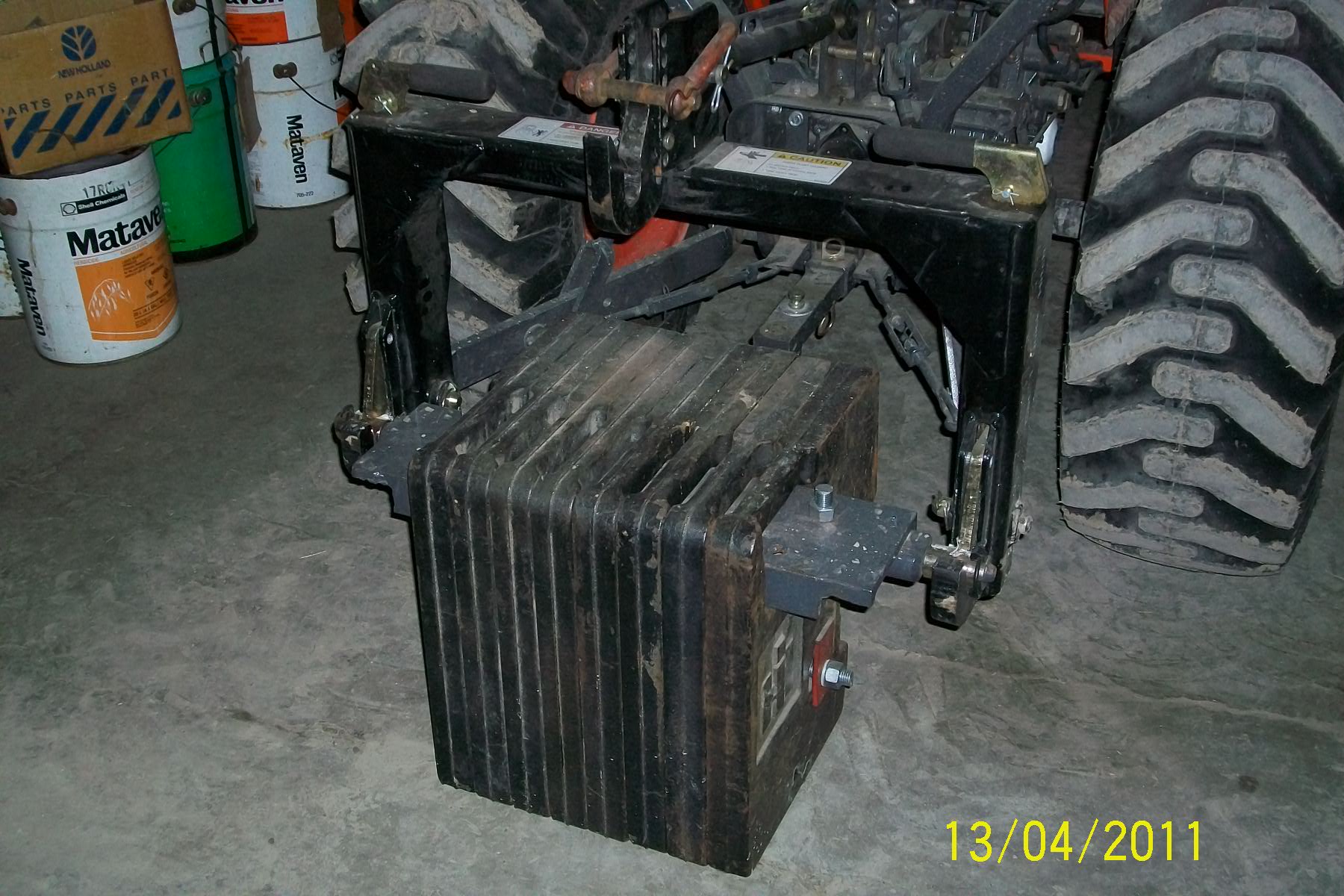

   / Ballast box on B3200 #7
This is what I use.
