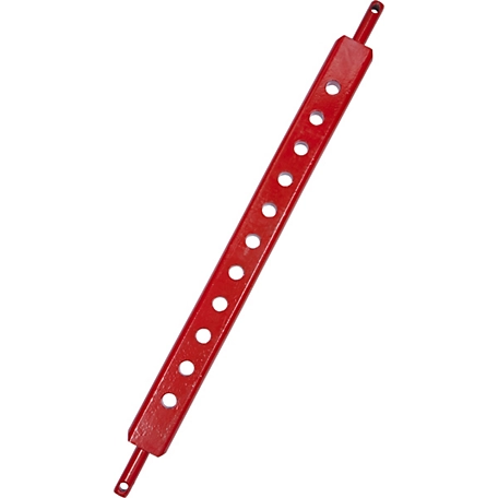

Not really answering the OP's question, but when I need ballast I'll use a drawbar like you pictured and hang a bunch of old brake rotors on it. Maybe wrap a chain around them to keep 'em from shifting. You can fit quite a few on there.
I knew there was some reason that I was hanging on to all those old brake rotors . . . Great idea! Thanks!!

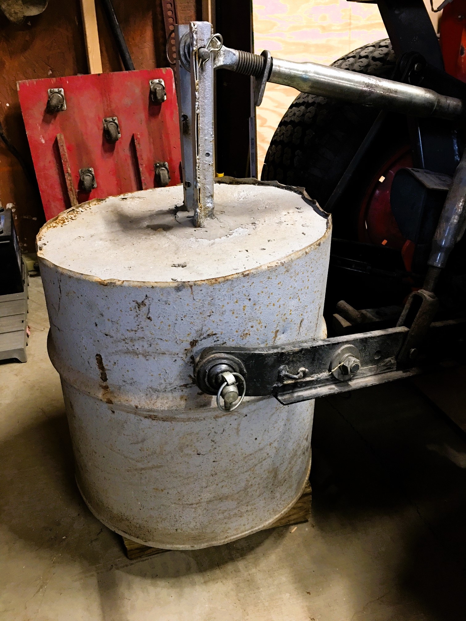

   / Ballast box opinions #20
Photo of my ballast "box". 30 Gal. barrel with the top 1/3 cut off. Drilled and bolted lift pins on the side, then put angle iron across the center and welded to the pins on inside, angle iron from bottom to top link attachment, welded to the cross piece. I then welded several cross pieces of angle iron to the vertical bars for support, and filled with concrete. It cost me the price of the two pins and six bags of concrete. Been using this for about tens years now. You can make about any size or weight you want, a friend cut up an old boiler to make a much larger box for his tractor.
