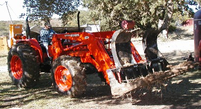

Partsman2, I also run a rather large tractor for this site Kubota M9000 and also have a BTR grapple that weighs in around a 1000lbs and even after urethane filling all 4 tires which added around 3000lbs and carrying my 1000+lb woods BB on the back the grapple is still capable of lifting the rear wheels off the ground, point is I've got only a couple of hundred hours but listen to the clinch factor carefully and if its to big take smaller bites luckily the grapple is always low picking up when I discover I've got to big a bite but when the rears come up its a little dicey especially in my case where I was trying to move and lift it just cranks you right up till the grapple hits the ground now I grab, pickup then move.
Steve
