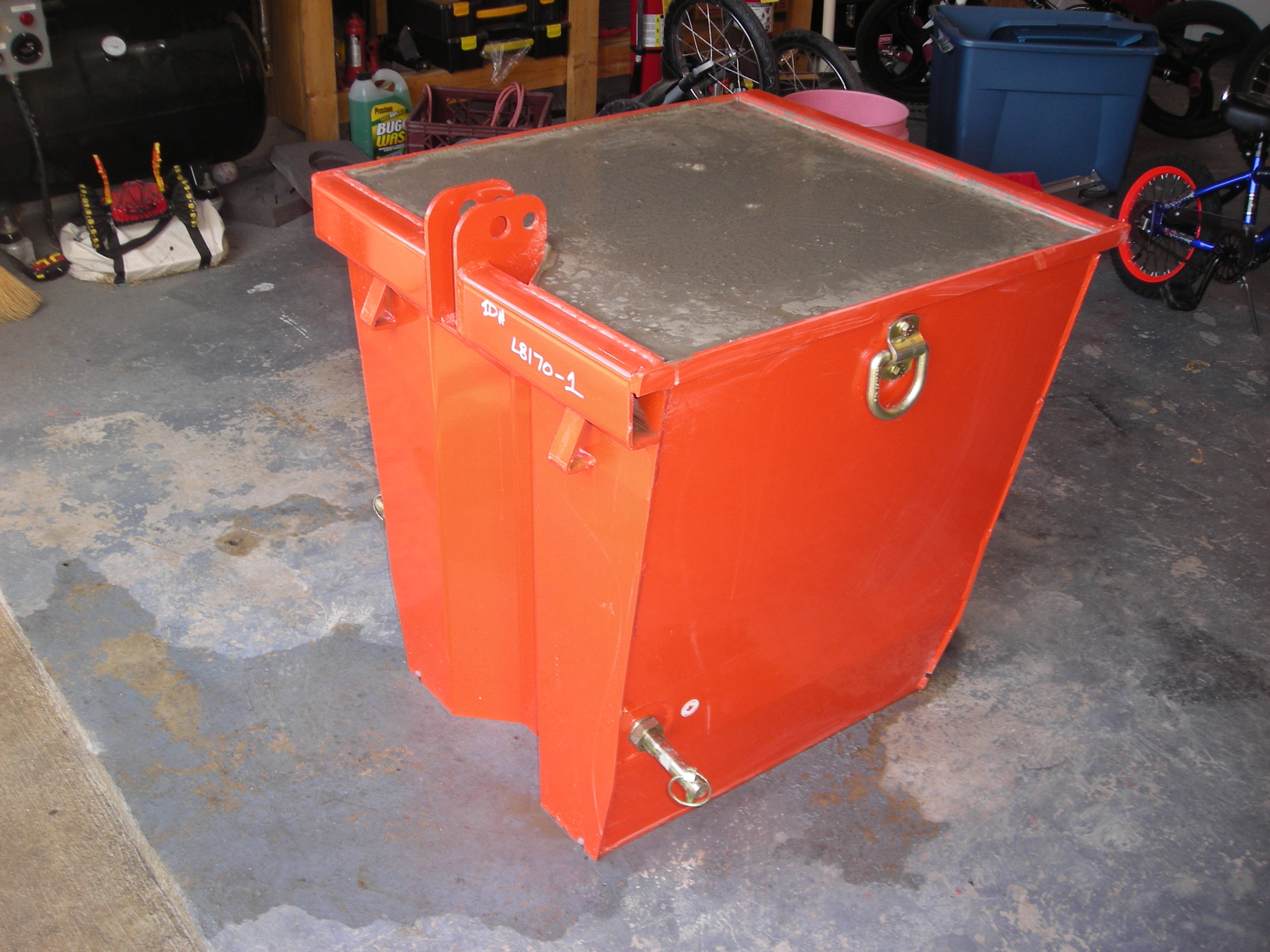

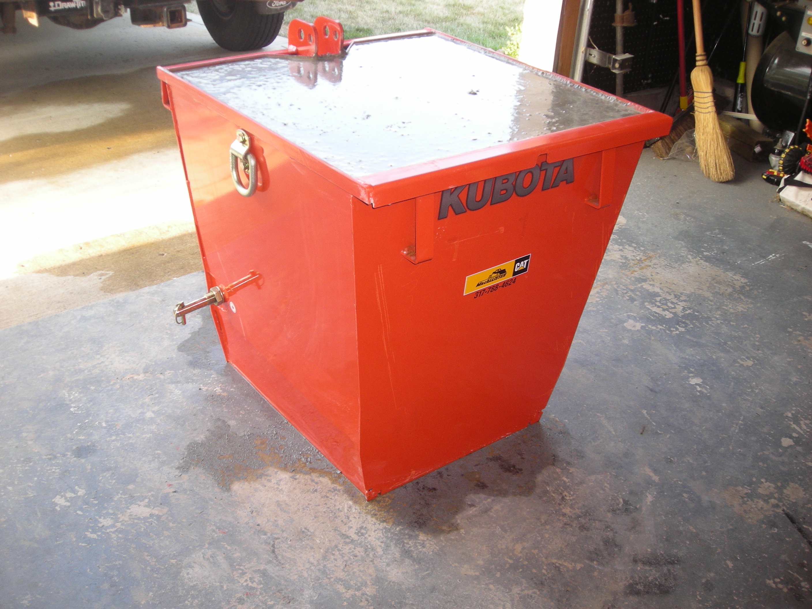

Filled mine with concrete today. Eighteen 60 pound bags. Once it dries, will silicone edges, then paint top Kubota orange. Philip.
That is funny, I just got done filling mine with concrete about 30 minutes ago. Mine took 20 80# bags. No pics.. had to get cleaned up and start the grill for dinner.
