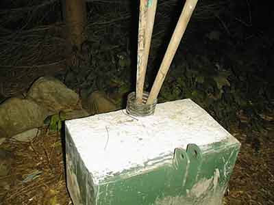

Here's my JD weight box, filled with cement with 3 shovels in the PVC pipe. It is covered with mud from being dragged low during some precarious manuevering. I can see how the legs would be a hassle. I often scape the ground with this one but it is smooth on the bottom.
I weighs around 500lbs seems perfect for my tractor.
