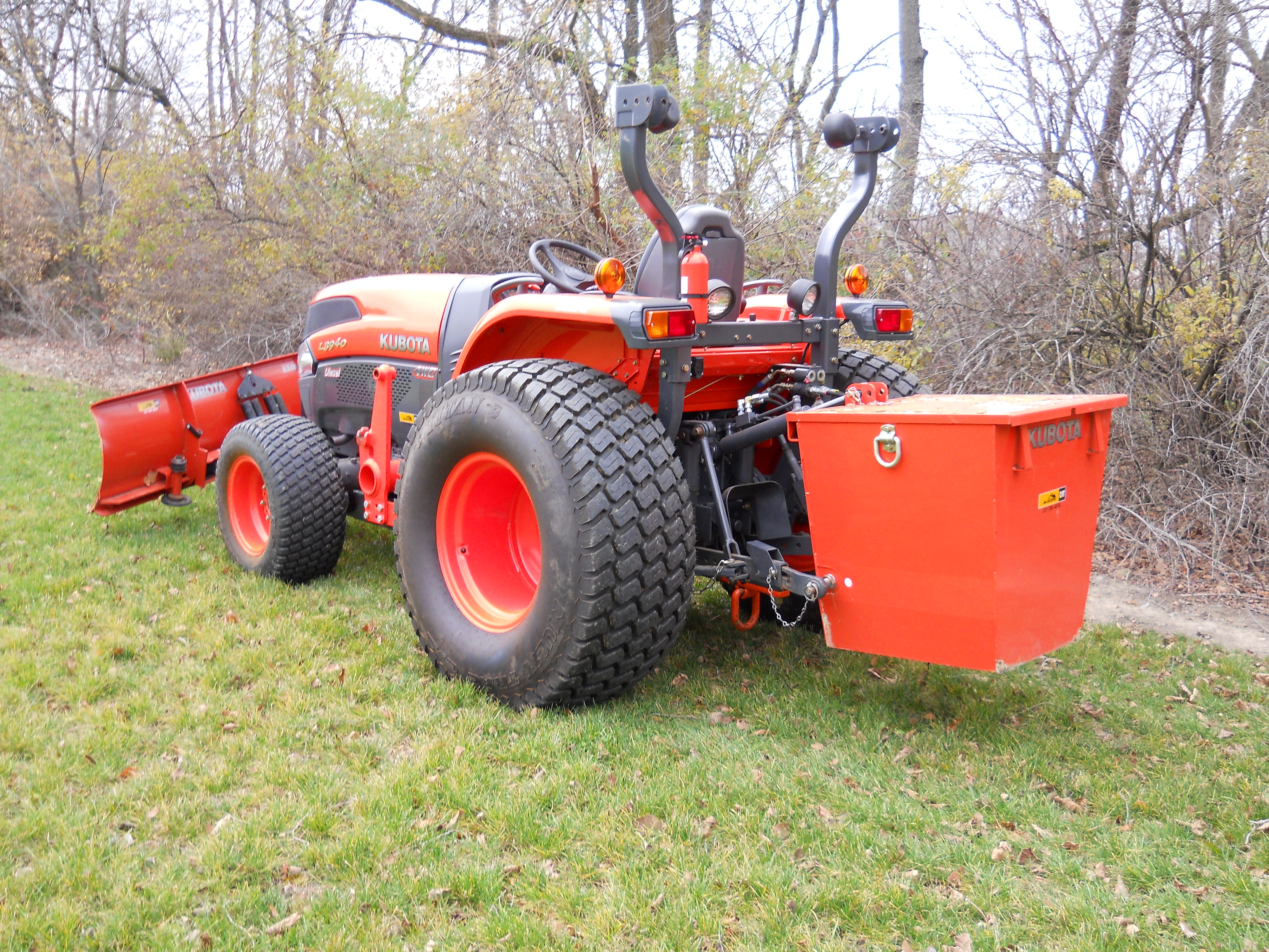

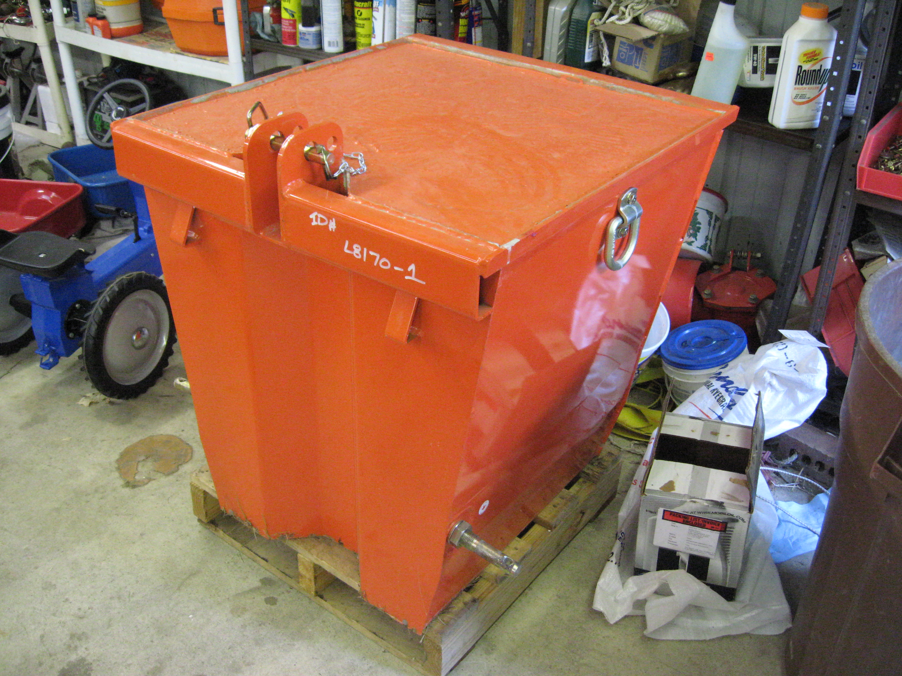

1250#, as filled with concrete. I like the compact size, easy to maneuver, not too difficult to attach. Philip.

/ Ballast Box Question #19
As an aside, one might think twice before filling the ballast box with concrete, because it is impossible to move after detached from the tractor.
Thus, depending on each one's situation, an empty BB is more user friendly when off the tractor. Having a QH makes a big difference. On BX size tractors, the empty BB doesn't need that much added to be effective. Any ole heavy junk will do. The nice thing about a BX BB is that it is up close and allows for usage in confined areas.............at least that was my experience when owning a BX Kubota.
Now with the FEL up in the air, that's the OP's original question. That's already been discussed.
