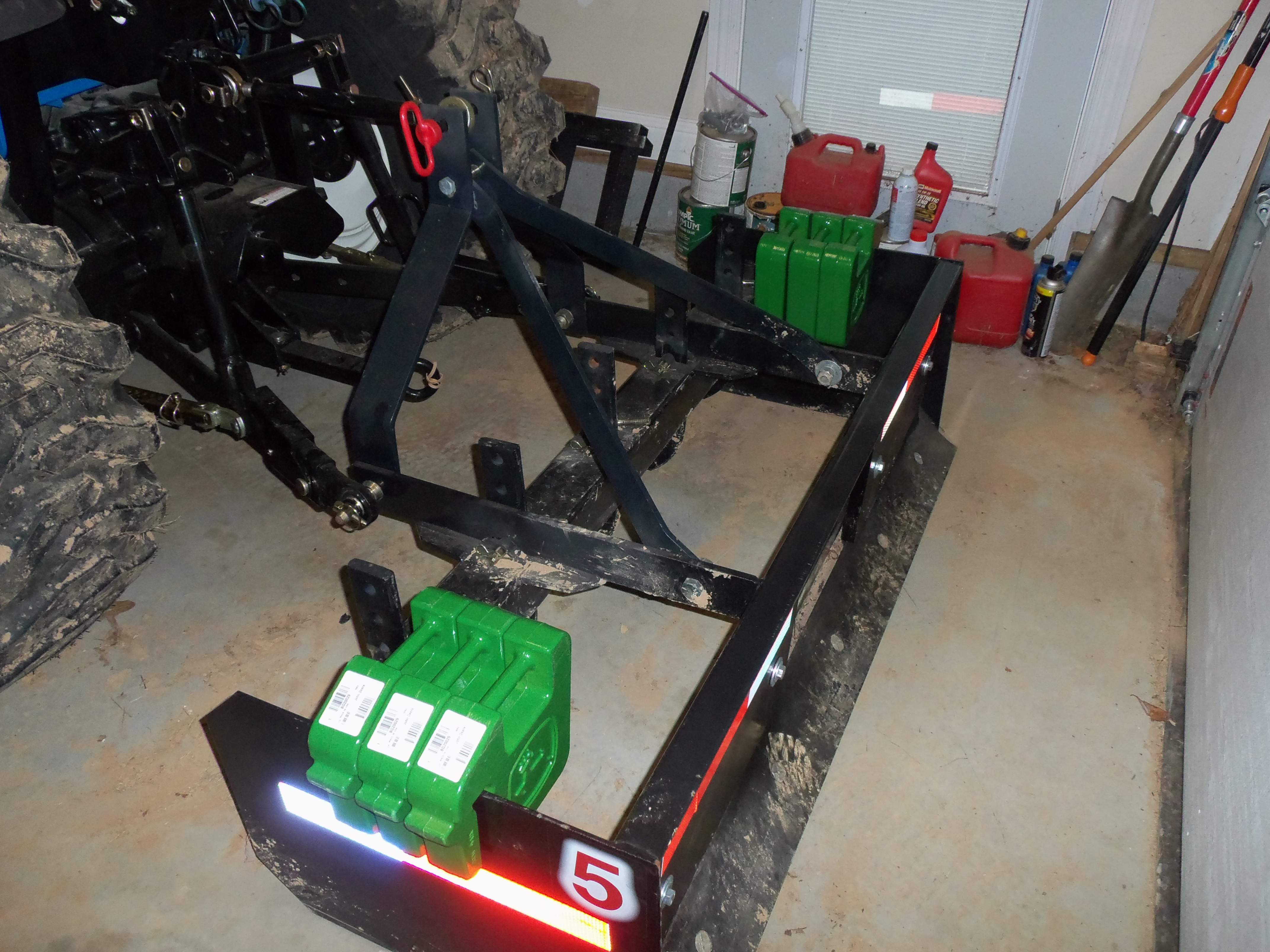

I carry about 10 suitcase weights on my box blade as illustrated above. Have done this for some time....but added a few more this year. I've got mine on a King Kutter box blade. Never had one bounce off yet....and I cover some pretty rough ground. The extra weight and fluid in my tires keep the rear end safely on the ground.

Anyway.....here is what my BB looks like with 12 suitcase weights hanging on it. With this weight and my loaded tires....the rears stay on the ground.

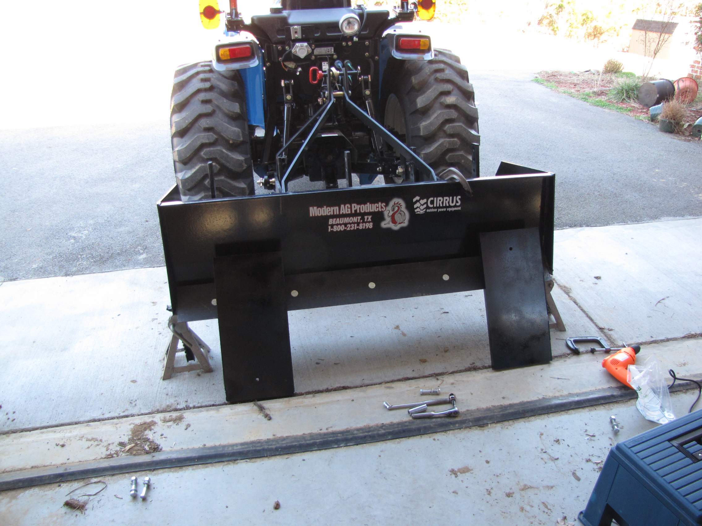

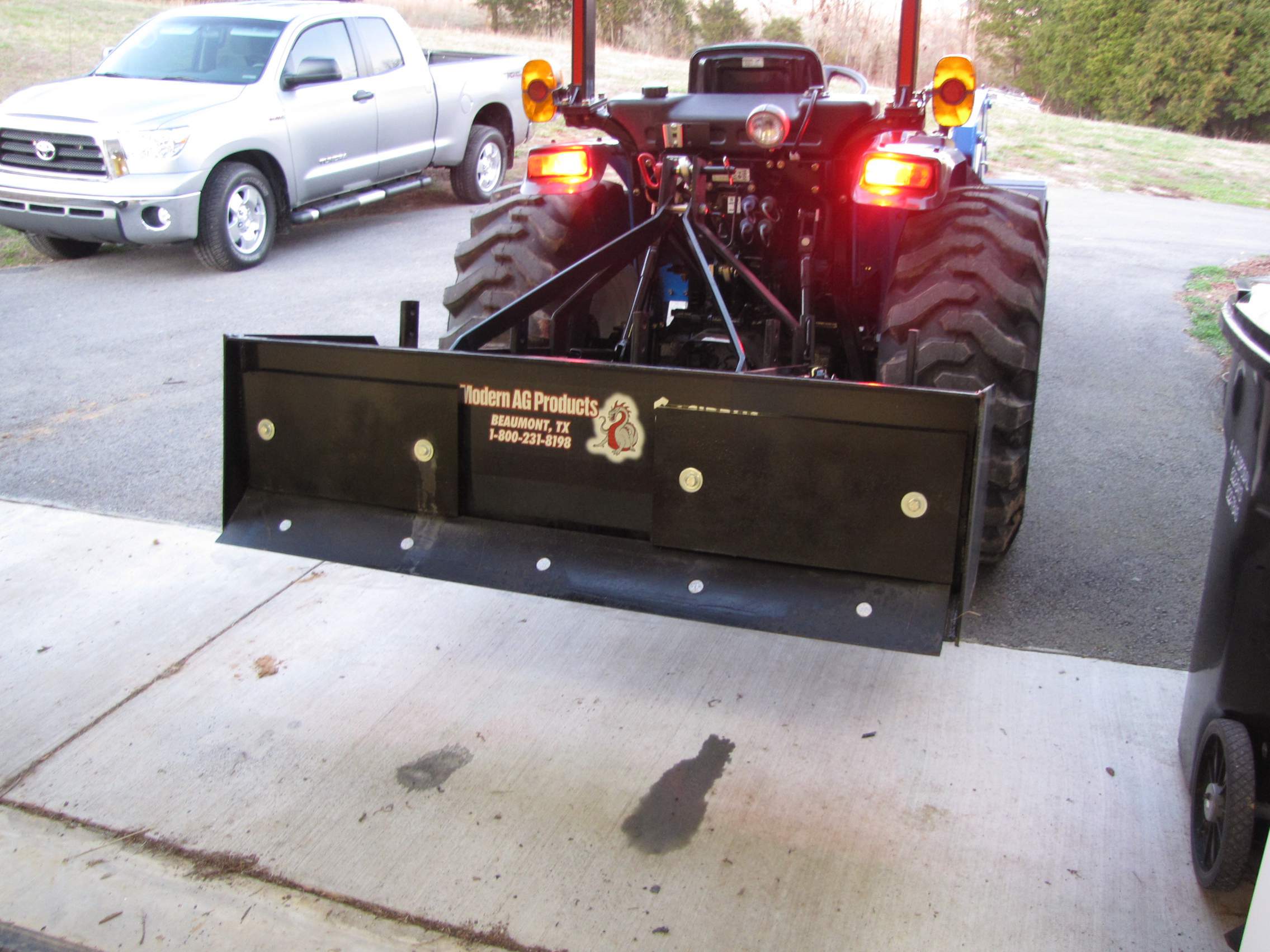

DSCF1292.jpgI built this ballast box a couple of months ago to ride atop my Modern Mfg 6 ft box blade. The box blade weighs 700 lbs, and with the added ballast box, brings total weight up to the recommended 1000 lbs for my Kubota Mx5100. Works well as it is easily installed and removed with my FEL. Good luck
