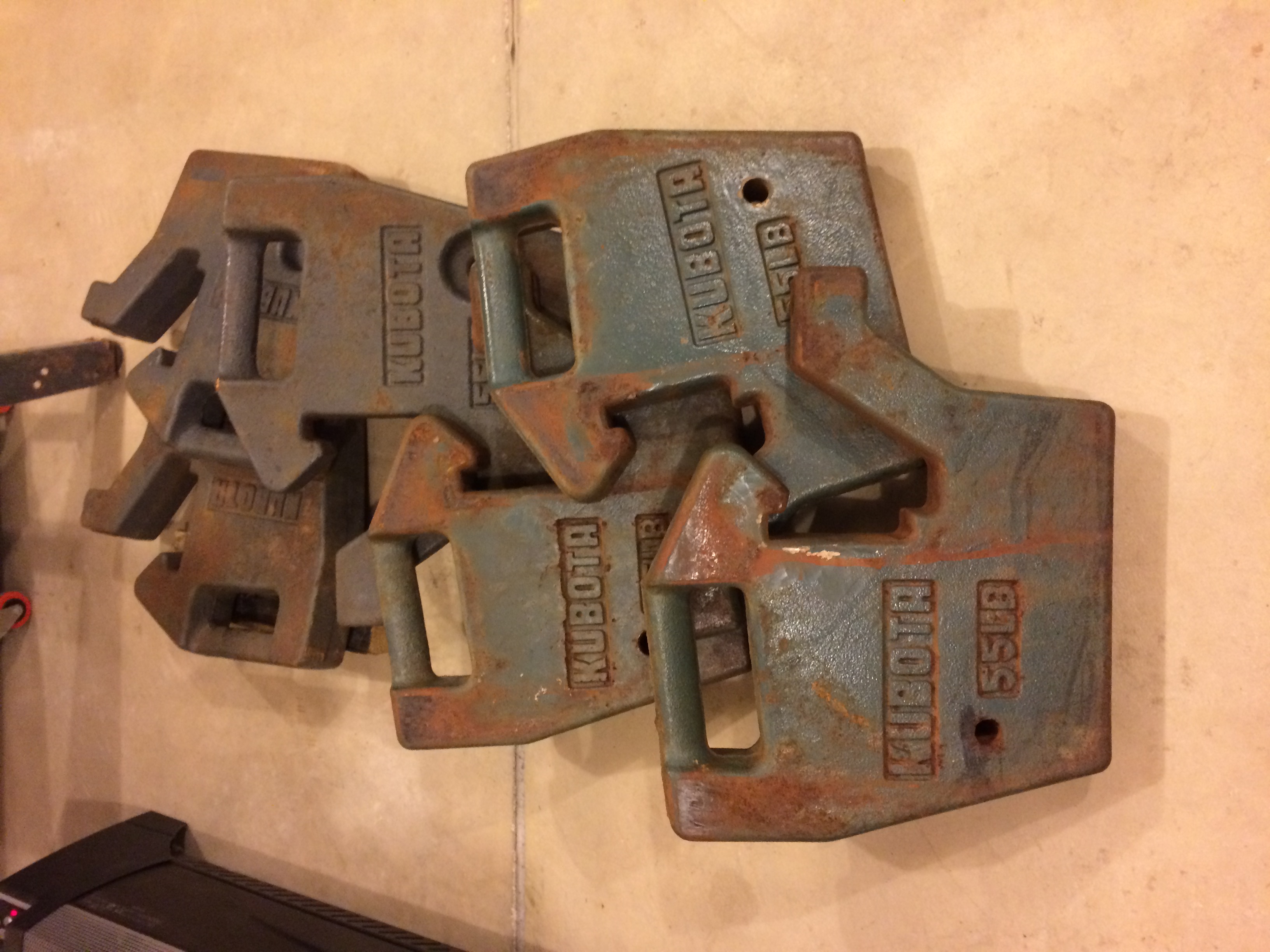

Robert if craigslist has none then local dealer. Some charge full boat retail for the weights, some will discount a bit. The big savings on buying from the dealer is no shipping, they bring them in with larger shipments. If you order online the shipping gets ridiculous due to the weight.
I just finished waxing the cart and hitch, about to load the hitch onto the cart and add the weights, pic in a bit fully assembled.

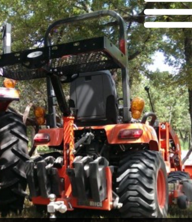

   / Ballast Box vs Suitcase Weights - HeavyHitch Inbound! #68
Thanks Death. Great write-up. Just what I figured... down to the flexing of the setup on the cart. Thank you. Now, to sell my ballast box.
Oh, last picture request... I think...
Hitch with weights on QH10.
#69
I have to spray some weed DEATH today then I'll install the QH10 with hitch and weights and post a pic.
