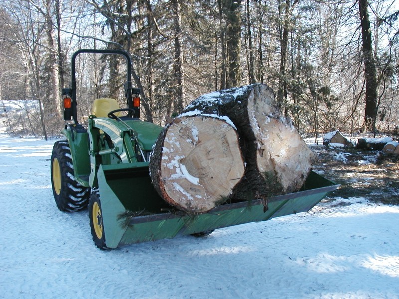

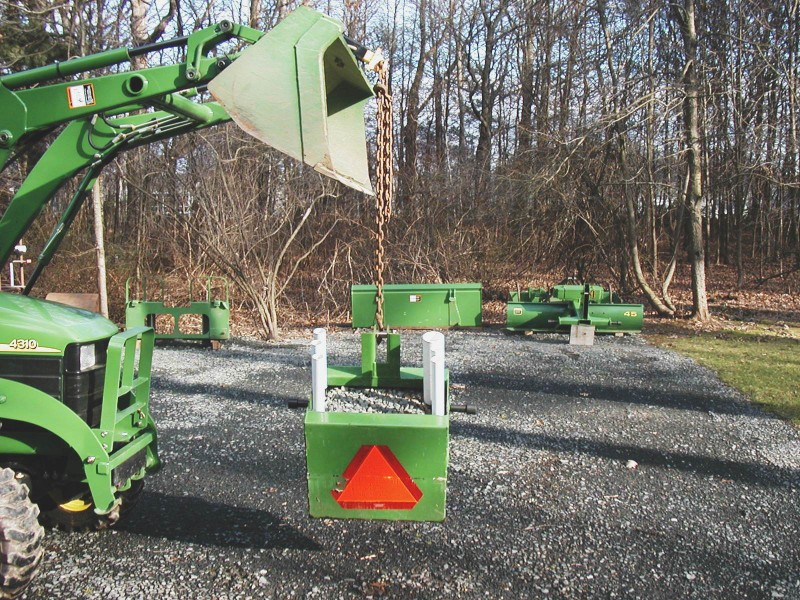

I didn't want to fill mine with concrete at first but now I will, since I filled it with 3/4 crushed stone and did the pvc pipe thing, I haven't needed to empty the box and moving is not a problem, so the extra weight will help and it will keep the pipes from shifting around, I will use one 4", one 3", two 2'' and two 1-1/2", the 1-1/2" works fine for most yard tools, the 3" works for hand held blowers and I think the 4" will fit a small chain saw. of course I got the idea for the pvc pipe on this site, great idea, some times working around the yard I have all the pipes filled with tools.
A couple of pictures here, the one with the trunk section of white pine needed more ballast to be safe, that's a 6 foot bucket.
