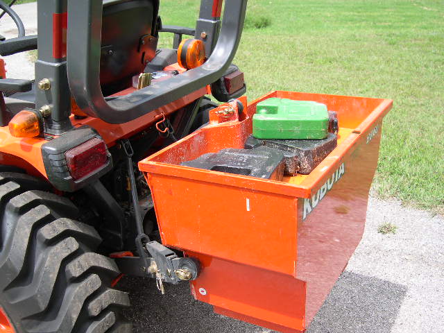

have new b8160 bota ballast box. was looking at what to fill it with. seems like the object is heavy and cheap. i went to an automotive machine shop and dug thru their scrap. seems to be an abundance of busted 350 chevy heads free to good home. they're about 18" long and are a good fit. i put 5 in and filled the end space with brake rotors from the same pile. i then poured 3 bags of concrete over the top. i left the top 4" or so open as a shelf to carry chainsaw or misc. i also have 4 suitcase weights that fit on this shelf if i need a little more weight. 10 bucks total expense.
