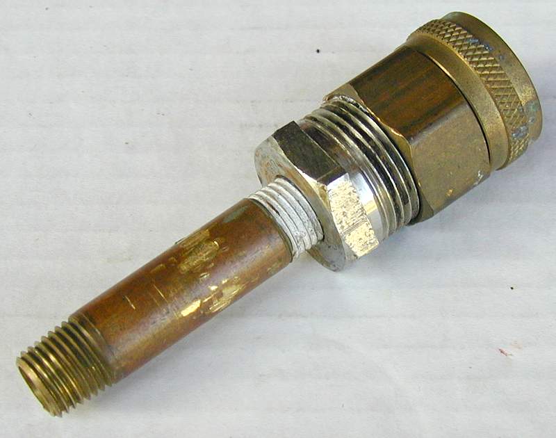

</font><font color="blue" class="small">( In my area we rarely get below freezing, is this something I can do myself with just water and a specific nozzle for my garden hose? Comments/Suggestions? -MVVineyard )</font>
Similar climate here. I have tube-type tires so I didn't worry about corrosion. I made an adapter from garden hose to tire chuck (attached). Then jacked each tire a half inch off the ground, turned the faucet on low, and stopped to bleed air a couple of times per side. This isn't rocket science.
One tip, remove the valve cores. I didn't, and had to replace them to restore the tight seal.
We see temperatures in the mid 20's maybe once per 20 years. Neighboring farmers advised that none of them use antifreeze in loaded tires. I suggest make local inquiries to see if you need antifreeze.
